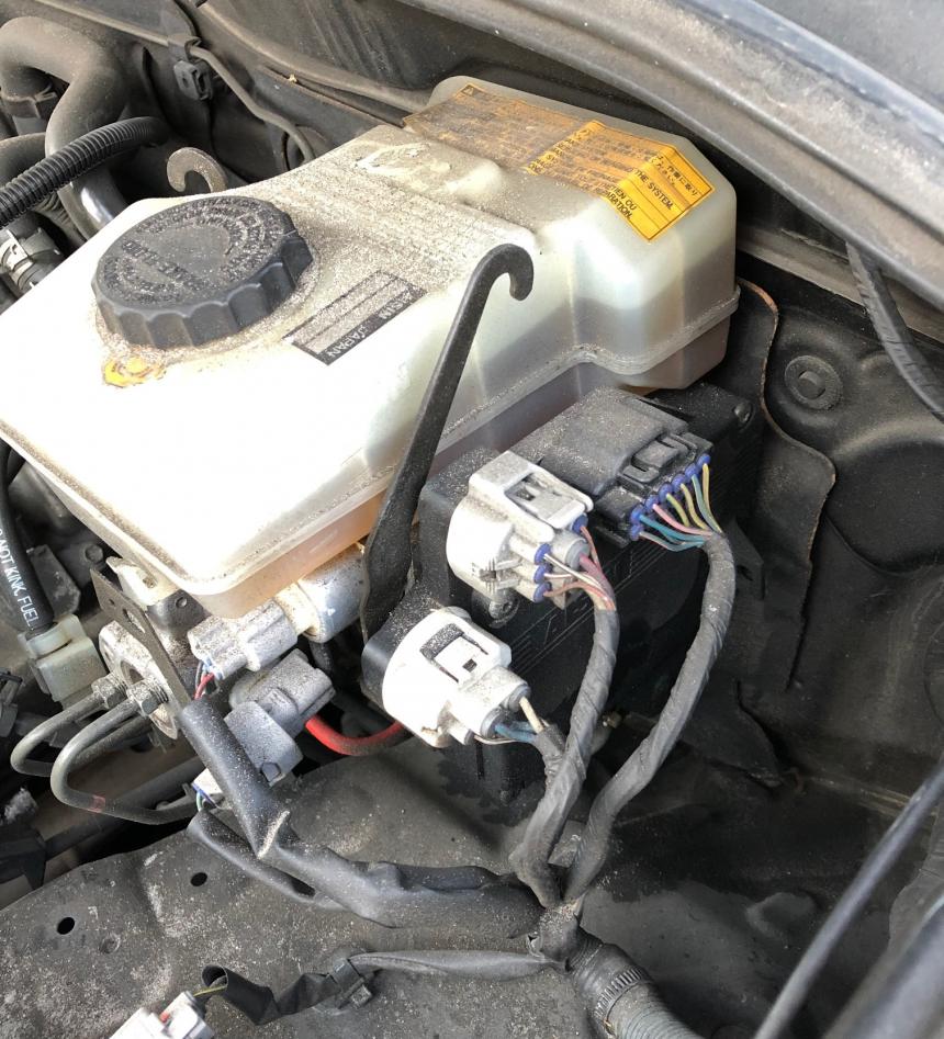

I just took a look to see about replacing the motor WITHOUT removing the whole assembly, disconnecting the brake lines etc., like JURONIN mentioned.
I don't see how you could possibly reach both screws holding the motor with it still attached to the vehicle??

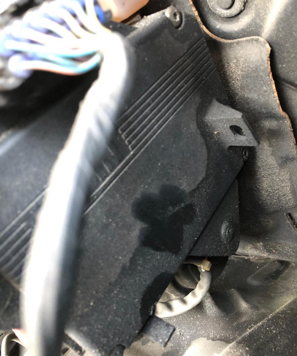

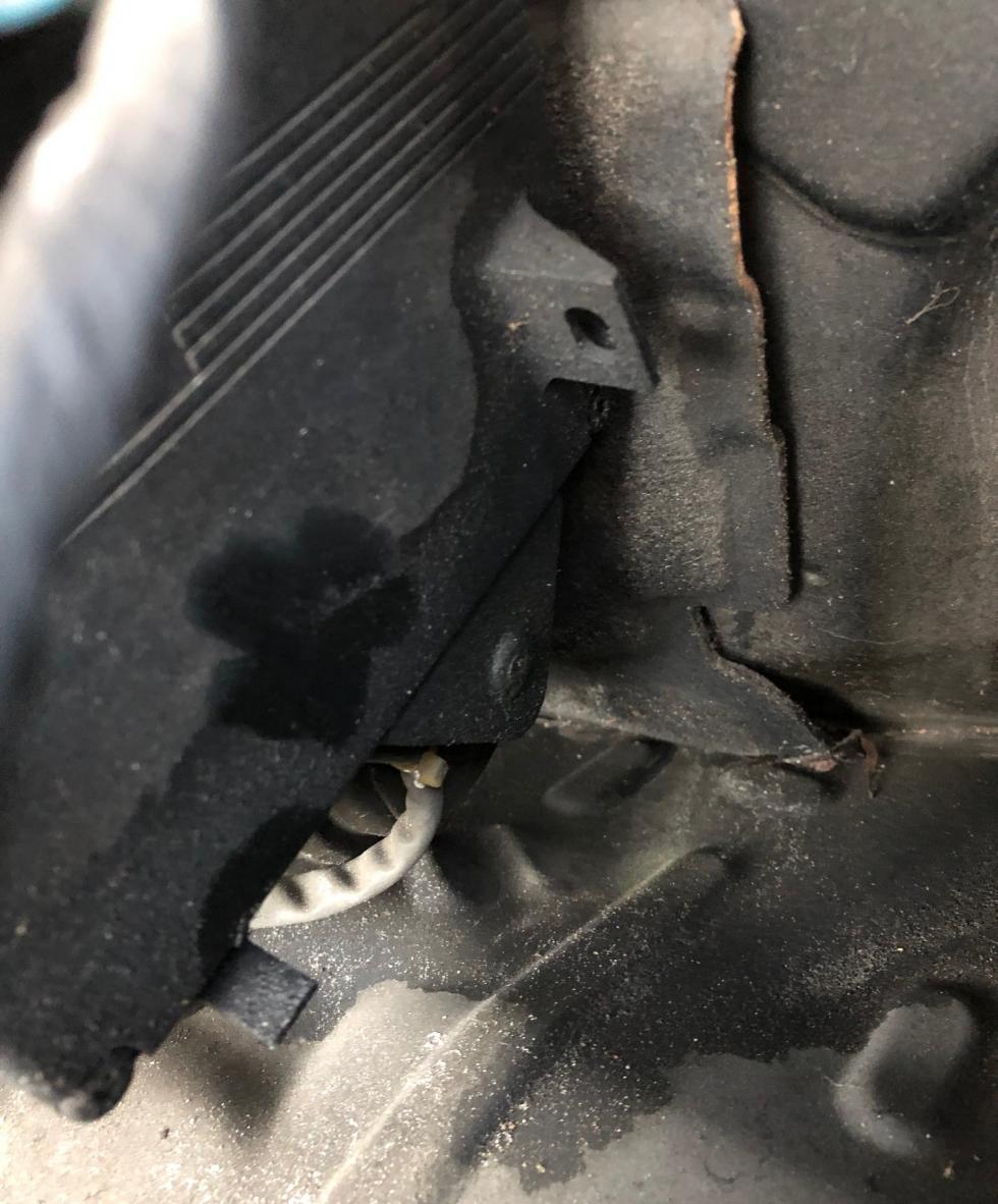

..... BUT I noticed signs of a leak, please see pics.
The leak appears to be on the OPPOSITE SIDE of the accumulator, around the bottom of the black box.
So, now I am stuck again because I don't know what is leaking/what other part(s) I need.
Any ideas?
(Also thanks for the heads up on the fuse! Will keep that in mind).

So, I checked the fuse, swapped it with another 40, and the motor still did not run.
I think it's fair to assume that leaking fluid got to the motor/connector and caused the motor to go out... Sooo changing just the motor is no longer an option...
At this point I think I am down to 3 choices:
1. change the accumulator o-ring + the motor.
2. change the accumulator + o-ring + the motor.
3. find a reman, or new unit, and replace the whole thing.
(if I get a $600 used one on eBay, I'm not confident that it won't have the same issues down the road).
I was unable to remove the motor with the unit still attached to the vehicle.
I was also unable to remove the master cylinder assembly from the vehicle, I know its 4 bolts underneath the steering wheel holding it to the fire wall, but I cannot reach all 4 bolts (i can only even see 3/4).
Does anyone have instructions/advise on how to remove it?
Last, does anyone have instructions/advise on removing and replacing the accumulator/o-rings? Not sure if that is the source of the leak since it seems to be coming from the bottom of the black box that says AISIN, any thoughts?

Having just have the same issue as you described, up to the same spot as leaking I can hopefully offer some advise.
On the nut, the 4th nut is hard to get to, the top left nut. I had to use a swivel connector with a rachet. that was the easiest way to get it out.
I will be replacing the following items for this job:
1. abs pump Motor
2. Accumulator
3. MC piston kit.
To same money, for the pump motor # 1, I'm sending the unit to Eurton Electric for a rewind/rebuilt for around 265.
For the new OEM Accumulator(200 ish) and the OEM MC Piston kit(60ish), you can buy OEM from eBay. you save some money by buying them from United Emirates and shipping seems as fast as in the states. I ordered them on Sat and delivery is Wednesday.
I am hoping that this will fix my issue.
