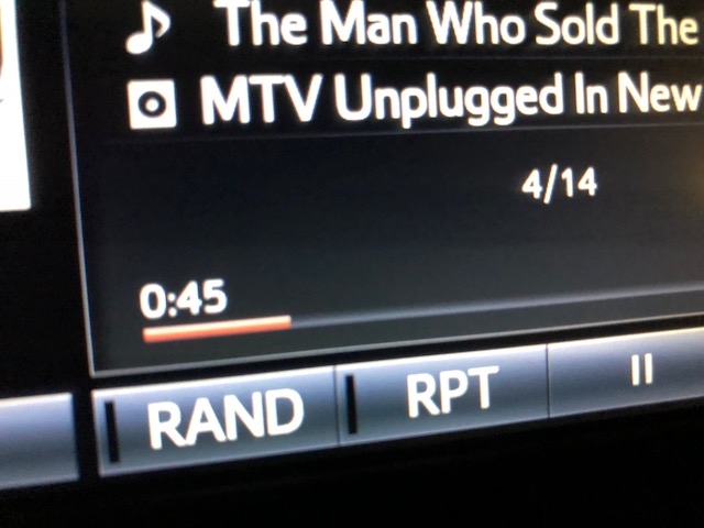

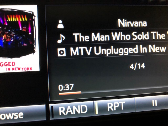

There is a RPT on the screen, if repeat is selected there is a bar next to RPT. Touch the RPT is turn off repeat. If that does not work try the reset located in the menu somewhere.

I have music in the USB drive that I loaded into my computer from various sources.It works fine on 2 other cars and several mp3 players.
Definitely not the "repeat".
