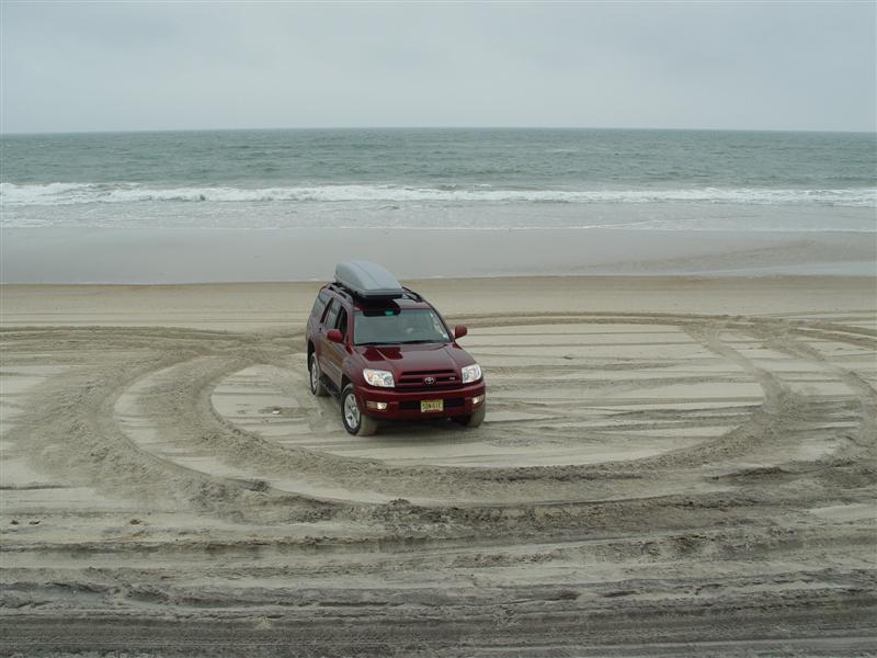

Never got a chance to post a pic of my rig, so here it is:
DSCN0614.jpg~original
DSCN0617.jpg~original
DSCN0618.jpg~original
DSCN0616.jpg~original
Ill take better pics when i go up into the mountains.
