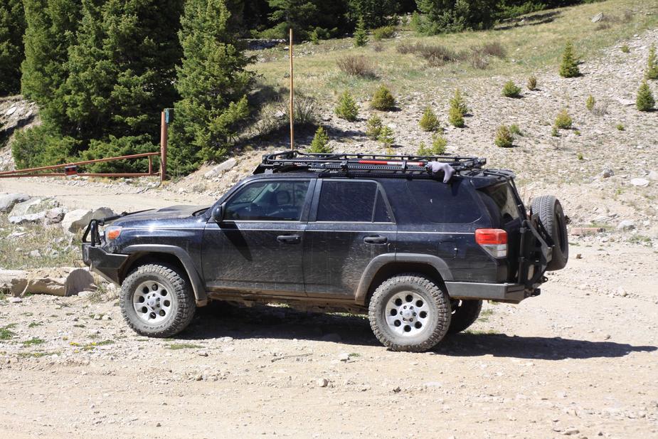

Passenger side. Make sure you keep it oiled / clean as they do rust. On mine nothing rubs and its rock solid.

Hi Philly,
Looks like you have the base sticking behind the rack. Do you get any noise from the base rattling inside the truck? inside mine currently sounds like someone is shaking a sheet of metal when I hit a bump just right, or some washboard pavement.
