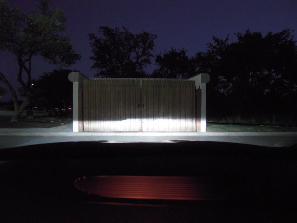

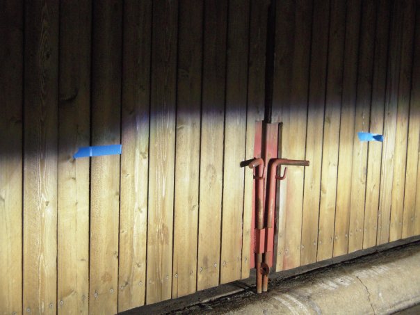

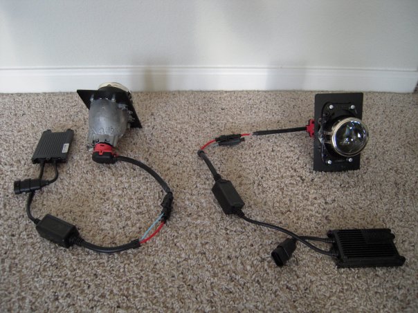

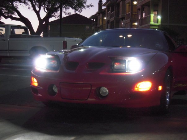

I bought an HID Kit that came with the bulbs and HID-specific reflective housings in the past. I installed them on my 2002 TransAm Firehawk and immediately took them off.
The glare was just not acceptable to me. I then used Retrofit Source and HIDplanet and did it right. I don't think there is any comparison between a HID bulb with reflective housing and projectors. My advice is to do it right.
Here are some after pics of the retrofitted TSX projectors I used. I wish I would of kept the pics of the HID Kit...the light above the cut-off/glare was so disappointing.
