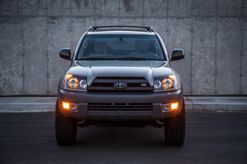

My old 4Runner with LS460 bi-Xenons
20121130-IMG_3369 by Addison Rickaby, on Flickr

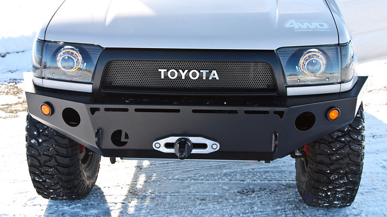

Amber LED turn signal halos
20121111-IMG_3253 by Addison Rickaby, on Flickr

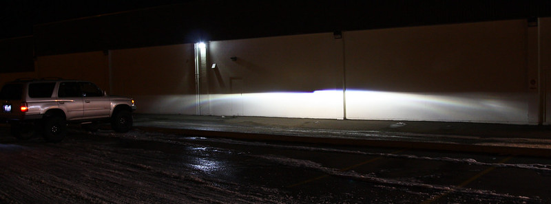

Crazy LS460 beam width

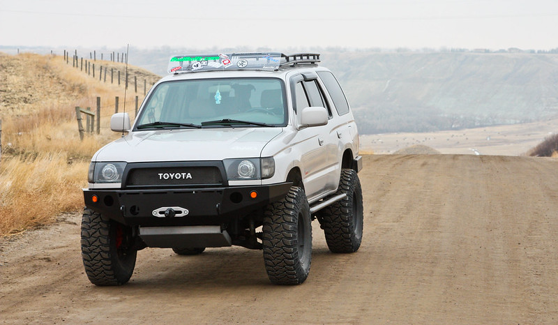

Then my old Tundra with FX-R's and Philips 85122+
20161002-IMG_7862 by Tamarack Media Co., on Flickr

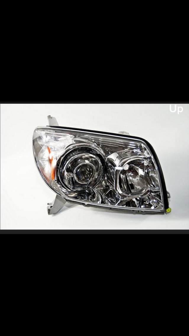

The LS projectors are huge and it has definitely been an interesting battle getting them into the 4th Gen housings. One of the challenges is that the LS430 projector is not centered like the standard FX-R and TSX projectors are and it sits kind of offset in the reflector bowl. The mounting "ears" for the reflector to the base of the headlight housing sit right where the LS430 natively wants to snug up to the reflector. This makes trimming tedius and difficult as you need to ensure the integrity of that mounting point.
What do you think of dropping the LS430 projector into the headlight? Do you think there is room for it?

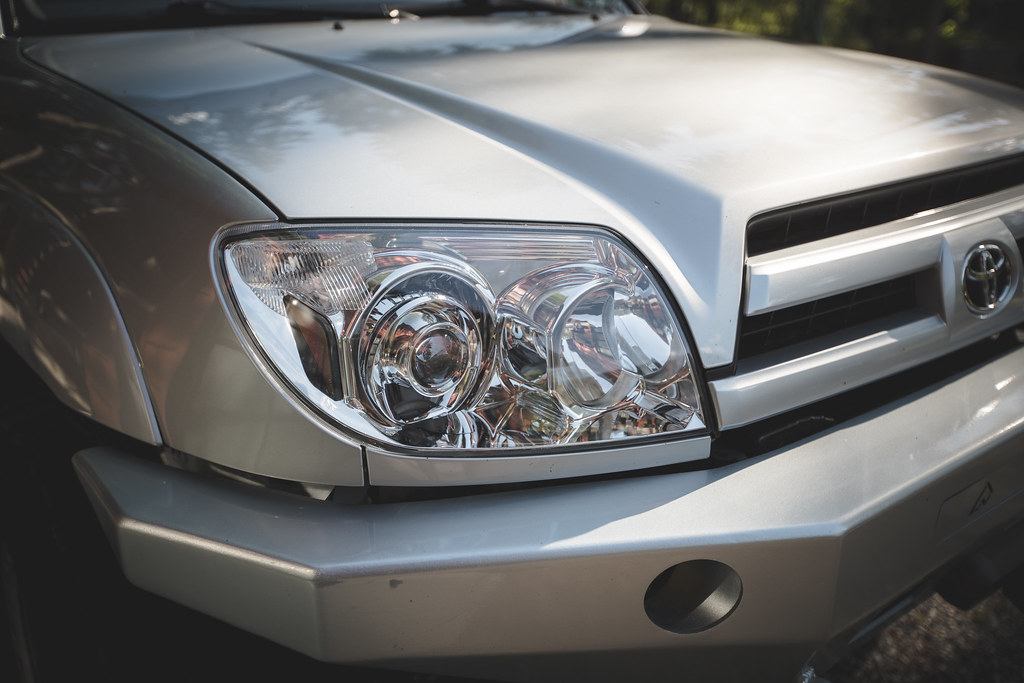

Now I have another question. So today was the first day my recently retrofitted headlights were exposed to rain and one of the headlights started fogging as seen in the images below. Does anyone have any recommendation as to how I can seal the headlights better?
Try throwing in some anti-condensation pads (TRS sells them). You can basically slip them in the back of the headlight (behind the reflector bowls so that you cannot see them from the exterior, and hope that it remedies the problem. If it pursists it could be a poor seal job between the headlight lens and the headlight assembly. Did you do the retro yourself?
I paid someone to have them done, so I'll going to be contacting them soon to see if they'll fix them. Do you think having moisture in them will cause any damage or hurt the appearance of them once I get the seal problem fixed?
[MENTION=5149]riceandpho[/MENTION] and Samm25 thanks for clarifying that up for me. I'll be contacting TRS tomorrow to get the right harness.
Take it back in the oven asap. Take it apart and dry everything out. Be careful with the inside of headlight lens. Use compress air to blow it out. I back the lights at 250 to 260 for 10 mins. Then squeeze it together some more and put it back in for another 5 to 8. And take it back out. Then squeeze some more on the edges. If your not going to do any more headlight mods. Put a bead of silicone around the outside edge. But for you. I would find more headlight lens butyl seal.

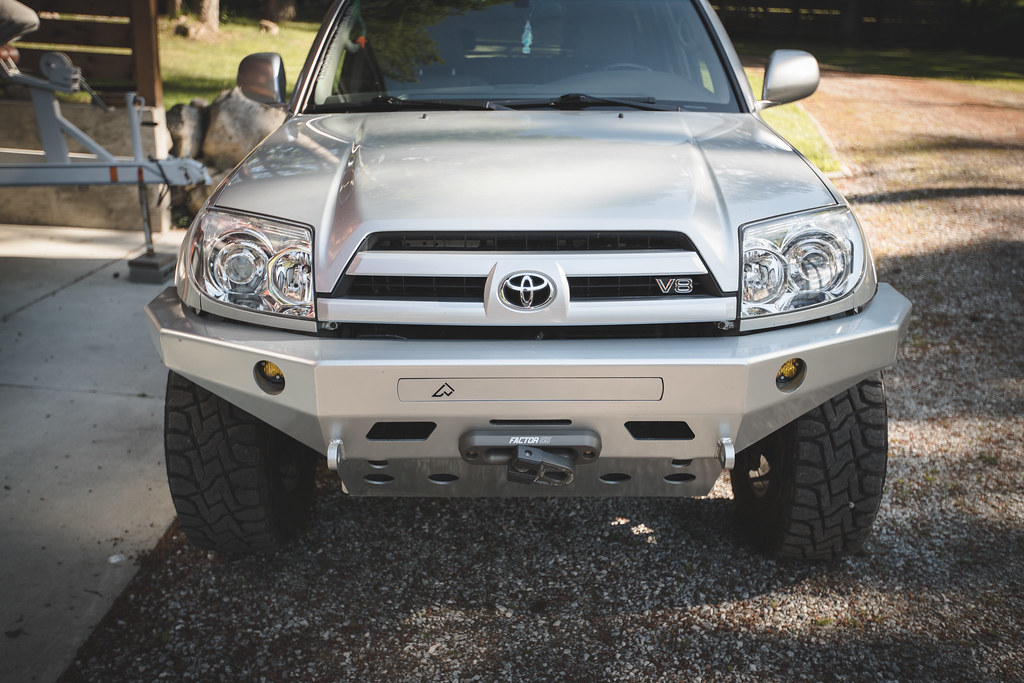

Do you have any pictures of the LS 430 projectors on your car?
I am building LS430's into my 4Runner right now. Pictures linked in my post above. Yes it's doable. I've actually already built one set for a member of this forum. Now I am working on my personal ones. No write up that I have seen...
