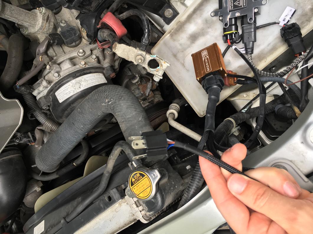

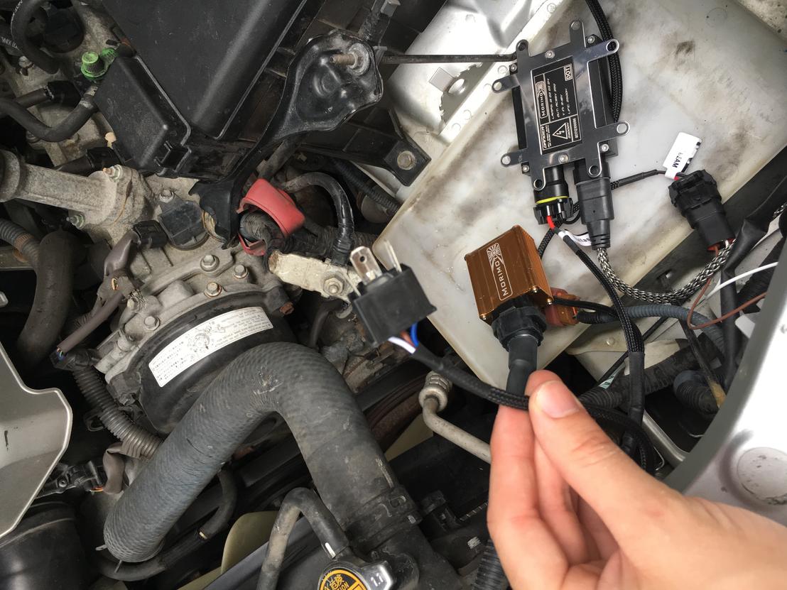

So I'm currently installing a HID kit in my car from TRS. I have gotten everything installed, but the harness (MotoControl Bi-Xenon: H4/9003) they recommended has an OEM connector that look the one in the picture below. It's a H4/9003 connector while the headlights are 9006 for the low beams. Does anyone know how I'm supposed to install this? Did TRS recommend the wrong wiring harness?
You have the wrong harness. Since your factory bulbs are 9006 and 9005 you need to get the harness that says it fits 9005/9006/9012/H10
The harness is supposed to fit the factory plug just as a plug and play. There will be no modifying anything.
In other words, the OEM harness that comes from the factory into the headlights will plug into that wiring harness, if the plugs are different and you can’t plug the OEM harness into TRS one, the harness is the wrong one.
wrong harness, but to make it work, the top is the low input, the blue is the high input and the other side is the ground.
you need the standard 9006 harness.
even if you have the 06-09 model, they give you an h11 to 9006 adapter, but the harness is actually standard 9006.

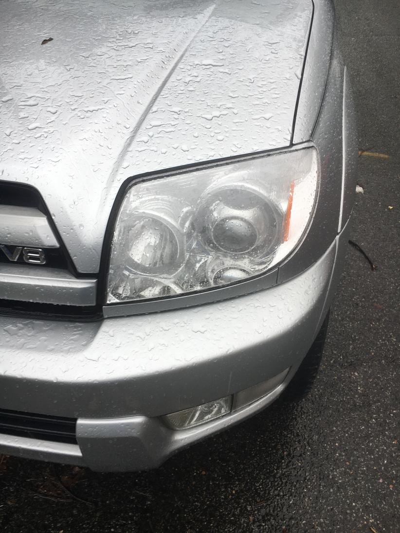

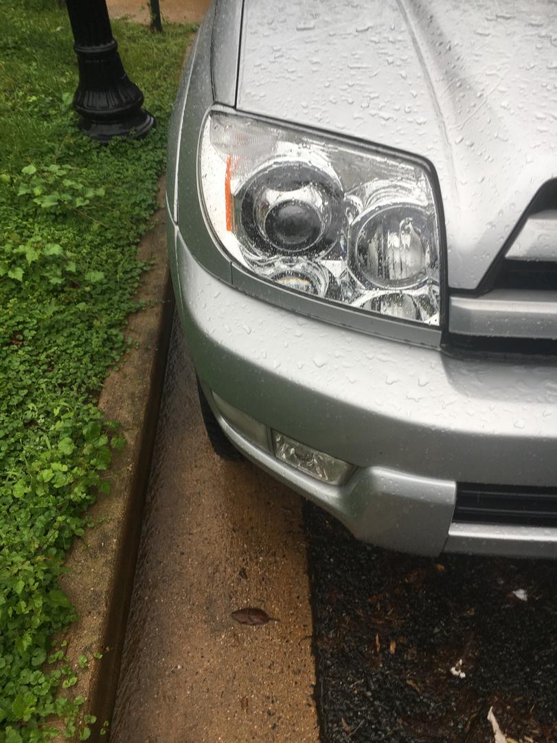

Now I have another question. So today was the first day my recently retrofitted headlights were exposed to rain and one of the headlights started fogging as seen in the images below. Does anyone have any recommendation as to how I can seal the headlights better?
