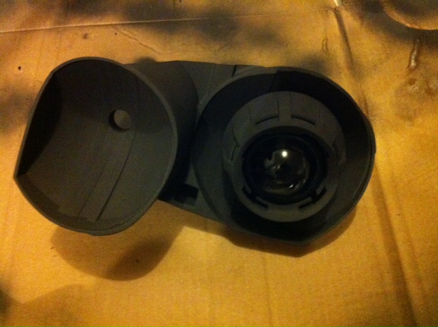

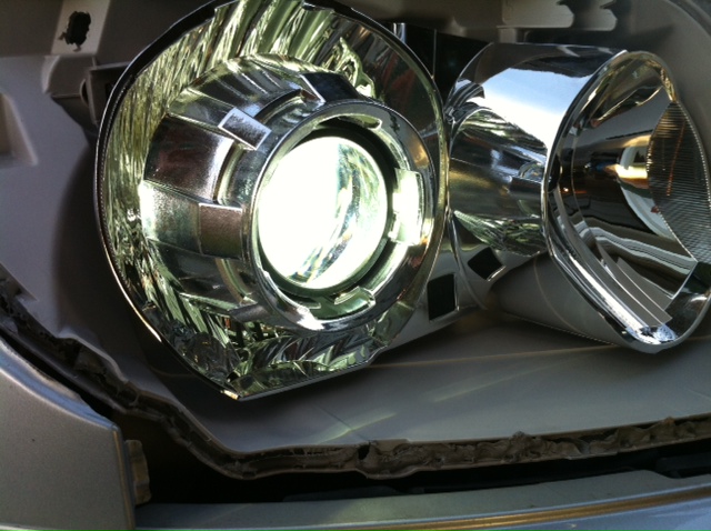

Gatling Gun all the way. I just took mine apart and painted them. Here's a pic of them painted and unpainted. FYI, make sure to use some sort of sealant/glue on the shroud. I didn't the first time and one of them shook free and was scratching the inside of my headlight. It didn't fall off completely but was an annoyance. My buddy did the same retro on his Taco and his Apollo shroud fell off completely. When I blacked out the headlights I glued the shrouds in place.

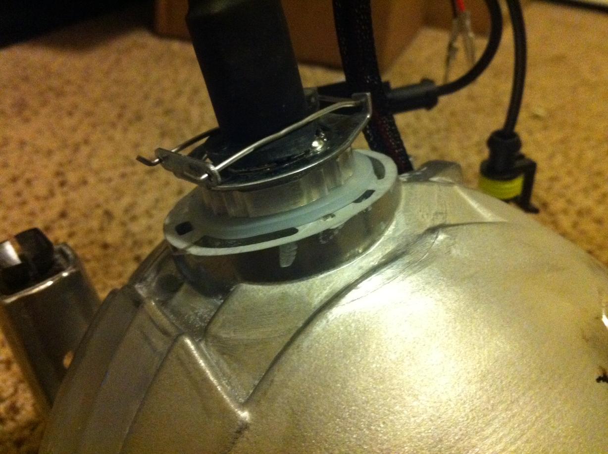

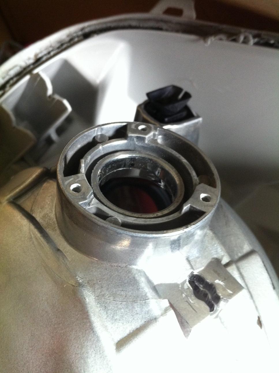

I actually didn't have to cut either. The only thing you have to do to make the Mini Morimoto H1 projector fit is grind down the rear of the housing where your normal halogen bulb is locked in. Below is a pic of what I mean. You have to grind it down almost 3/8" to get the projector lock nut on and snug. The shroud fits perfect over the projector, just as it's made too. I did have to glue the shroud in place this time as if you take it offroad and it gets jarred around, the shroud may come loose. I also used some silicon behind the projector as the rubber grommet provided in the kit didn't give me enough stabilization. You can't see the silicon, it's hidden behind the shroud.
