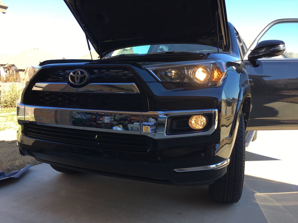

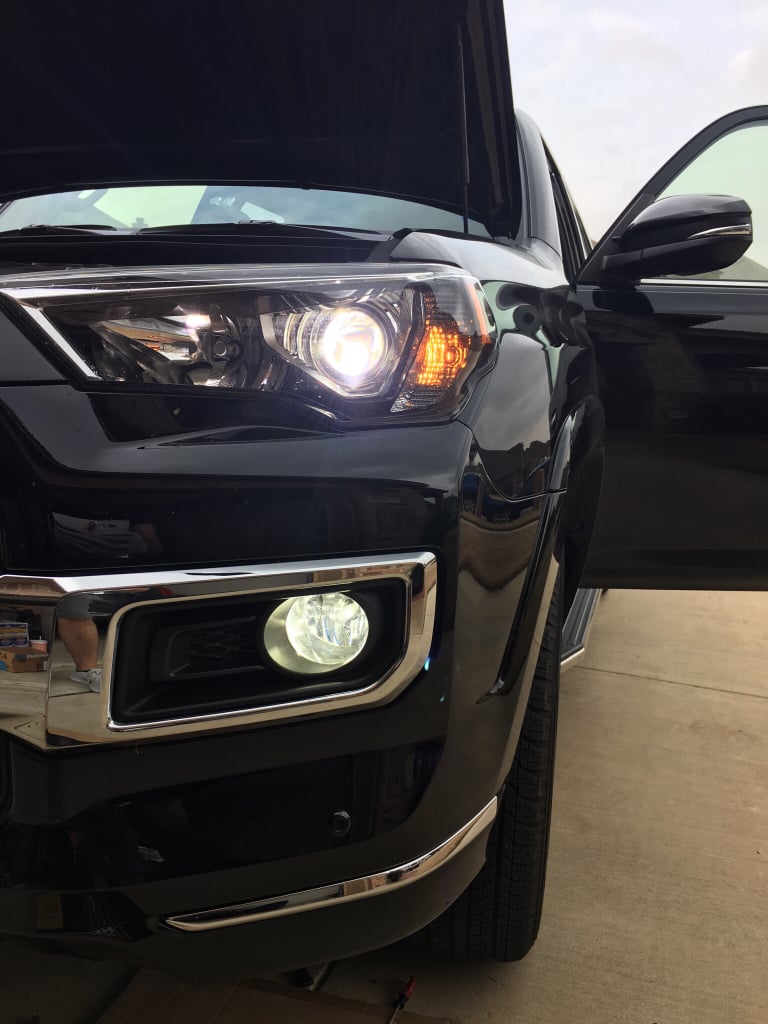

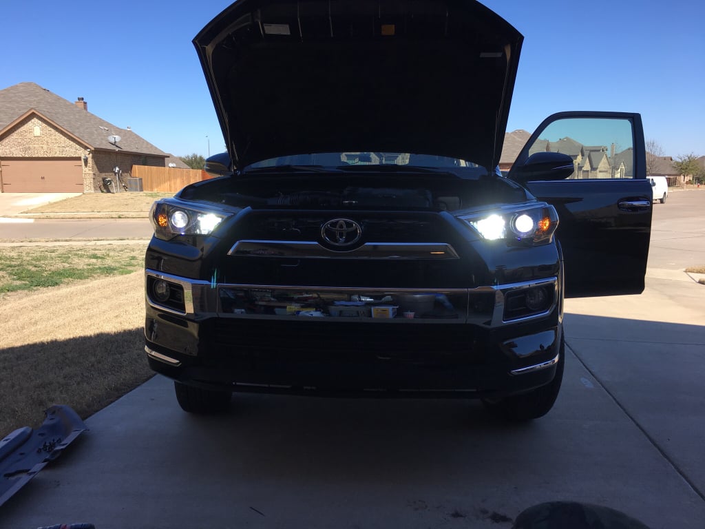

I went with the Xenon Depot xtreme in 5000k. Wanted a whiter light and be able to match other lights easier. The fogs I went with the Phillips Extreme Vision LEDs from Amazon. With Prime I received them next day!
For the DRL/Hi Beams I used the DDM tuning saber LED KIT. They give off a slight hyper flash but don't mind it much. They look much better than the yellow DRL and super bright when used as hi beams. Sorry for the crap photos, need to take some night shots.
Before
After- They match up better than what the picture shows.
With Hi Beams

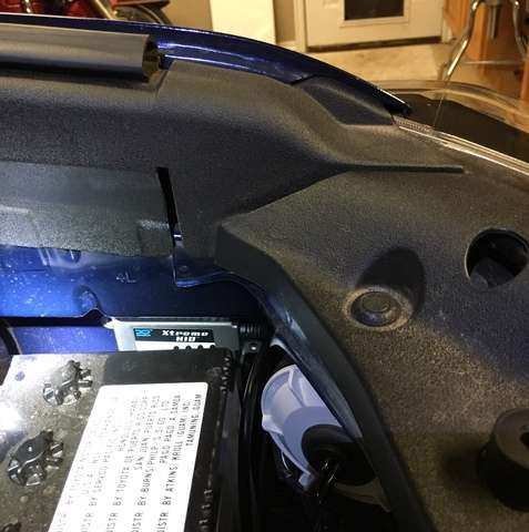

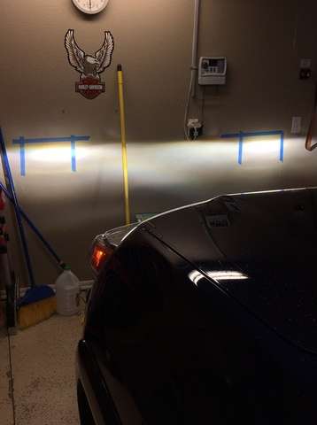

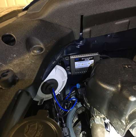

Got mine installed today. 2017 4Runner Limited.
H11s from XenonDepot. They were VERY helpful with all my questions prior to install. It was a breeze. Few pics below.
Used a 1" spade drill bit to hone out the hole required for the wiring to pass through the access cover to the light housing. Smoothed the round edge with a round wood file. Allowed the rubber grommet fit super snug.

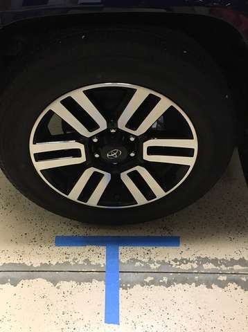

To help with aiming after the install, used painter's tape to mark where the old lights hit the wall in our garage, marked the floor to ensure truck would be in the same spot.
Pulled the battery completely out to allow for easy access to driver's side.
Difference on the road is night and day.

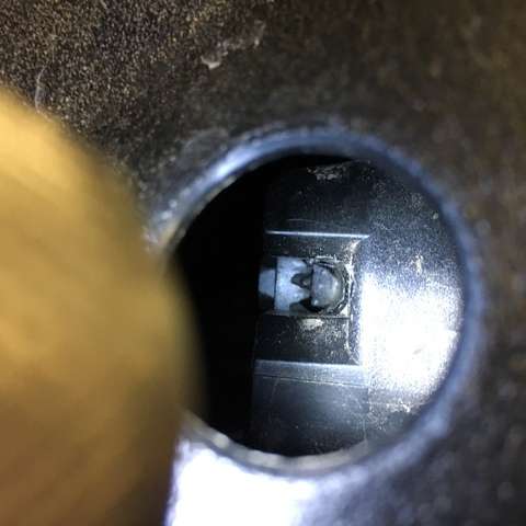

Of note, my 4Runner does not have the 8mm nut at the rear of the light housing to adjust beam height. Rather, it has a "gator tooth" style system that accepts a phillips head screw driver to adjust the height located on top of the housing. Small hole for access though the plastic cover between the radiator and bumper.
Pic below.
Hope it helps.

Thanks for the feedback and taking the time to post pics of your process. Glad to hear you're liking the results :D
