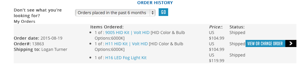

Attached is a copy of the invoice of an order I placed with Xenon Depot a couple months ago. Hi's, Lows and Fogs all 6000K. The hi's and lows were HID and the fogs were LED. Absolutely amazing quality, no issues whatsoever. Very simple and straight forward installation and if you decide to get a light bar down the road, all of the light temp color will match at 6000K.
