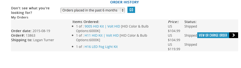

Attached is a copy of the invoice of an order I placed with Xenon Depot a couple months ago. Hi's, Lows and Fogs all 6000K. The hi's and lows were HID and the fogs were LED. Absolutely amazing quality, no issues whatsoever. Very simple and straight forward installation and if you decide to get a light bar down the road, all of the light temp color will match at 6000K.

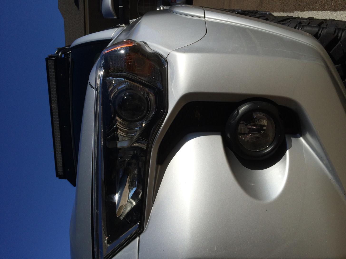

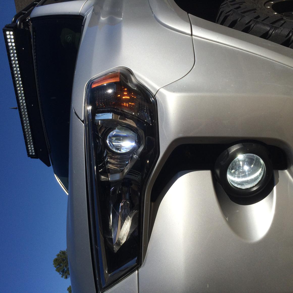

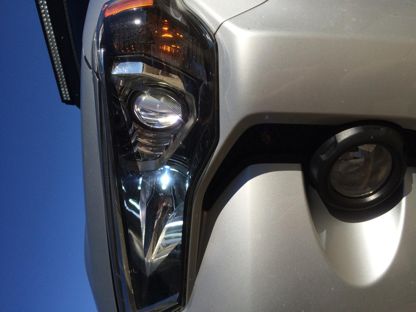

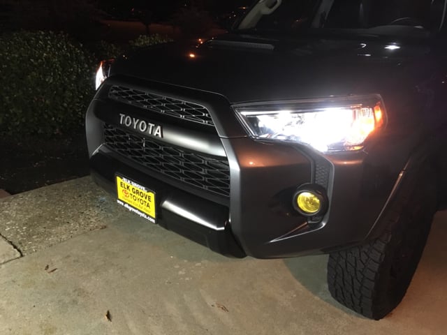

And attached below are daylight pictures of the lights:
Tip- In the installation video, they used a step bit which will typically cost you $35 or there about. I wasn't going to spend that on a tool I was going to use once. Get a 1" hole bit (Milwaukee 1 in. Shockwave Thin Wall Hole Saw-49-56-9815 - The Home Depot) and do the same process for 1/3 of the price. Yes, I know their hole size was .8" and the hole bit is 1", but rest assured the grommet will have a nice tight fit with no jeopardization the interior of the housing.

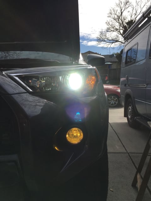

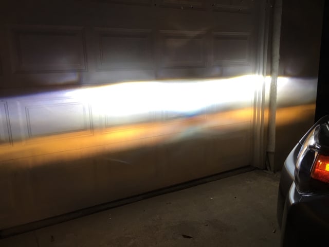

Installed my H11 kit from TRS yesterday. These are their 5500k bulbs and I went with their 50w ballasts with HD relay. Install was fairly simple with the help of some guides and Saker's posts. Thanks! Might have to lower the beam a bit or maybe I'm just not used to it being so bright haha. Overall happy with the install. Here are some shots:
