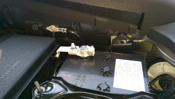

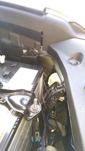

I used existing ground locations. The passenger side is mostly hidden by everything. The passenger side is the hardest to get to, you have to remove the air pump cover and squeeze your hand in there, mechanics gloves are good for this.
Right now I have both hardwired to the battery, this is also temporary until I install a power distribution block for some accessories (also waiting for it to warm up a little). To mount on the battery post I had to replace the ring connector with one that was a little bigger, doing this also allowed me to heat shrink the wire all the way to the fuse to stiffen it a little more to prevent any fatigue at the connector.
Pictures are below, I'm probably not a good example to copy since this is pretty messy until I get a chance to mount things more permanently
After you install yours you may need to adjust your aim a little, don't forget to check
(also, posting this reminded me that I forgot to go back and loom the blue and black wires so I'm doing that this weekend)
just above and to the left of the battery you can see the drivers side ground point. there is a ground on the passenger side near the air pump that looks the same that I used on that side.

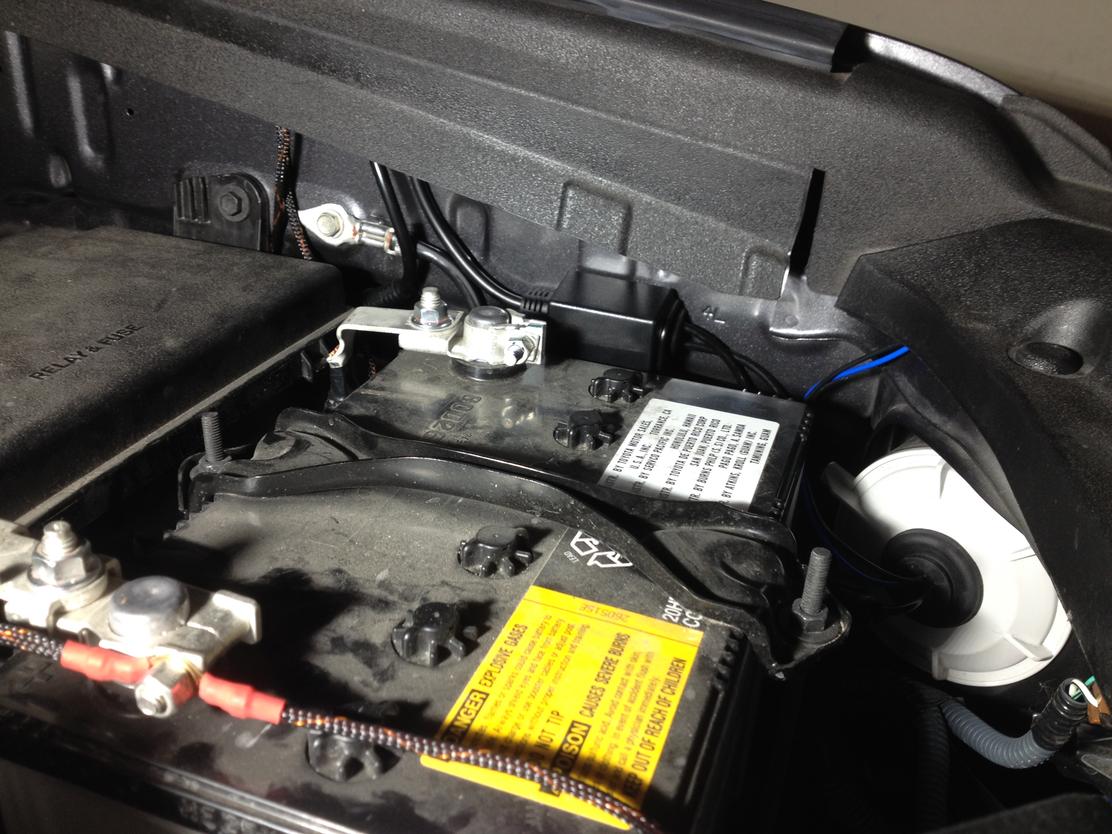

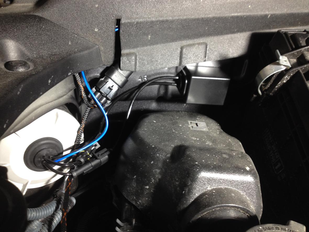

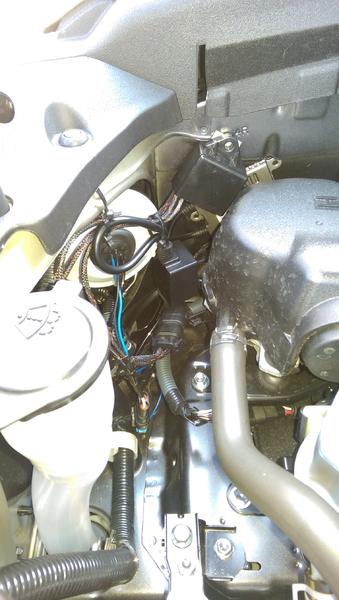

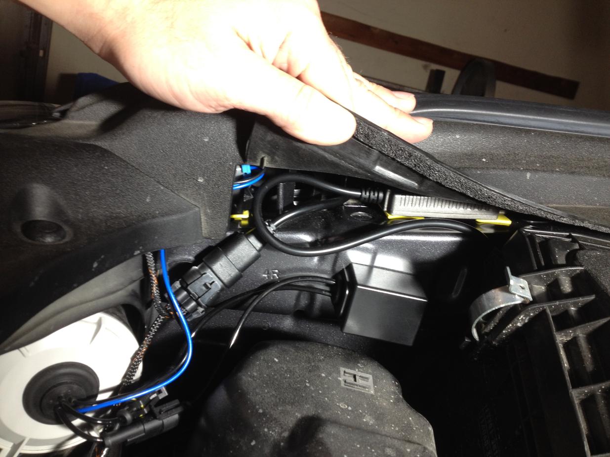

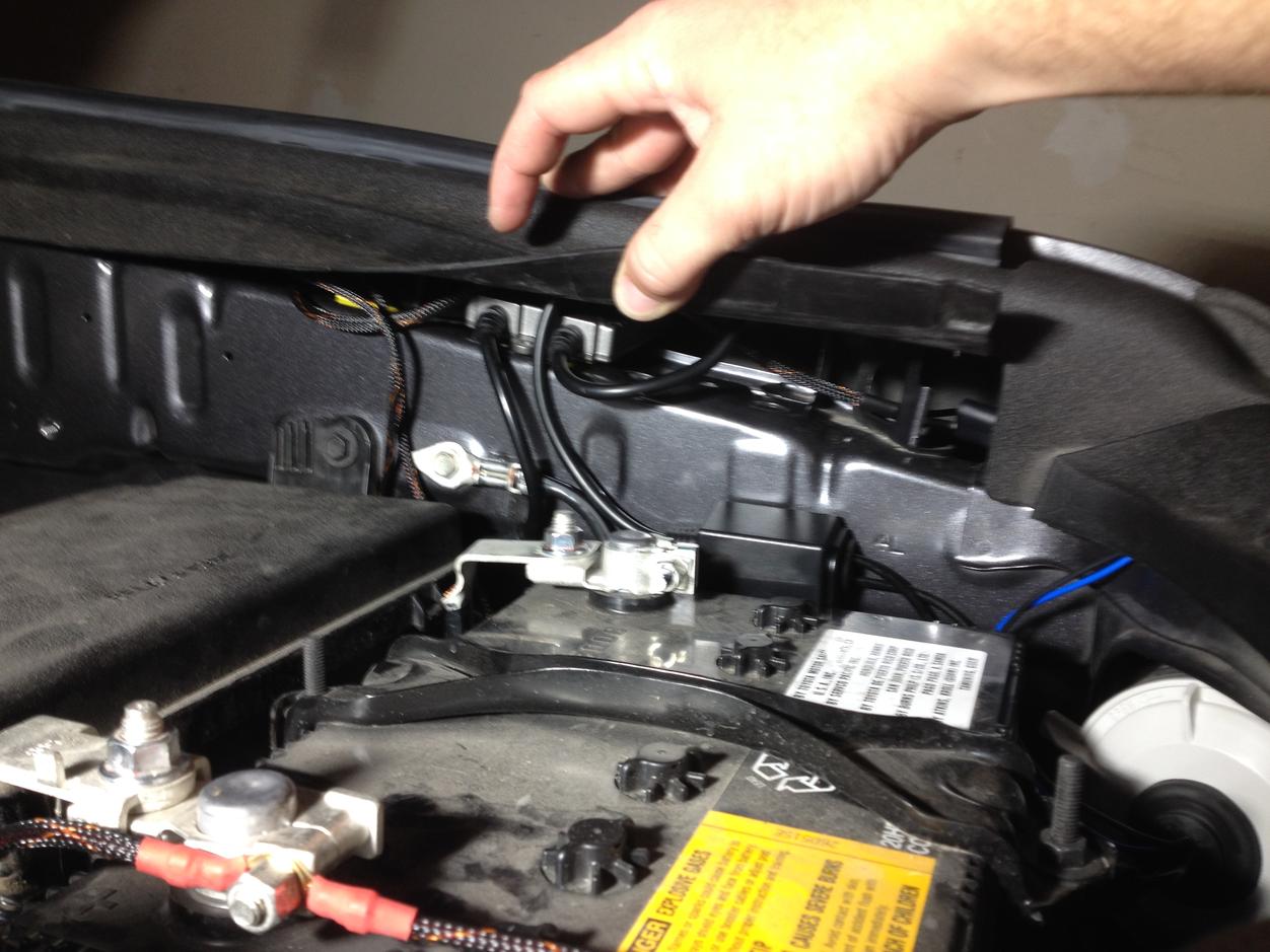

thanks for the responses guys, i finished the install of the XD H11 Xtreme HID Kit with 4300K Phillips bulbs today, ended up using both relays because i wanted to keep it uniform and the passenger side would not fire without one (tried switching polarity first).
very happy with how it turned out, so far i just have a few pics to show the general layout on each side.
1st and 2nd pics are passenger side where i hid the relay and ballast under the plastic/rubber cover above the wheel wells and the other black box thing (?) that comes off the ballast onto the side of the sheet metal below where the ballast sits. zip tied the relay positive under the radiator cover to the battery. used the provided 3M for the attachments, seems like it will hold up pretty well.
3rd and 4th pics are the driver side, pretty much same setup but the relay is on the other side of the ballast. you can also see the positive wires from the 2 relays attached to the battery here.

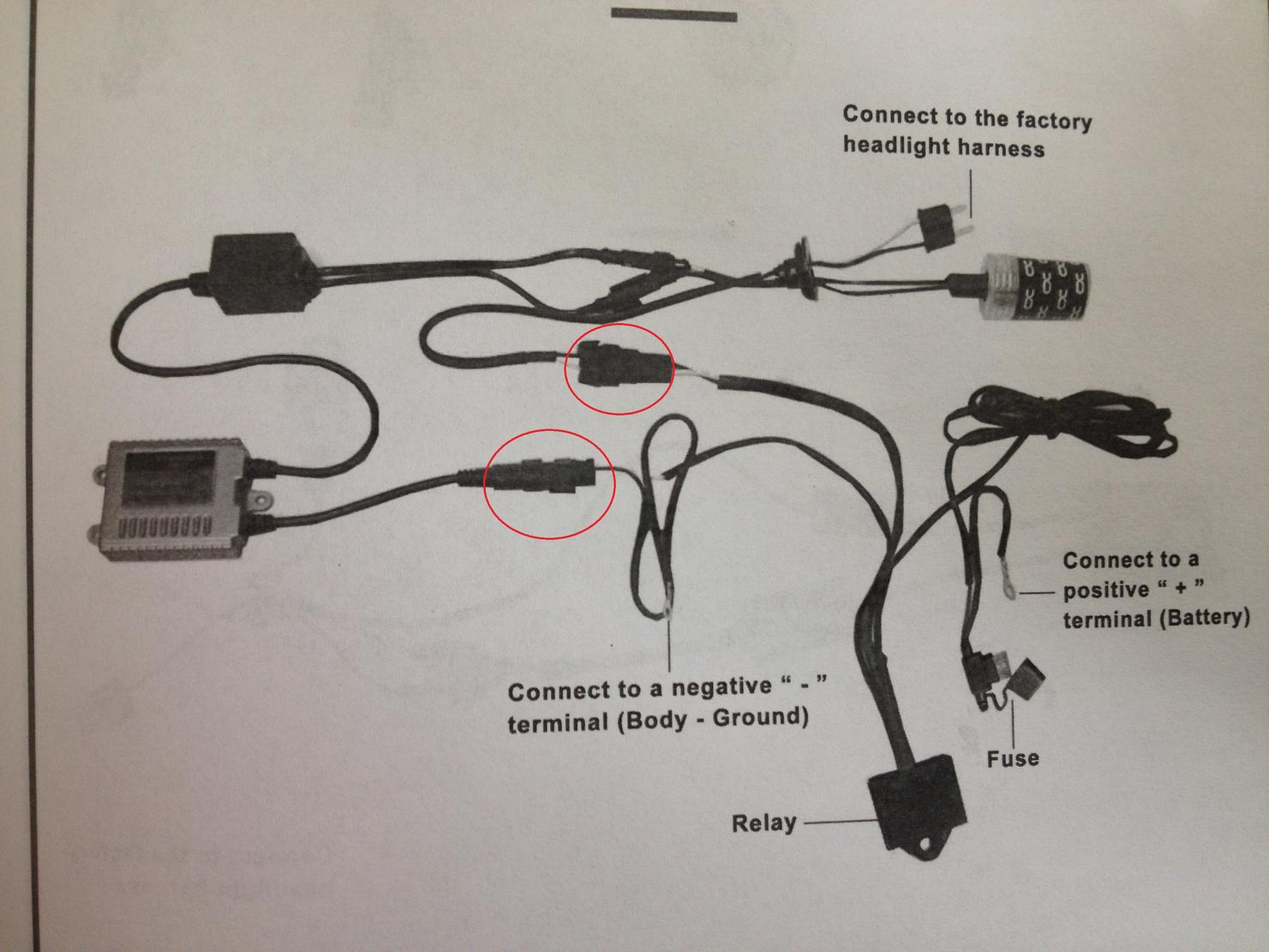

So with your setup w/relays how exactly does it wire up? Also you think you post up a couple pics of the wiring diagram they sent if they sent one?
here is the pic from the install guide. the 2 clips circled in red is where the relay jumps in between the bulb and ballast, this would be a straight connection between the 2 for those not using the relay.
Ok so if I don't use the relays then it looks like I don't need to connect anything to the battery is that right? It would all just connect to the factory harness?
