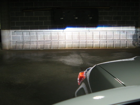

I really like the output of the HIDs. So much better. But in the pic, you can see the driver side high beam in relation to the passenger side. The passenger side is the dimmer one in the middle.
It is too high in comparison to the passenger side and for general usefulness. Unless I am in a hilly area, the high beams do little for lighting the road.

Your picture reveals that the DS headlight is aimed too high.
The two LB cutoffs should be on top of one another, not as pictured, where the DS LB cutoff is higher than the PS cutoff.
Do you know how to adjust the headlight up/down?
ETA: The pic also reveals that your DS projector is rotated a bit CCW, as the cutoff runs 'uphill' to the right. Both cutoffs s/b parallel, but I think once you lower the DS headlight, this will not be very noticeable.
Further, your DS HB looks to be dramatically brighter than the PS HB. Are they the same bulbs?

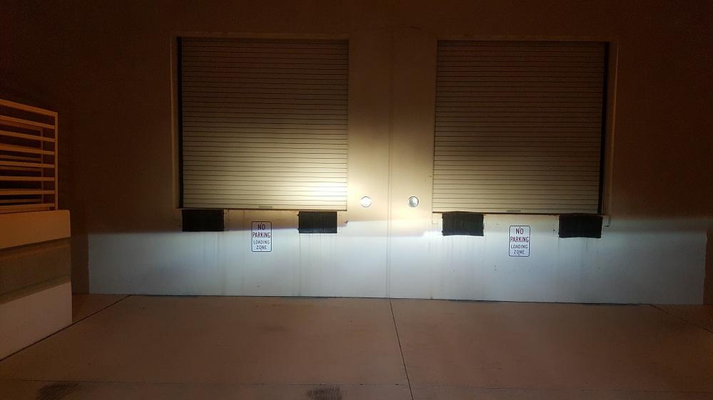

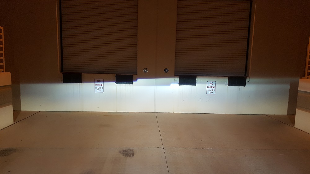

This is what the LBs should look like, although this was taken at a time when I intentionally had my PS headlight set a tad high. Note how level the cutoffs are.

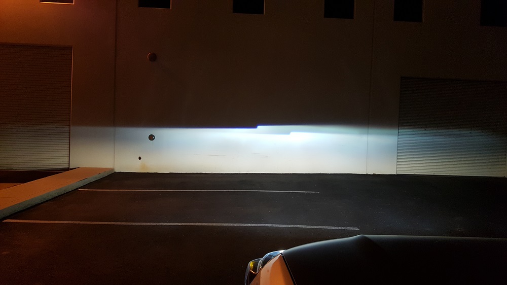

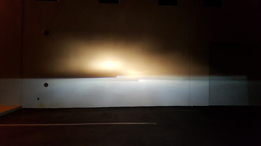

These pictures are more accurate as I wasn't on level ground in the other pics.
The High Beam bulbs are what were in the Toy already. One may have been replaced at some point. I will probably get some new ones that are a little closer in color to the HIDs.
I think my Toy may have been damaged in the front at one point. I find more and more indications of that. So that may be a little of the issue.
Bulbs are Morimoto 3Five 5000K D2S. When I referred to adjusting the HIDs, I figured it would involve disassembling and adjusting the projectors. Just don't know what is involved in that.

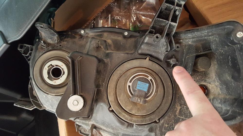

I think I know how to adjust them. I will confirm on the stock ones but it looks like there is a Phillips screw to turn on the back.
Yup. I think if you lower that left one you'll be fine. The rotation is not that far off.

looks to me, just like [MENTION=51186]philsey[/MENTION] said; lower your DS a bit and you should be good to go

Not sure about other years, but the 2011 does not have the horizontal adjustment. This is where it should be.
