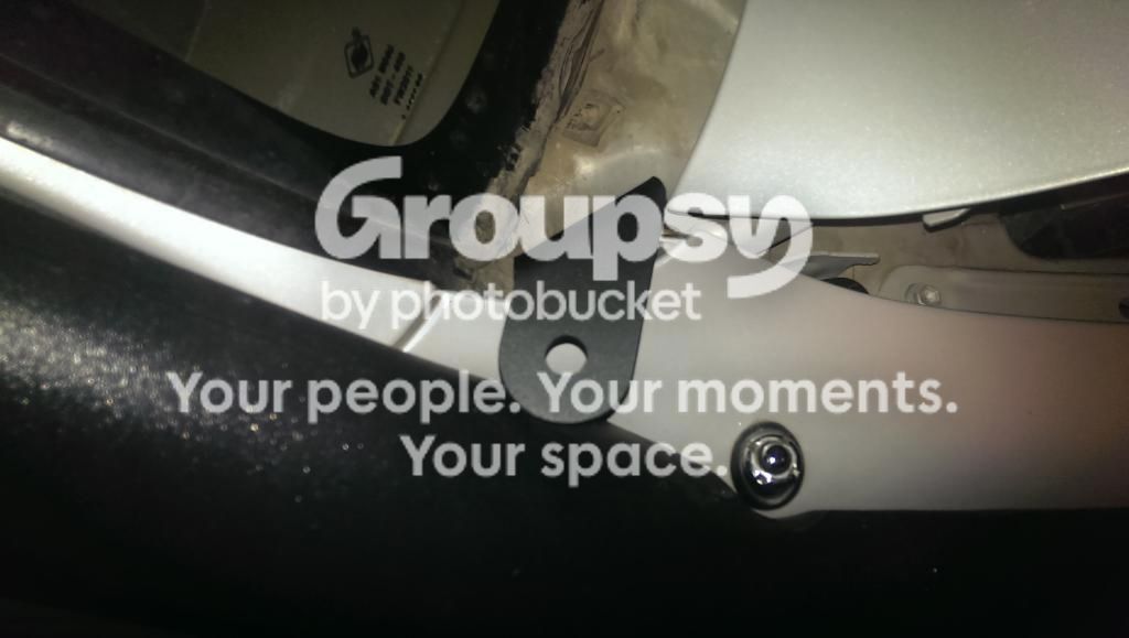

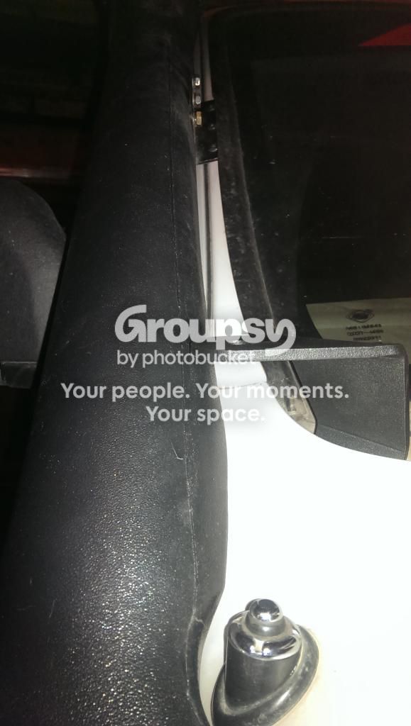

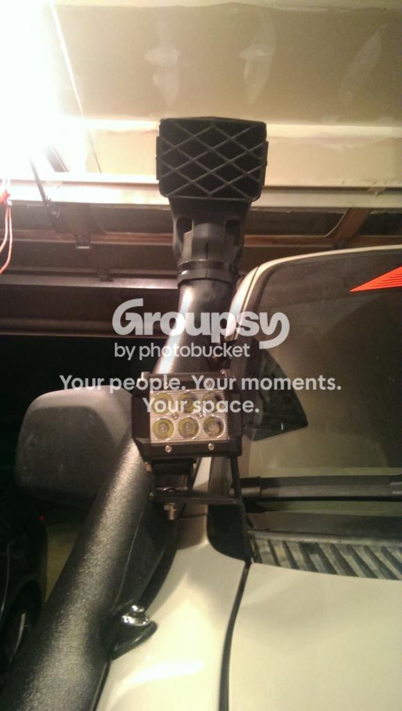

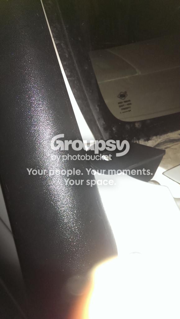

1) we started with the rubber L shaped house being connected to the air box. Many people have posted that this process was a huge pain, but it went quite simple for us. Having two people makes it much easier. Heat the tube up over a small flame to stretch it out. Start to put it on your factory airbox and use a flat head screwdriver to get it over it. Once on, use a pair of vice grips to stretch the tubing over your air box outlet. This rubber is very strong and will not rip. Place the air box back in with the house and house clamp connected. Wait until after install is completed to tighten the 3 bolts back on, just incase adjusting is needed.
2) attach the template to your fender, lining it up a the door end of the fender, holding it very flat and taught, making sure it is taped as smoothly as possible
3) after taping, begin to cut your hole, slowly. After the hole is cut, you'll want to set the snorkel in, line it up on the windshield mount, and then trace around its position. You'll use this tracing to modify the template for your own holes.
4) once you cut the hole you will find some factory tubing between the fender and the engine bay frame. rip that tubing out.
5) to make the template, you'll take it with the big hole already cut out and tape it to the back of your snorkel. Then you'll feel under the paper and punch out the 5 holes from the snorkel. While you're going this step, you can also attach the bolts into the snorkel. use a hex bit to tighten them and make sure to use locktite.
6) after the template it make, retape it back onto your fender and drill your holes. Give a quick punch in each hole to make sure your bit doesn't walk all over
7) once the holes are drawn, line it all up, make modifications of necessary and put the sucker in!
8) Take the wheel off for easier access. You'll have to pull down that fender liner to access the bolts. This is a bit of a pain and having someone with small hands will make it much easier
9) keep the fender lining peeled back and slide the L shaped house onto the snorkel. Attach the hose clamp they supplied. Its a huge pain to tighten and will not fully tighten. I suggest getting some gorilla tape and going around the connection just to be safe. Use the same flathead/vicegrip process when joining the tube and snorkel.
10)once all the bolts are tightened the gaps will fill in and all the pain work is finished.
11) attach the head of the snorkel using the black hose clamps. Before you put the head on, cut a dryer sheet and place it over the snorkel. This will prevent bugs and what not from going down the snorkel, while still allowing for airflow.
after that step you're finished!
message me or post up with any questions or suggestions.
