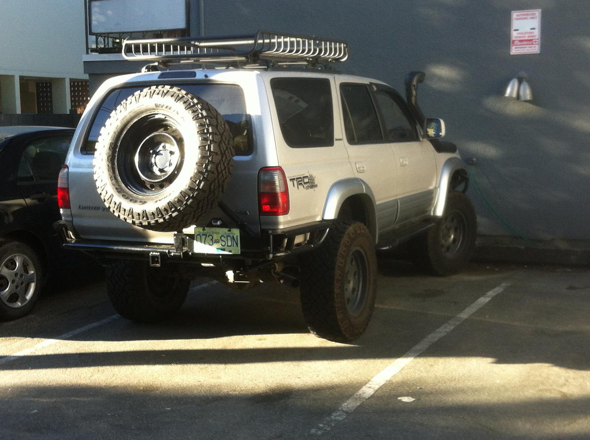

Just a tip from my experience. At about 130km/h i had the top boot fly off of my snorkel but luckily recovered it and no damage to the piece, I put some pan head screws into the top connection to make sure it wouldn't happen again.
