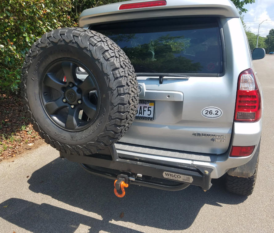

I will get more pics of mine, but they are worth it. And you can tow your trailer no problem.

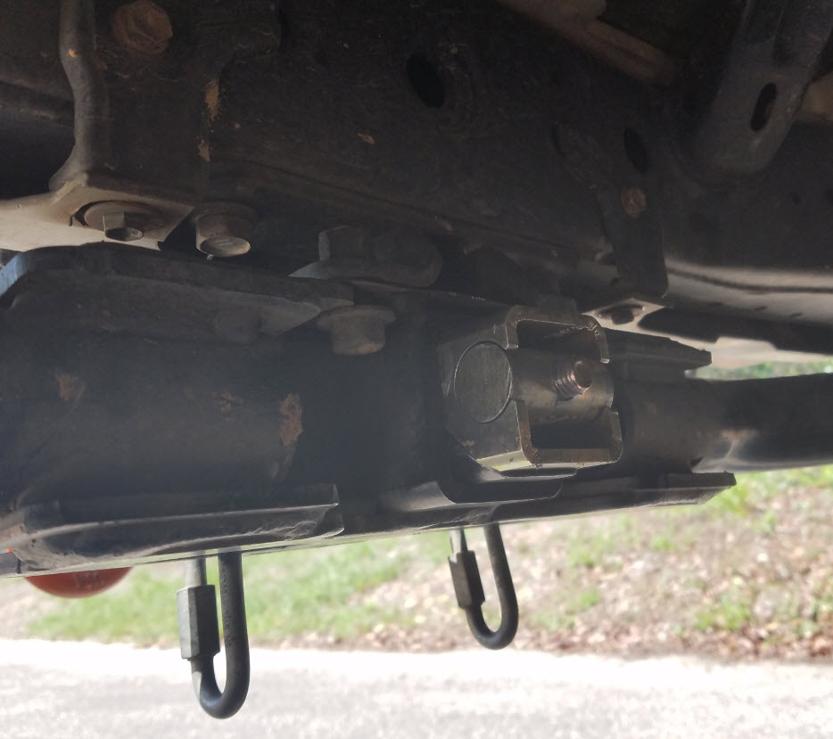

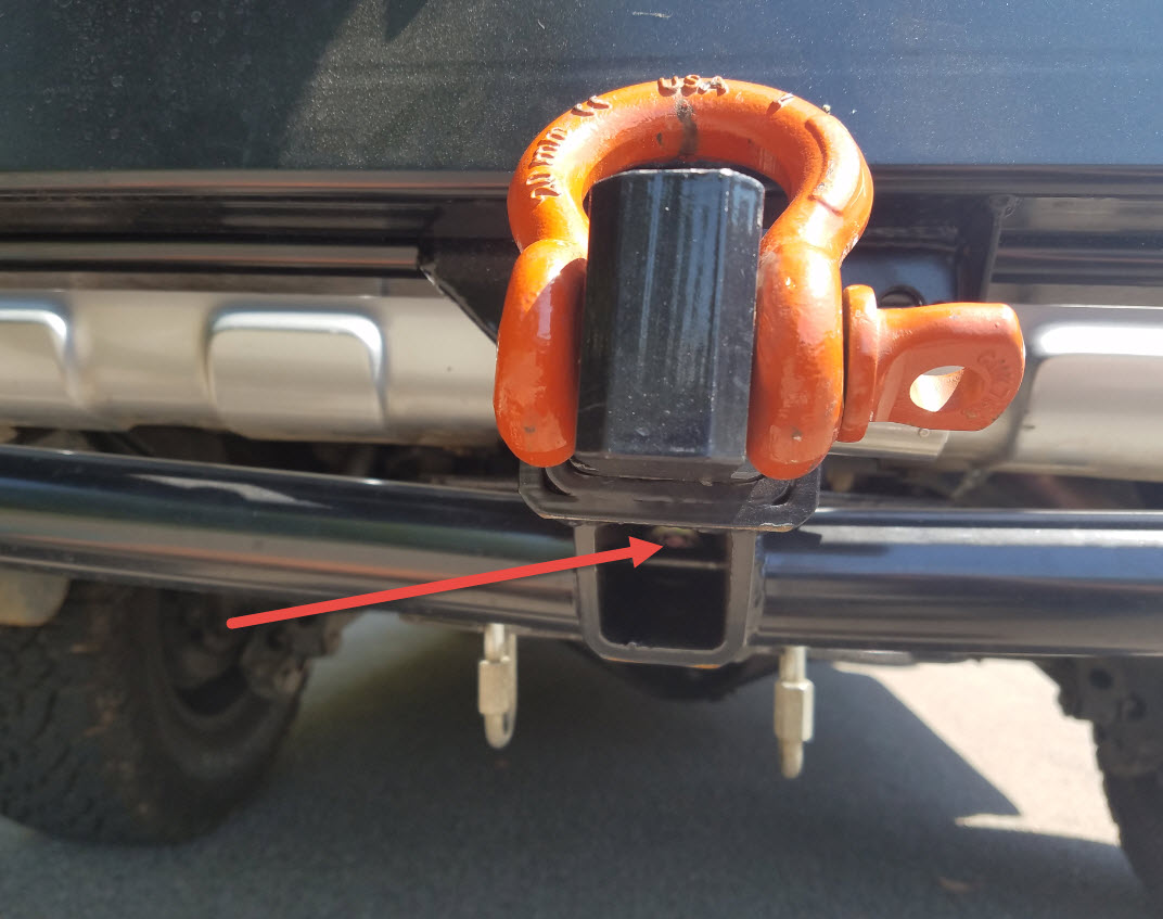

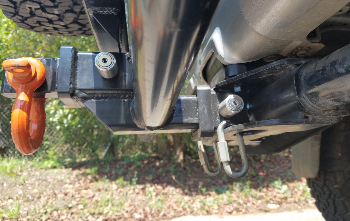

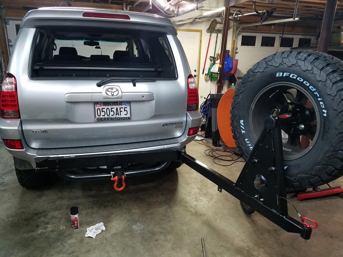

There is a bolt that gets tightened down that forces that anti-wobble lever to tighten up in your existing hitch. See pics. (Also see the Install PDF from WILCO's website.)

This looks like a great option, does anyone know what it does to the departure angle?
I did not have any issues with it a few weeks ago on my trail ride. It appears to be built up high enough on the hitch and in line with the angle of the rear bumper.
It can also be removed in a matter of minutes if the trail gets too steep.
Not sure if this has been answered yet but it doesn't go any lower than your existing hitch...it simply extends out a couple inches from there. The support arms begin to extend upwards immediately.
It would take pretty severe crawling to being making clearance an issue.

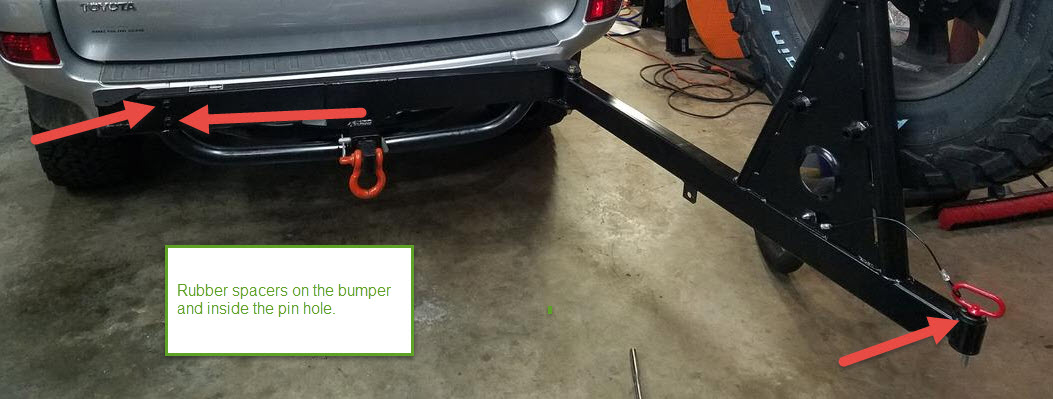

So how does the latching system on this carrier work? Looks like it is just a pin? I built mine similarly but mine clanks around even with seemingly-little play.
It actually does not move around at all. WILCO put these little rubber cylinder shaped bumpers on the main bar and in the pin holder hole. When you close the arm it creates enough resistance to prevent clanking.
