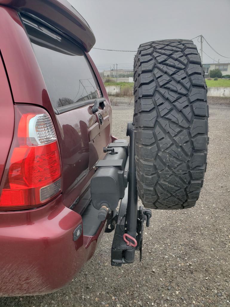

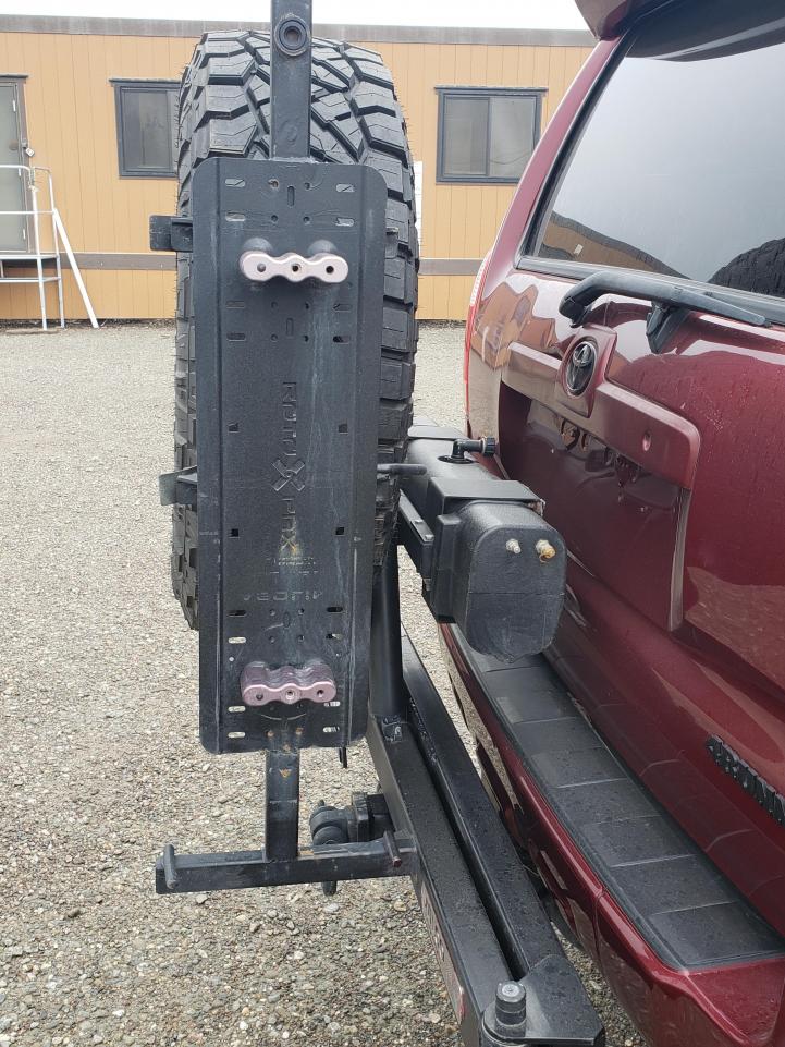

Here are some pics of mine. HOWEVER, I have had mods done to mine. I had him bring the tire in slightly and angle it. I also had a 5lb propane tank holder added along with a bar that allows me to hold my Treds and Krazy Beaver shovels (2nd pic). I love it and haven't had any issues going offroad with it. I'm not a super rock crawler so I'm not too concerned with aggressive departure angles. Plus...I can I keep my stock tow rating which is nice. I will add, the thing does NOT wobble at all. It's a pretty damn cool design. The 3rd pic was it off the shelf (Mojave Rd.)

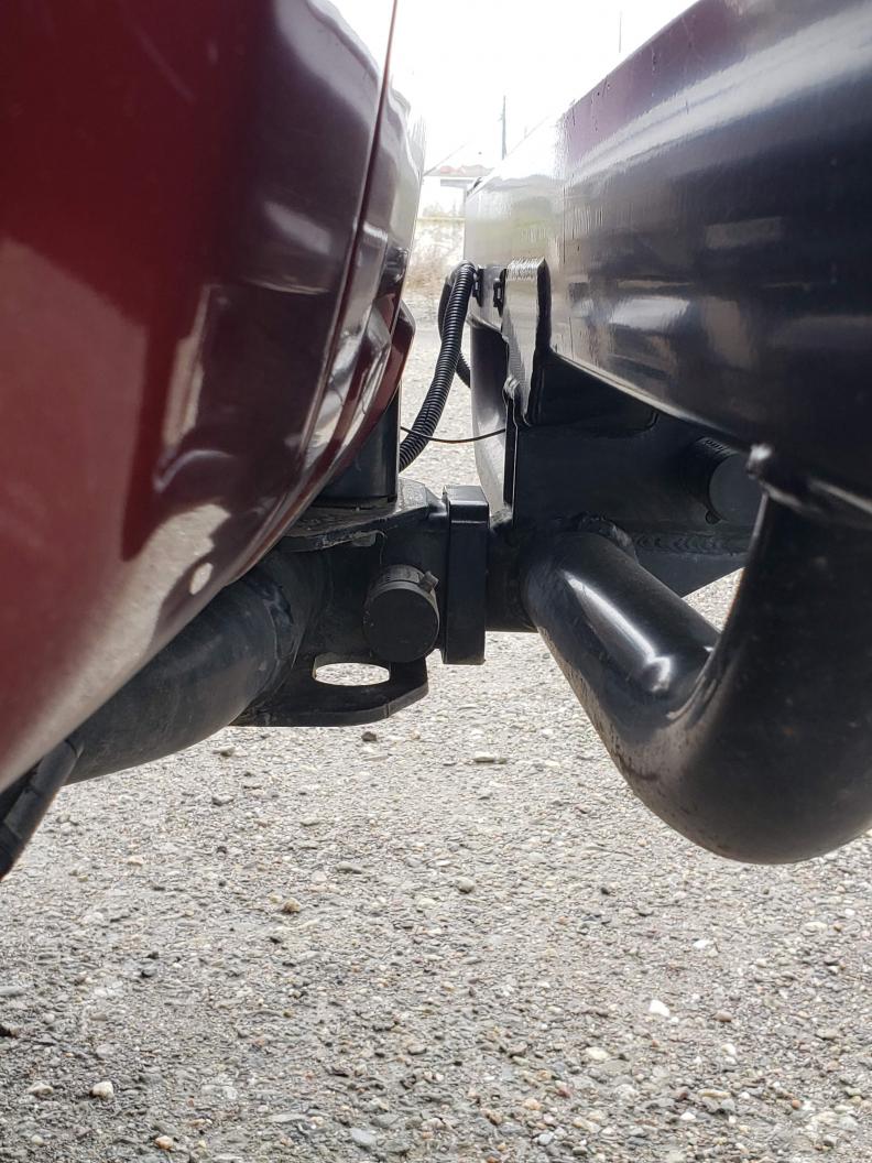

MrEMan...here are some pics. Unfortunately the locks holding the recovery and the Wilco in the stock tow hitch were seized and unable to get a pic of the extra hole I drilled. To get it closer I drilled one extra hole up near the cross portion. But doing that I had to have 3" extension welded on my stock hitch on the backside so the wedge clamp on the Wilco would grab enough. Then when I had all the custom work done for the TredPros and shovels I had him cut the round wheel mount portion and take some off and angle it. The mounts were later changed to Rotopax mounts. If I can get those locks out I'll snap a pic. Sorry couldn't be more help.
