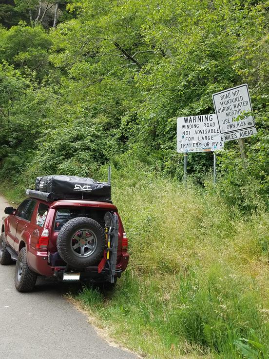

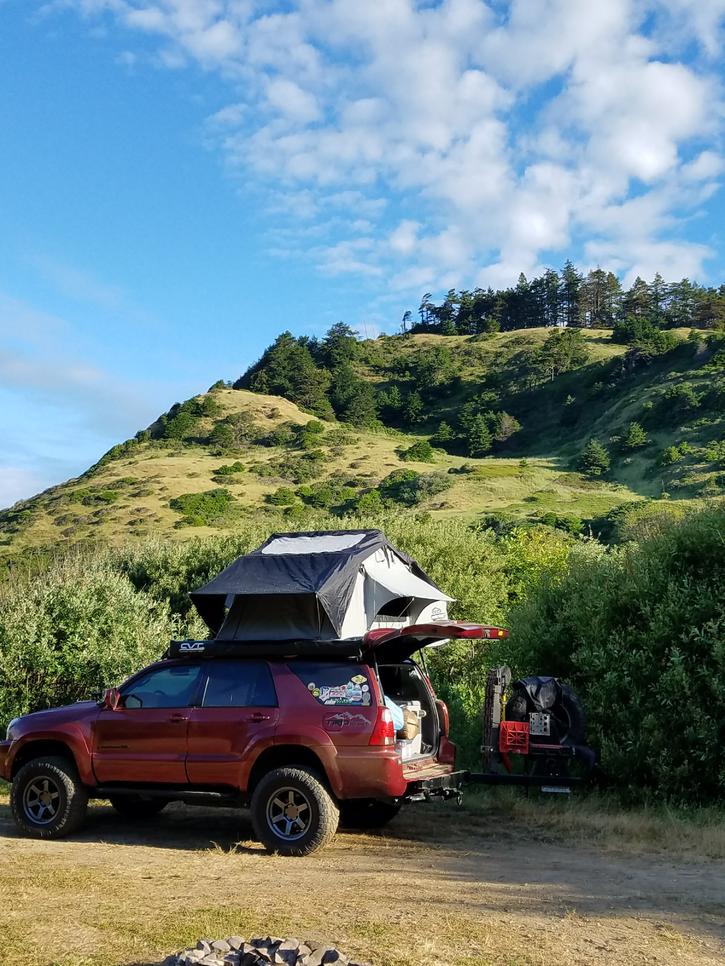

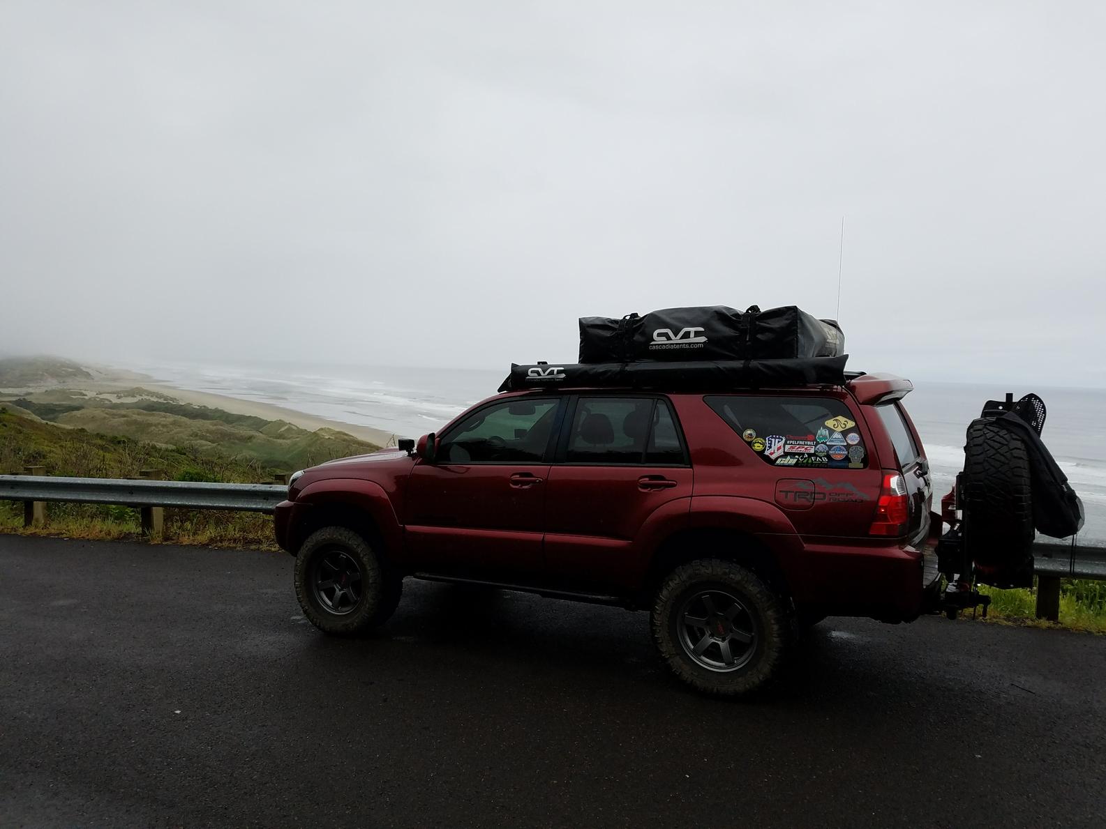

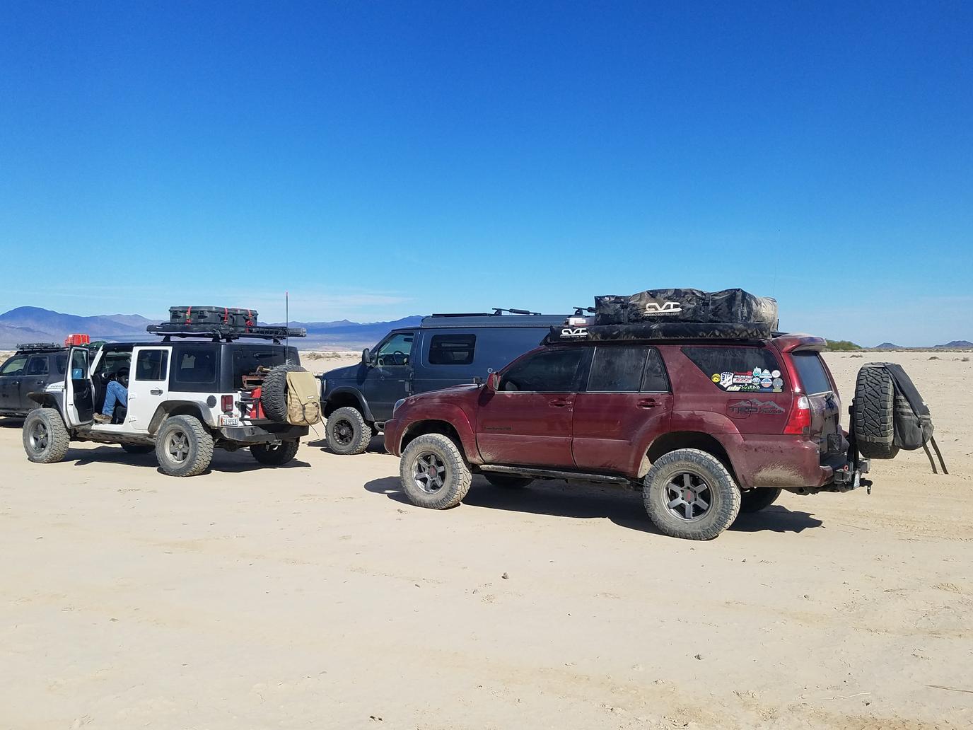

Here are some pics of mine. HOWEVER, I have had mods done to mine. I had him bring the tire in slightly and angle it. I also had a 5lb propane tank holder added along with a bar that allows me to hold my Treds and Krazy Beaver shovels (2nd pic). I love it and haven't had any issues going offroad with it. I'm not a super rock crawler so I'm not too concerned with aggressive departure angles. Plus...I can I keep my stock tow rating which is nice. I will add, the thing does NOT wobble at all. It's a pretty damn cool design. The 3rd pic was it off the shelf (Mojave Rd.)
Edit...to add, I'm running Icon Overland 3" Springs and Remote CDCV Shocks in the rear.

Look at post #41. I mounted a propane tank holder. Pretty sure a welding shop could mock up something for rotopax holders. I put mine on my roof so I opted for propane holder instead.
And yes...it could go between a 4runner and Sequioa as long as after you do the mods it has clearance. I drilled an extra hole in mine to get it closer to the hatch and had the shop cut and reweld the tire mount so it's angled a bit more and closer to the hatch.

I still love mine. Mine has some wobbling but because I've had mine for a long time and a lot of extra weight. I talked to the owner at Overland Expo and told him what I added. He loved my ideas and he said that if I got enough people he would even entertain adding some options (custom) like I did. He doesn't "recommend" what I did as of course it's modifying a product but said it would hold at least 200 extra lbs. I'm pushing it when I have it fully loaded. But he said if I call in and ask for new bushings they will give them to me. I have the first version and I can tell you the second version has some ideal upgrades (structurally) I wish mine had, but I would essentially start over. They were great to talk with and would definitely do biz with again. Do it man!
