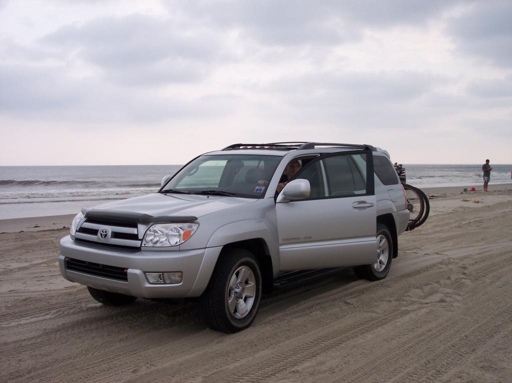

Anyone ever used these in place of your stock low beams and fogs? I have a 2005 Toyota 4Runner limited and looking to replace the stock low beams right now to a whiter light, mainly to increase visability and to look a little different than stock. I don't want to pay the price of PIAA and I want something that lasts long. I've tried the "walmart" stock (Silverstars, etc) and they did not last long. About 1 year and they're done with.

Never heard of those lights, but I just had to comment on how horrible the 4Runner would look with whitewall tires on it.
Yes, I know that your pic looks like that from driving in the sand, but still....it looks almost like whitewalls on there! LOL
Funny...
You know, I did not think of that with the tires looking like that. lol. It does now that I look at it! That's the new look on the 4runner. lol.
