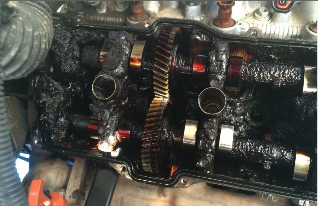

Well I knew this was gonna happen. Short back story on this before I start taking heat for this truck. I bought this truck with about 195K on it and have been putting on a lot of miles since this is my daily driver and I drive a lot for work. I've been having a good oil leak somewhere and I think I traced it back to the valve cover gaskets and the cam plugs. Seeing how this truck is over 220K miles on it now when I bought it with 195K miles, I figured its those items probably have never been replaced.
So today I get working on it and I just took the driver side valve cover off and holy hell! talk about sludge! I had a feeling I was going to find sludge but damn that looks like a mess. Im not sure if these gaskets were ever changed, theyre a little hard but in need of replacing. Even the screws hold the covers on were loose, so Im pretty confused.
Anyways, since I have the covers off now, what is the best way to go about cleaning the stuff out? Some of it is hard and some of it is still gooey.
I would manually scrap off the sludge on the valve cover but be careful not to crack it or break it. You can try using some carb cleaner or other solvent to help scrub the sludge off the cover.
I would try doing 1500 mile oil changes with a healthy dose of marvel mystery oil in the oil. It will slowly break up the sludge without plugging up the oil pickup screen. You'll want to use a decent synthetic oil also, it will help to slowly scrub that crap away.
Look for some BG109 and do it every short oil change. MM works too it’s got a lot of mineral spirits in it But if you buy the BG product you won’t use MM again to desludge.

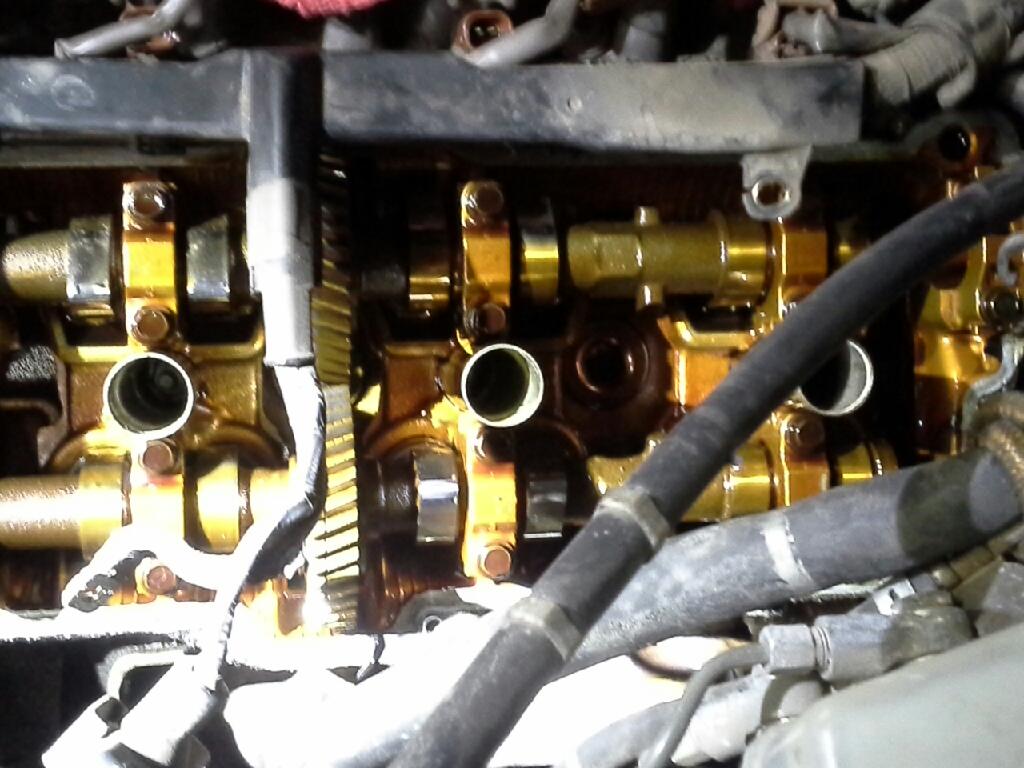

Leaking VC gaskets is probably the most common issue and yeah loose screws just as common. Do as other said, slow and easy does it, top internals look pretty good though, considering the VC condition (pic of mine for comparison). Luck and enjoy the Runner. :cowboy:

The valve area of your engine doesn't look sludged up at all. Looks like you got to it in time. Personally, I'd stay away from magical mystery miracle products that dilute the motor oil with solvents. Doesn't make sense to dilute the lubricating properties of the oil to me. YMMV, as always. Added photo of what a sludged up valve train looks like in the 3.4. There was a worse one, but I can't find that photo right now.

ok so I just got back in and pulled off the passenger side cover and it was basically the same or slightly worse. I scraped off some of the bigger clumps of oil from the internals and vacuumed it out. I went over it and got pretty much everything that's loose. I'm gonna put it back together tomorrow morning and try whats been suggested.
I haven't done it yet, obviously, but would using seafoam at this point just be a waste or would I risk missing up the motor using it?

Why is the sludge removal so urgent. Step back a second. It ran good before you cracked it open. Why are you making life harder? Clean to cover. Ensure the pcv baffles aren't clogged. Use only an OEM PCV. Fill with synthetic oil and keep driving it. The sludge will go away slowly and safely. There is a risk even with MMO. Try Pennzoil Platinum. It turns dark very quick compared to many oils (ex. Mobil 1) on sludged engines.
That sludge is honestly nothing.
