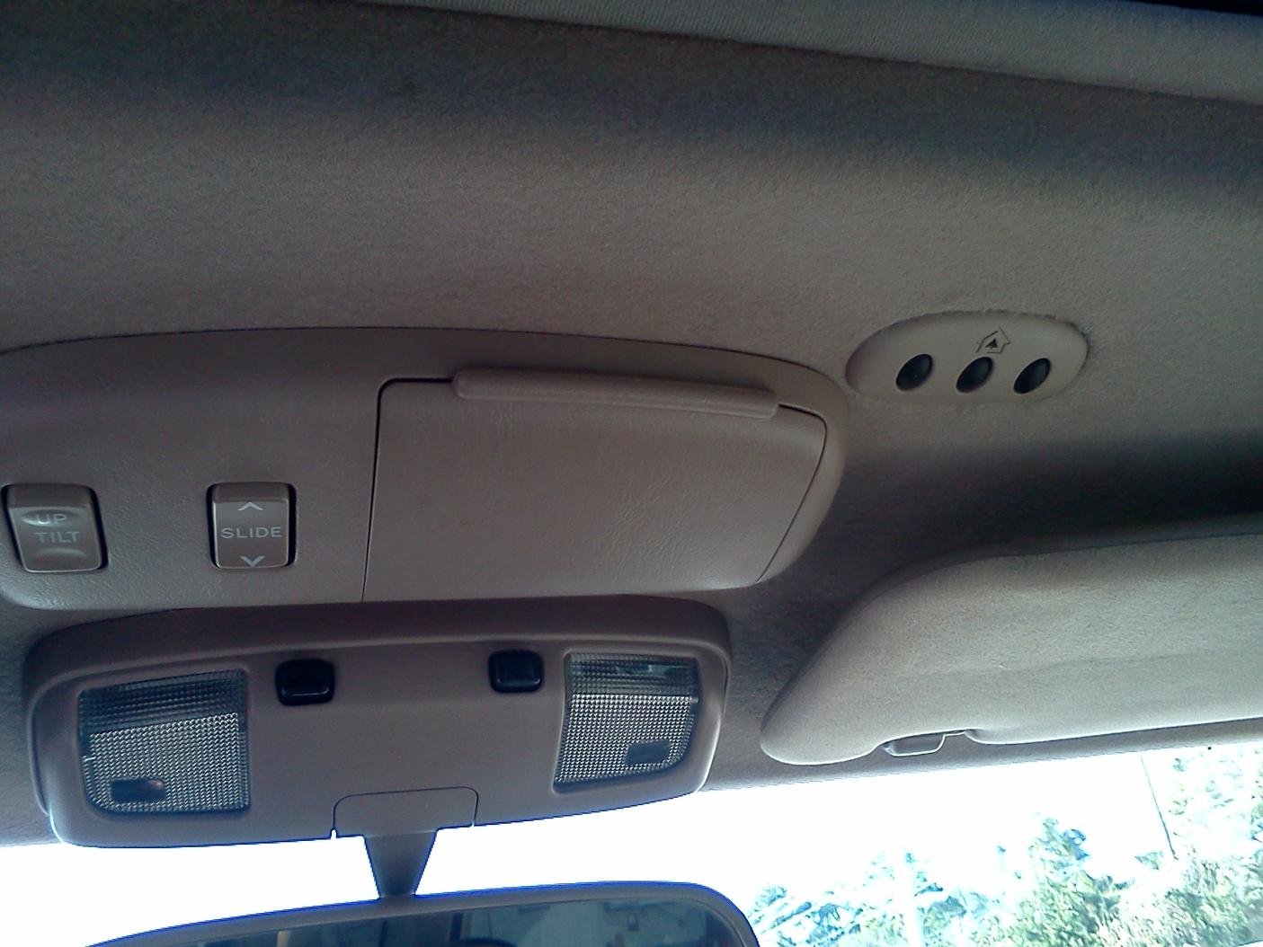

I know this has been done but I thought I would share anyway. It was pretty easy. All I did was drop my sunroof controls and light/mirror, measure and cut a hole (peeled the headliner back a bit first to over lap the cutout), wired it to the constant 12v on the mirror light, and grounded it to one of the mirror bolts. I did take pics but none turned out well as I got impatient and did this mod in the middle of the night. Got the rolling code Homelink off Ebay for $15. Cheaper than replacing my broken Chamberlain controller at $29 with a much cooler result...:bluejump:

Looks good. This is a good option for those who don't have the 99+ roof console or those who want an FMU.

Yeah I wasn't into the roof console swap, think the cutouts for the sunroof switches look goofy. So thats why I did the homelink thing.

Just curious... why did you mount the buttons on the roof instead of in the overheard compartment to the right of the sunroof controls?
I like the mod, I've seen pictures of it done both ways. My 97 Limited doesn't have a pre-cut slot in either area, but I'm very interested in doing this mod. Which mounting spot do you guys recommend?

The sending unit is rather large so there are not many places you can mount it. All you see are the buttons, but the rest if it is a cube that is 2.5"x2.75"x.75".

I liked the more "factory" look mounted in the roof. I had a car that had it like this before. And all I had to do was cut a hole in the headliner and the board instead of trimming all the plastic. It took some maneuvering to get it in but I think it was worth it for the clean look.
Were I to do this mod, I would use switched power for added security. That way if the vehicle were parked outside, one would not be able to open the garage simply by breaking the window and pressing a button. They would have to supply power to the unit first.
