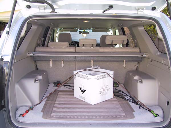

Can you post a picture that is not so zoomed in. Like a wide angel where you can see the entire interior.
Sure. I'll take another one when I get home tonight. I guess I'll have to take one from the back with the tailgate opened to capture the whole interior.
Here is another I just took from the back.
