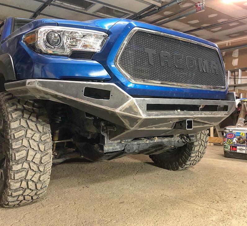

I built my front and rear bumpers, roof rack, ladder and motorcycle carrier all from scratch.

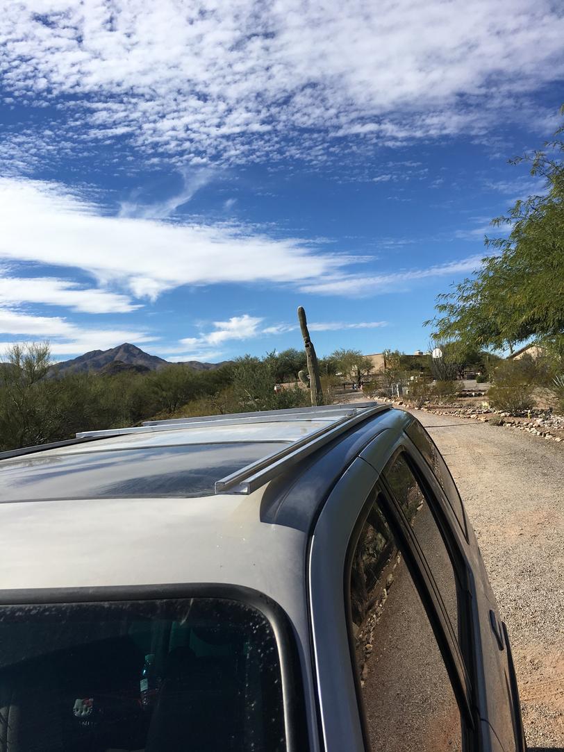

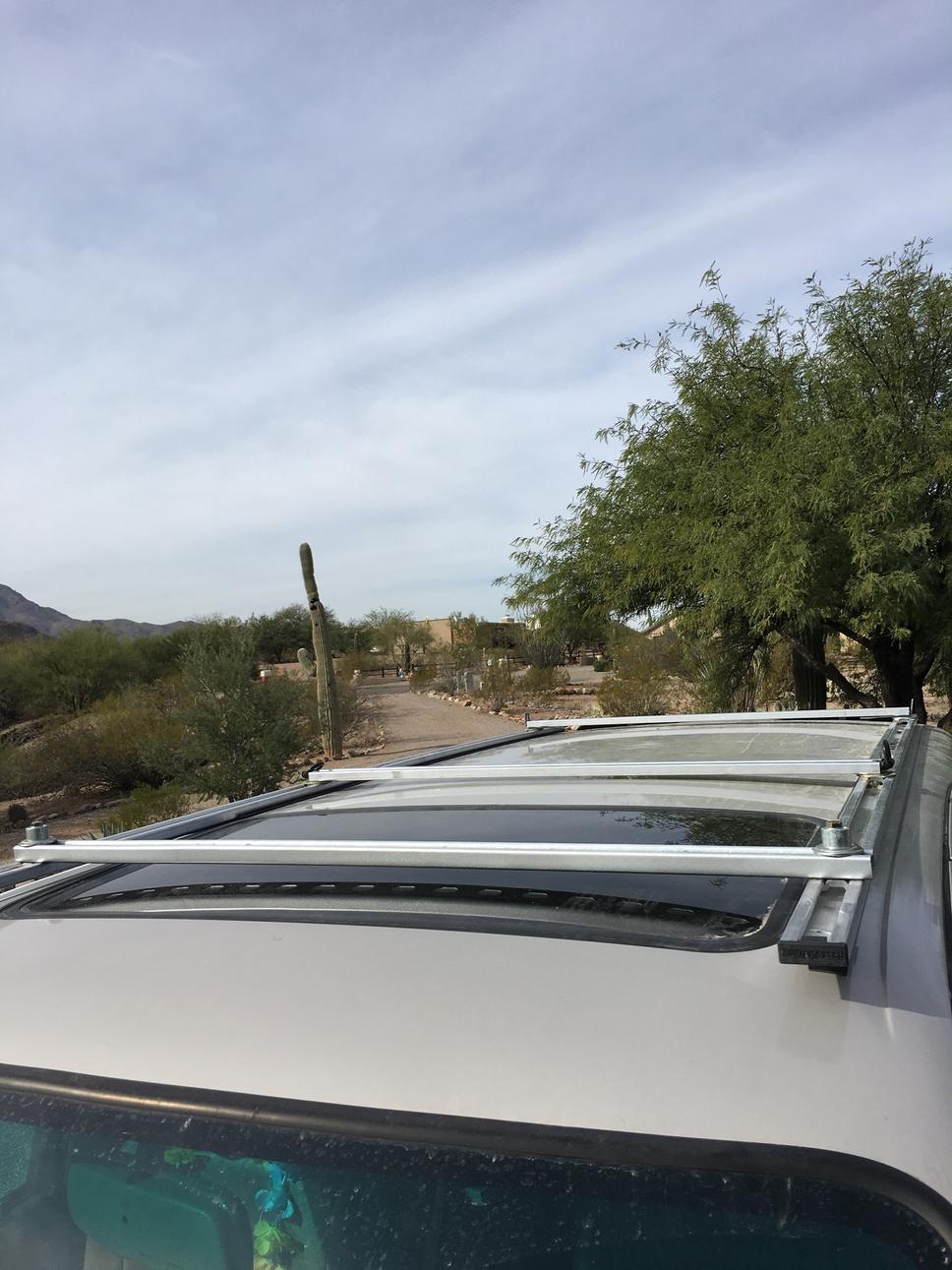

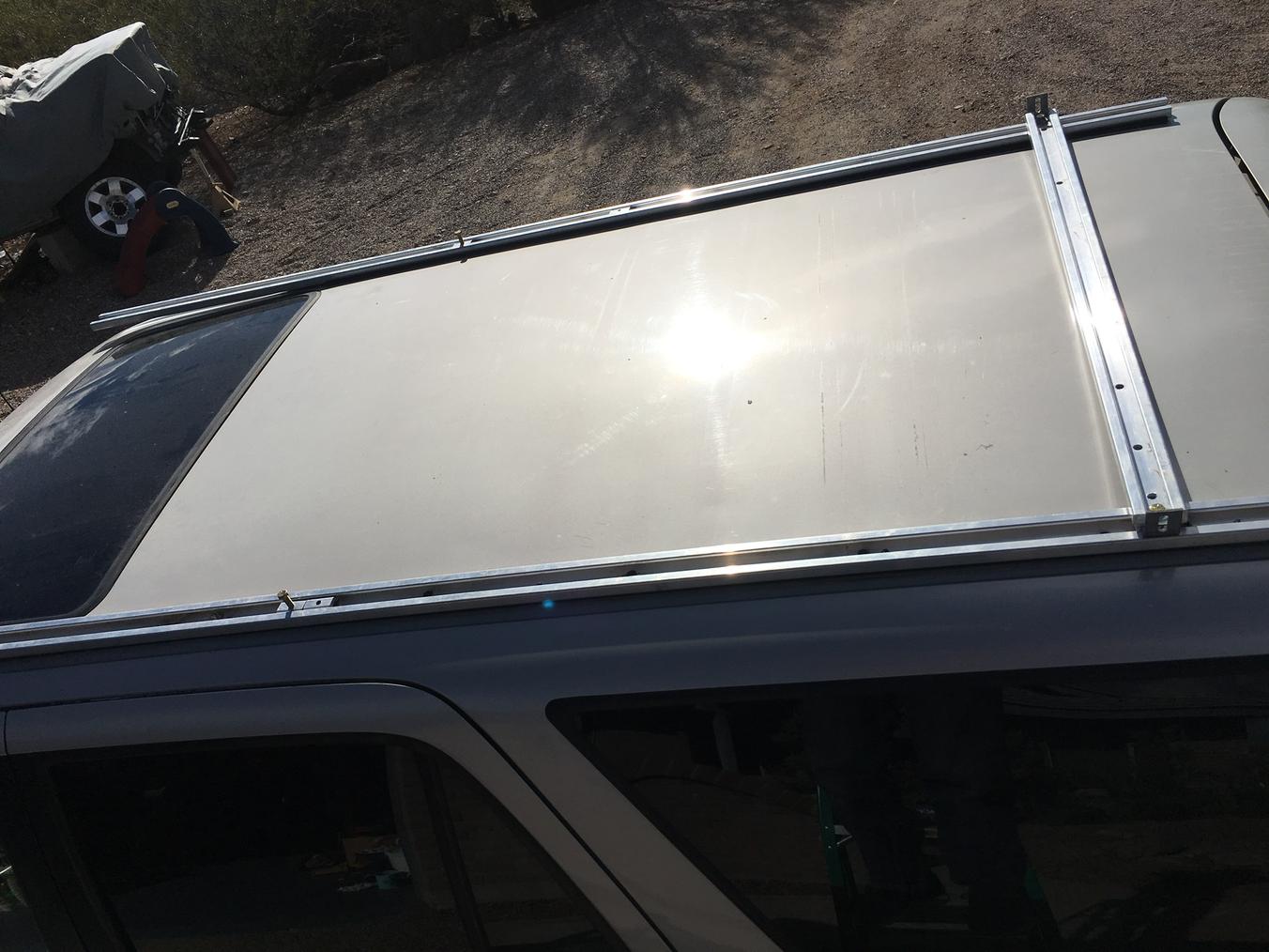

Roofie rack

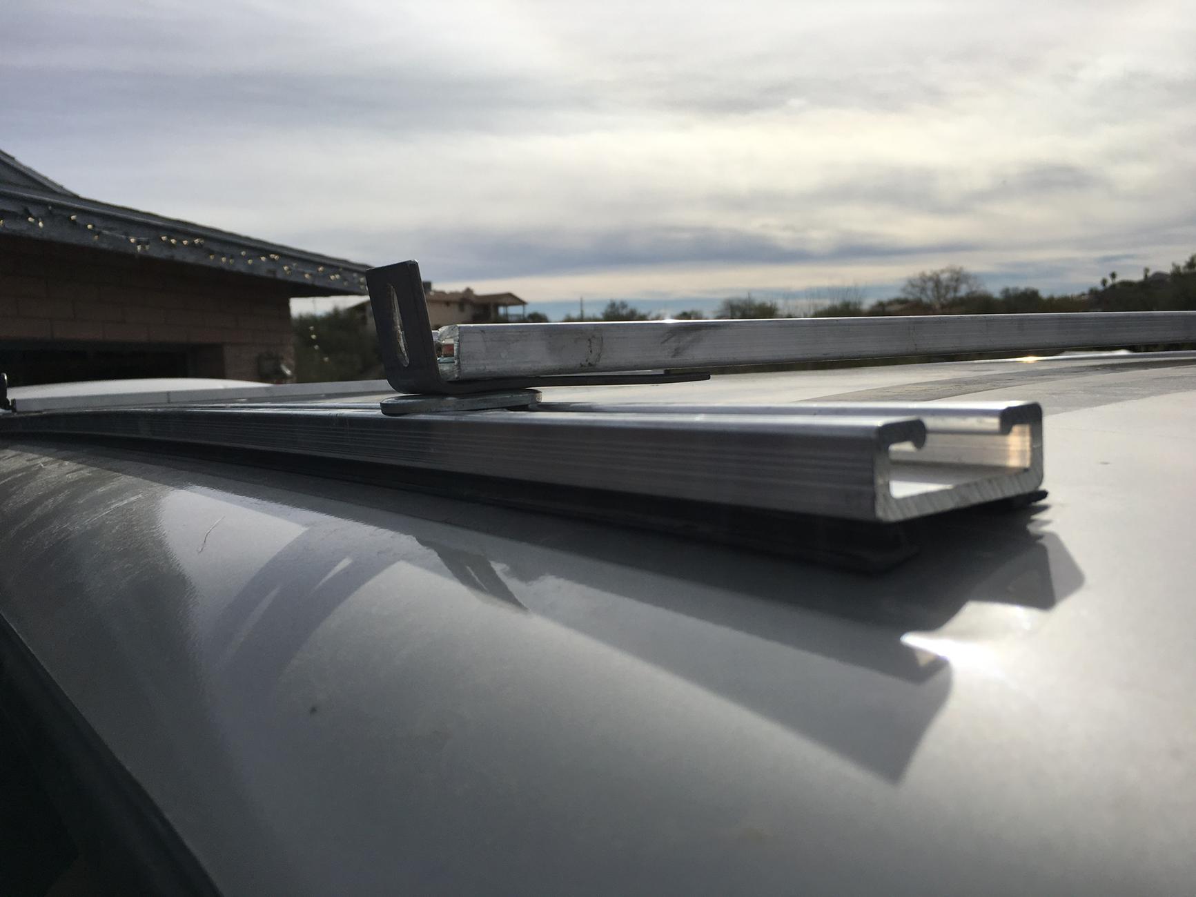

Not finished, still needs a platform surface. Aluminum c channel strut 1-1/78x13/16 bolted to factory mounting holes. Very front bar is steel uni strut of similar size. Scavenged black plastic runners from a long racked vehecile at salvedge yard. The aim is to have a platform up top able to mount a basket if needed. Also adaptable. Light weight. Not leak. Light rail. Tactical hippie camping spot..... Basically to extend factory rails and reinforce over sunroof to have a rugged, multi purpose, flattish area to hold cargo or sleep. I still have to bolt down the front, get ss hardware and paint, plus find a suitable platform material. I'll get better tie downs for the rear and lights all around......
So far wind noise is low, but if I build a basket for up top I'll have to see. This hobby(lifestyle/obsession) is slightly beyond awesome. This the general idea, minus decking

Till I anchor the fronts down, this is it. Low, light, modular and strong.
