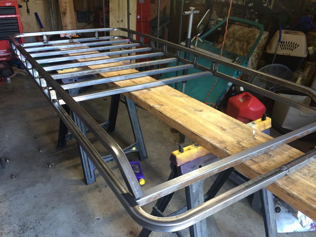

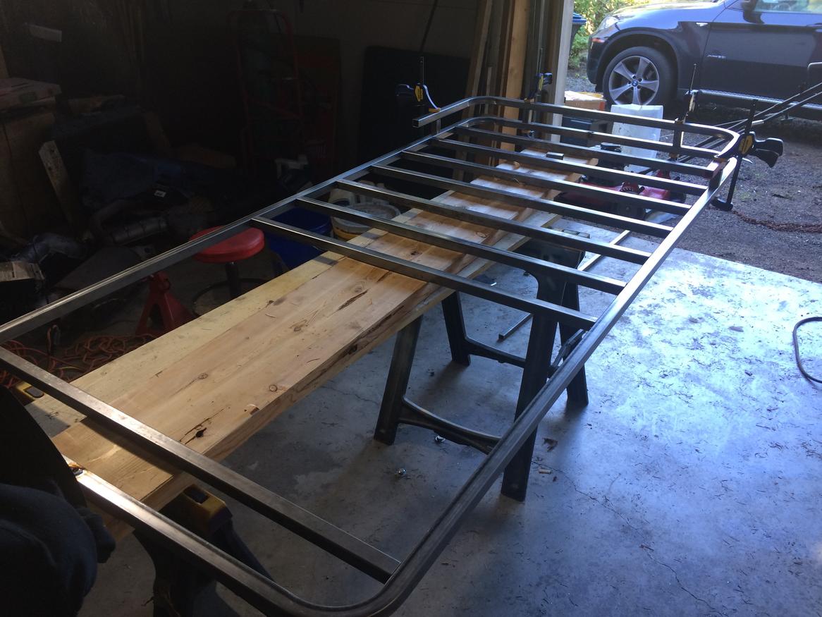

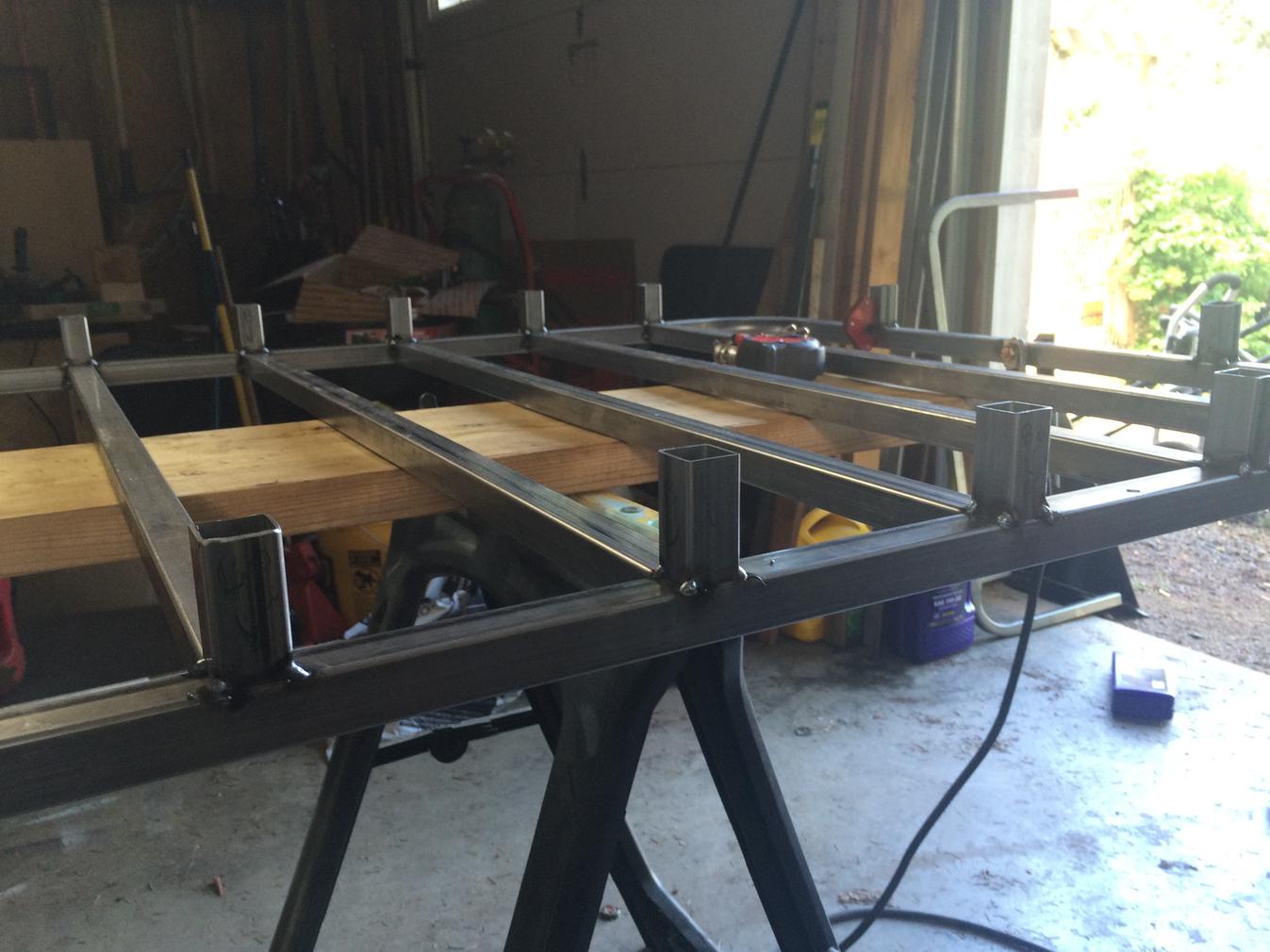

Just a little roof rack. 90% done, I'm gonna post a build thread with all the photos, specs, dimensions, and Build Plans when I'm done with the fab.

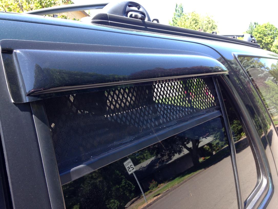

As featured under the heading of " my 4 dollar window screen"
Basically it's a piece of gutter screen cut so that it fits into the groove of the window on the top side and has a channel that the window slides into one the bottom side.
Do you have a link to the actual product? I've never seen this kind at a home depot

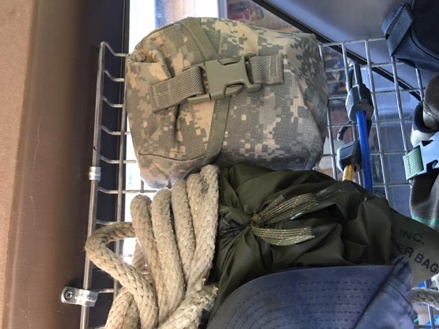

I made a molle rack out of an old shopping cart. Needs paint then dirt.

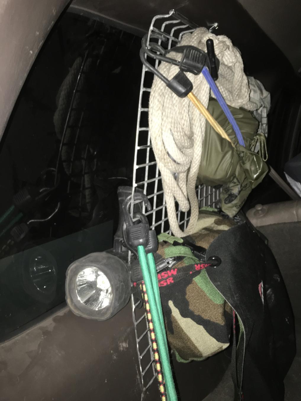

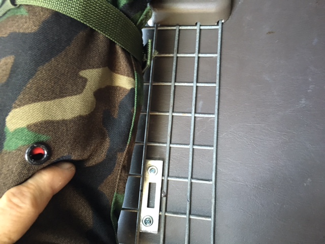

Hey, just update and pics. The top two straps are need to be two hole type for more strength , that will bee done after paint. Otherwise I'm happy how it turned out. Pre drill and use pan head 1-1/4 metal screws. I checked on my parts truck to make sure I didn't hit wires or such. Homemade is the best
Do you have room to get your hand behind it to clean your windows still? Looks like a great idea!

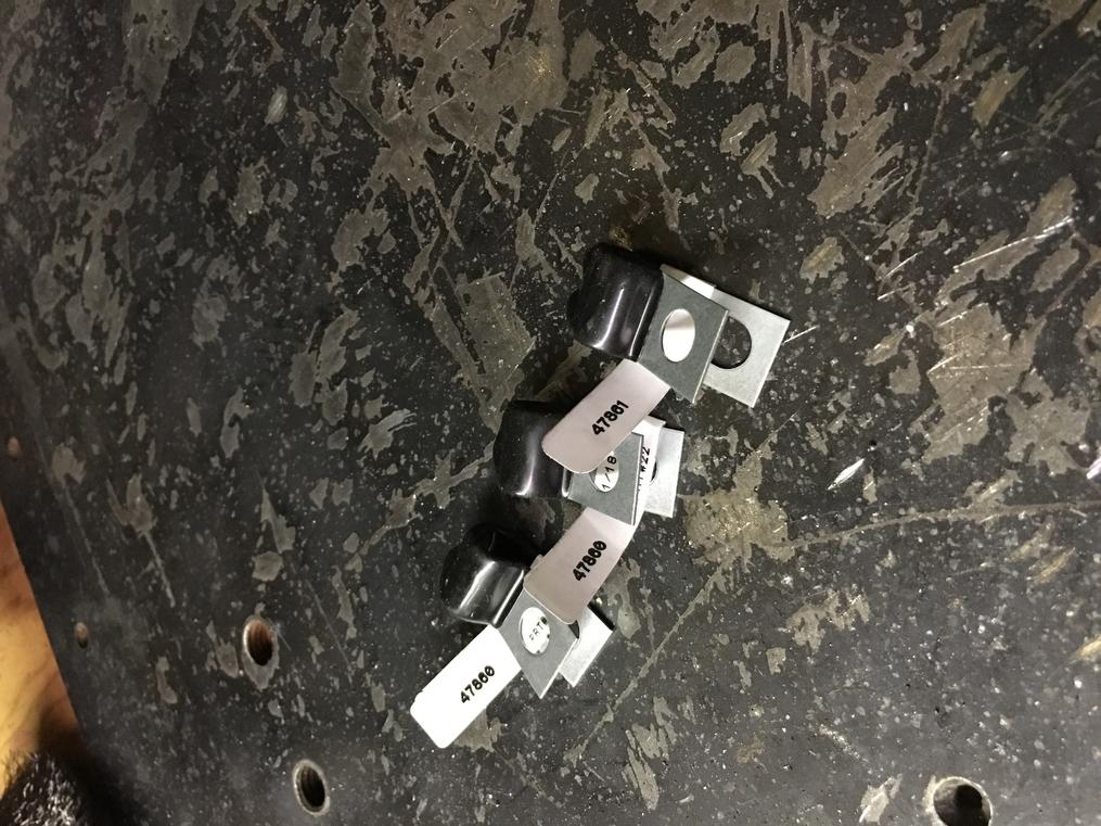

Yes, but not much room. Just a few screws to remove. Instead of two hole style, I'm going to try these coated tubing straps.
Good thinking. I use those at work at times. If you get the right size, they hold tight so no squeaking or shifting.
Though if you just use screws.... After a few times of removing them they may not stay tight. I was maybe thinking metal sheetrock anchors or small toggle bolts.
....dang, my list of "projects" keeps getting longer. I knock out 3 but add 4. :smashputer:
Good point, maybe I'll loctite the top fasteners and only remove the Lowe anchor points and swing the rack up to clean. All my screws are in the metal below the plastic. Trial and hopefully little error.
