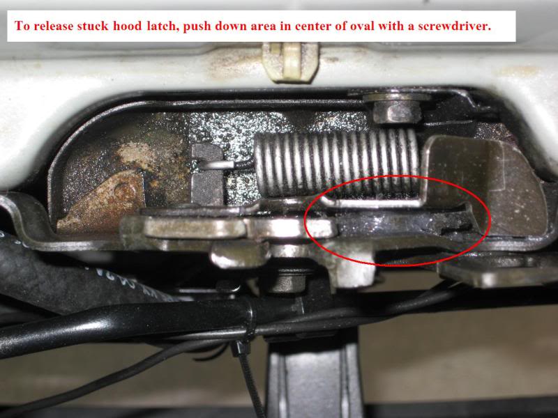

So when I pull the hood open latch, the pivoting arm on the latch mechanism gets stuck in place (the arm that the cable connects to in the engine bay). I can release it by taking a screw driver and prying it just slightly towards the engine, but this is really annoying.
Anyone else have this problem? I would rather not replace the whole latch mechanism.
The symptom of this is that when I drop the hood, it locks by the release latch, but doesn't lock all the way down, so it's as if I pulled the release latch (under the steering wheel) but havn't yet unlatched it from under the hood.
Try lubing it up with some pb blaster or similar. Then work the mechanism a few times to see if you freed it up.
Yup, same problem on mine, the culprit is a little lever that stays open and doesn't allow the hood to fully latch. The photo shows where to push with a screwdriver for a temporary fix, but also identifies the sticky part.

I am having what seems to be the same issue with my hood latch. I tried pushing down on the center as shown in your pic, however nothing moves for me. Is there anything else you suggest. I tried using a flat head screwdriver and moving mechnisim on the bottom that is connected to the cable. However it would only move to the right a little but not enough to close the hood completely.

Try pushing more to the right side of the part indicated in the circle.

I broke the spring in this picture (i hope that is all). Is there a diagram that I can follow to fix this?

Thanks a bunch, guys! T4R.ORG strikes again. This has been a recurring yet very infrequent problem on my 2000. A mechanic down in Santa Cruz helped free up the mechanism once, but I didn't see how he did it. It's so simple, thanks to the diagram offered up by Zcruiser! Mine popped right back this time, with very little force applied. I sprayed on some degreaser/lube, and am hoping it'll clean it out and fix the problem more permanently. At the very least, I know how to un-stick it next time it happens... Thanks again!
