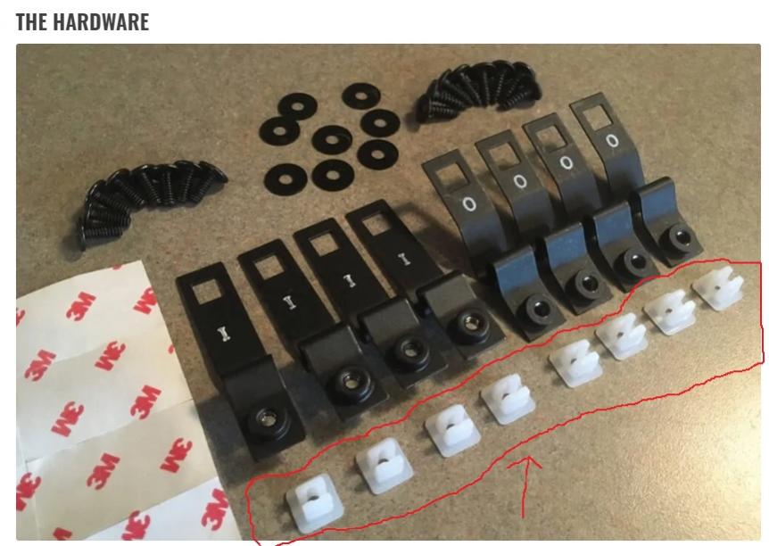

Technically, I don't really need the hood liner and assuming I just forgo the hood liner, I'm also looking for the plastic white plugs at the front of the hood that my avs bug deflector screws into. I've looked at several diagrams and for the life of me can't find the part number -does anybody have any clue what part number the white plugs circled in red are?

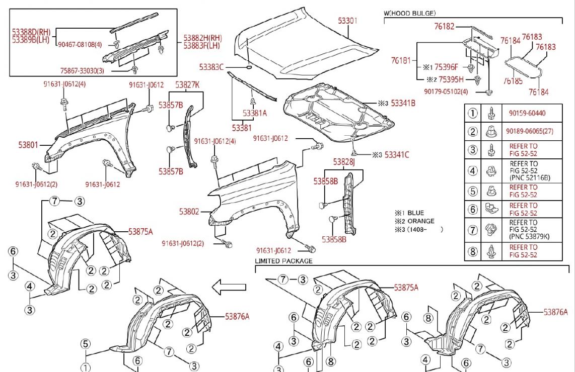

I've also enclosed the hood diagram as well. I'm slowly googling through all the numbers but figured to touch-base here in case there something critical that I've missed. Thanks in advance!

Need help. My ignorance assumed I could buy a TRD hood, the insert, and just swap some bits over from the SR5 hood to the TRD hood and call it a day. I bought a non-painted + primed OEM TRD hood from a private sale and it has nothing in or on it. It's just the primed hood with no plugs or tabs or anything attached.
Thinking out loud, the hood liner would be different I imagine otherwise water will seep through the hood insert and be absorbed by the SR5 liner. Then it might sag and rest on top of the engine and prove to be a fire hazard. So, at the very least I'll need a new hood liner. Then, I'm sure there are mounting tabs the hood liner clips into as well as the clips -might be able to re-use some from the SR5. Anybody have any thoughts on any clips or plugs I need to buy ahead of time when I do the swap? Stuff I can't live without to make the swap happen since
Any suggestions on any other parts I might require would be appreciated.
I did the same thing. I purchased a TRD scooped hood, hood scoop, hood scoop hardware and new liner clips.
Every transfers over, but the hood liner clips usually break when you take them off.
Just make sure the hood scoop installation is complete before installing the liner. the scoop has 4 bolts and I think 3 plastic clips. Those clips were a pita to install as you need to apply pressure on the top side until the clips lock in place. You may need to gently push and twist the clips a bit so it clears the thickness of the metal and locks in place. A second person would come in handy.
