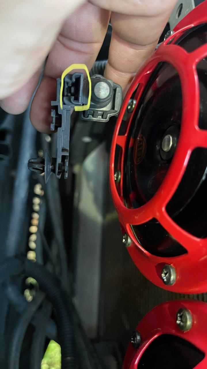

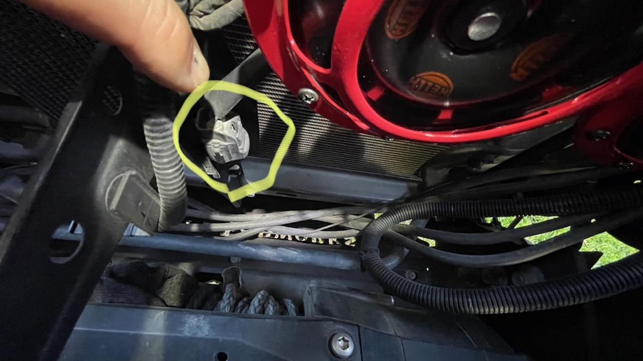

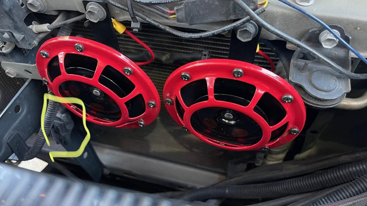

Horn stopped working, tried swapping out for a pair of hella horns this afternoon but no luck, fuse 13 is still good so not that either.
could be the an issue on the steering wheel itself or somewhere along the wiring, but i noticed something that looked kinda odd
the factory wires look to go a short run to a connector just down/left of where the horns mount (pic 1&2). it looks like mine is missing the connector/wire that should clip up from the underside? (3rd pic where i pulled the connect and flipped upside-down)
can anyone confirm or verify for me that something should be connected to the other side of this? and if so where it comes from? I can't find a loose wire hanging around anywhere so a bit baffled.
thanks

Looks like the mount tab for the temp sensor but thats a guess.
12 volts and ground = beep, beep.
Don't have that work your way back from there.
