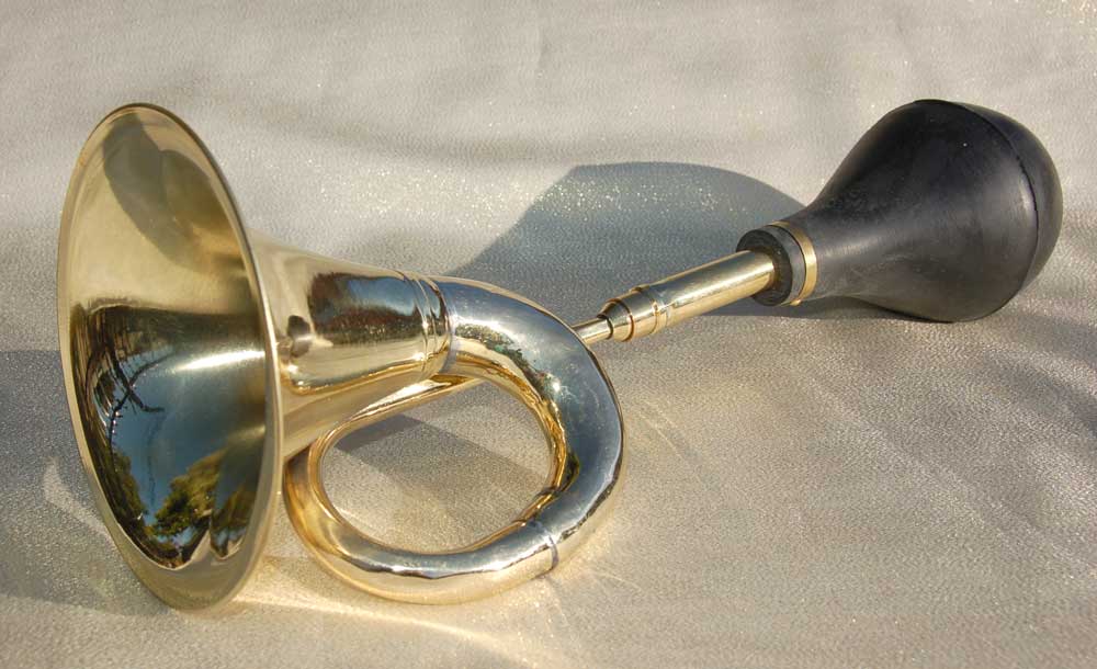

I just swapped my horns out for the side mirror mounting type. It gets the JOB done.
Approx. $5 at K-Mart.
