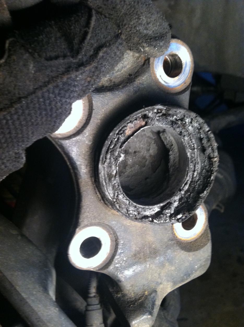

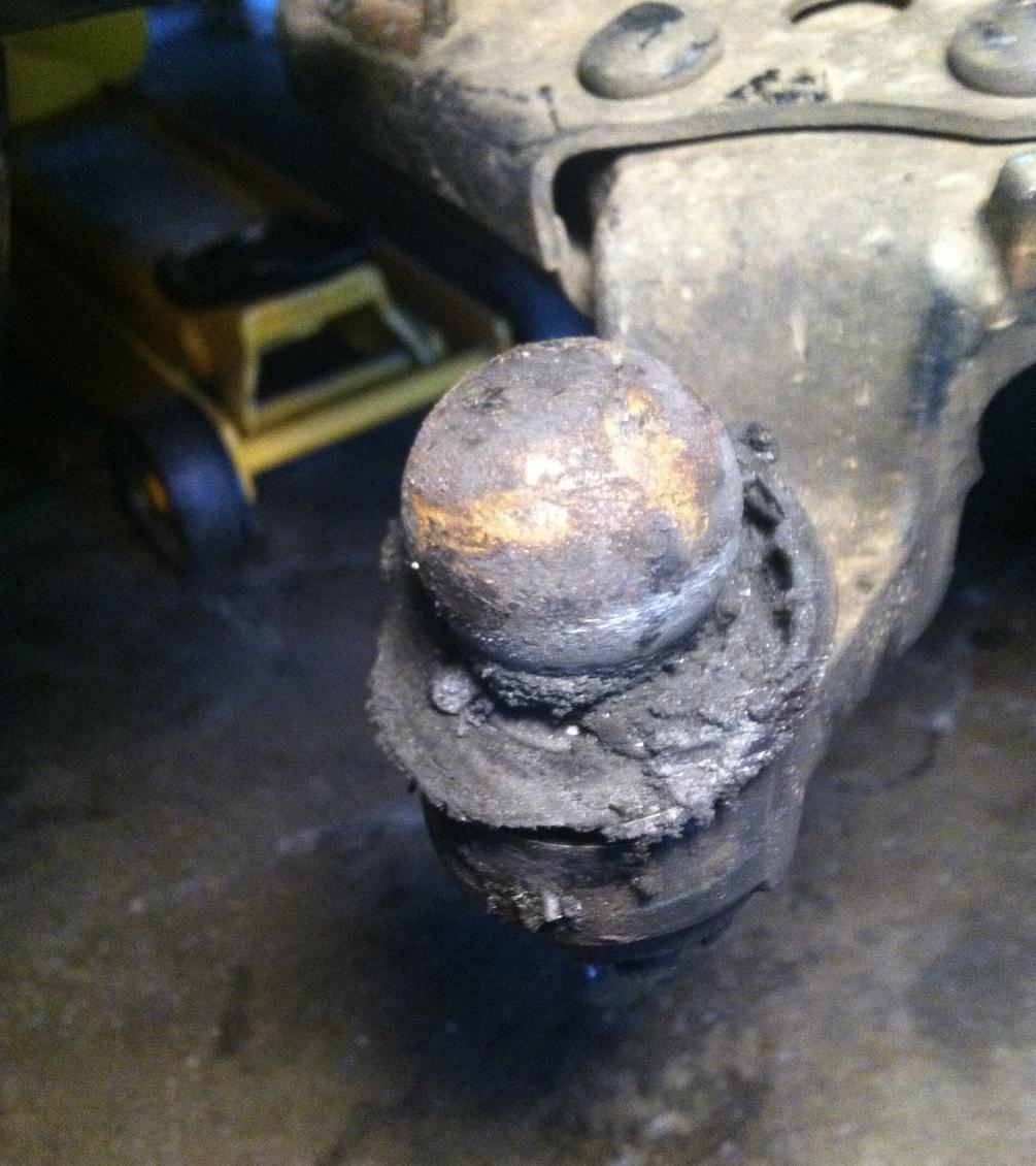

In my opinion and my experience with the same issue, the groaning is from the either the ball joint stretching out the cup and being very close to pulling through or from missing all the grease from inside the boot or a combo of the two. By the time this noise happens you definitely need to address it right away. I’m not surprised an auto parts store LBJ failed fast but wow, 3k miles?!

Welp after the change the noise has gone away so i guess it was 100% the LBJ!
Interesting as it had plenty of grease still and the boot wasn't 'torn'. The ring locking the upper part of the boot to the top of the joint had come off and allowed the boot to slide down.
Got OEM from amazon for under 100$ and now i can't remember why i didn't go OEM before... :bigok:
