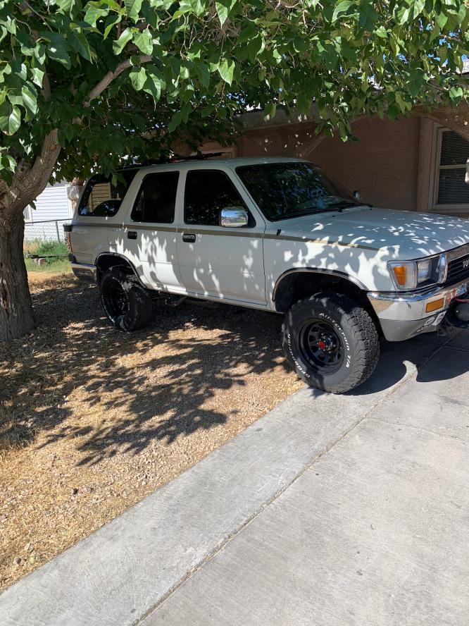

As for the 33x10.5 OP, I ran that size on BJ spacers, stock rims and the torsion fully dropped then just a touch put back on it. No mudflaps and never rubbed the body or stock bumper (just the inner fender plastic on the cab side that took very minor trimming) However, I did notice some rub marks on the inner tires from running lower PSI where contact was made at some point with the upper A-arm. Solved with 1/4" slip over wheel spacers.

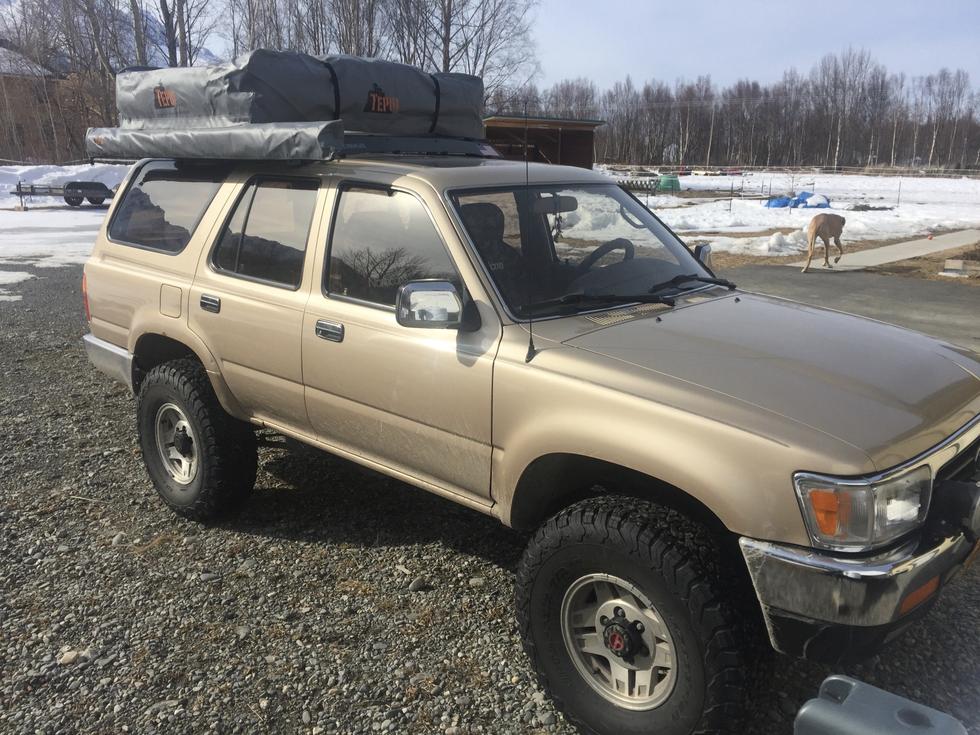

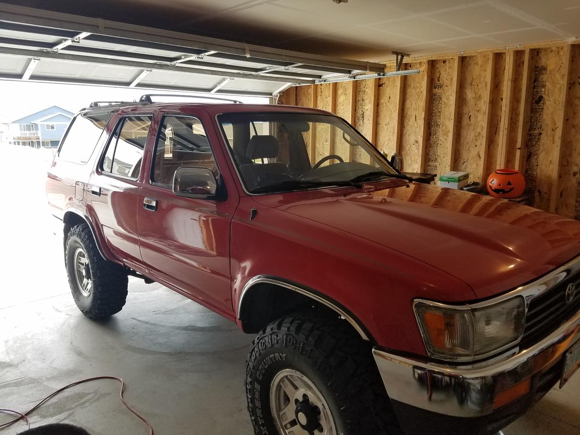

I have a set of 33x10.50 BFG AT2 tires on stock wheels and suspension on mine. No rubbing at all, but I think this also has to do with how much your suspension is sagging. As far as I know my torsion bars are not cranked. That being said I have yet to compress the suspension enough to see if it tucks properly.
