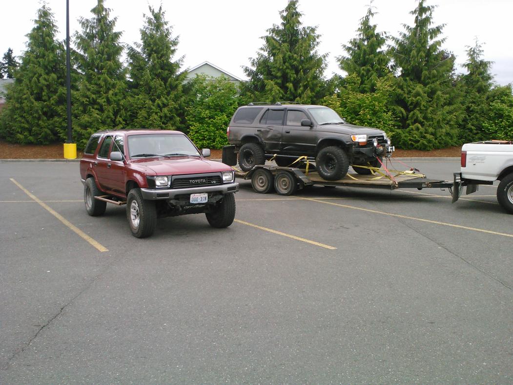

I've got BFG 33 all terrain on my 95 with no lift and love it. Just had to hack about 3" off the front corner wheel well. Its what you see as my avatar.

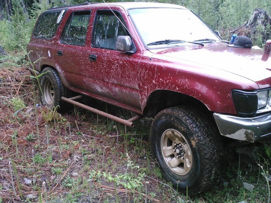

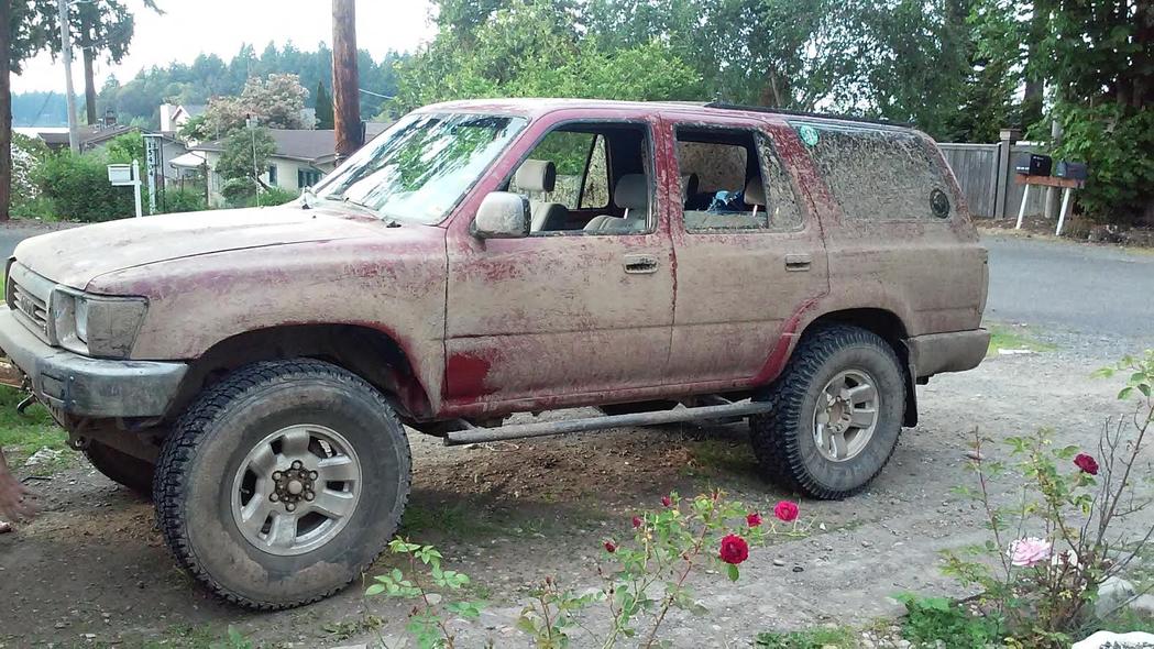

I had 33's on mine and wheeled it with minor rubbing. As stated above i did trim the corner of my fenders though In the last pic i think you can see where it was trimed

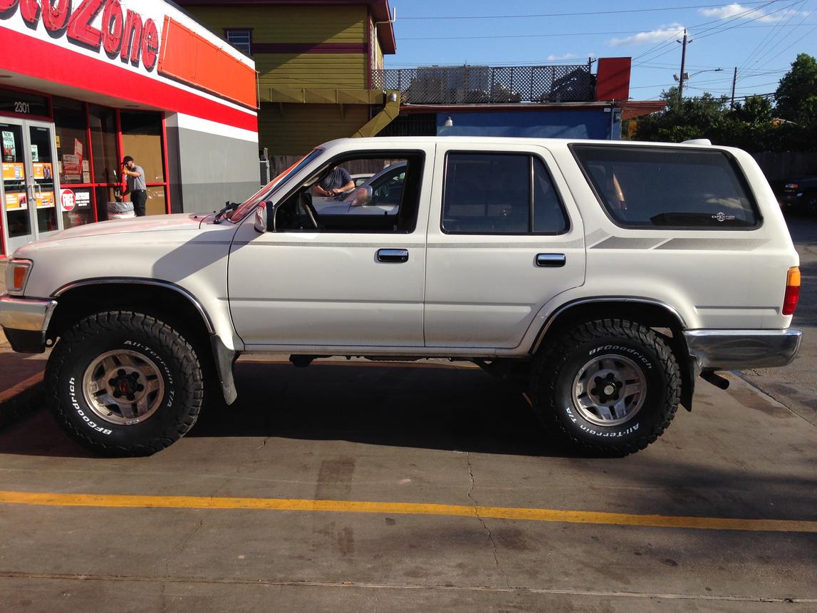

I have a set of 33x10.50 BFG AT2 tires on stock wheels and suspension on mine. No rubbing at all, but I think this also has to do with how much your suspension is sagging. As far as I know my torsion bars are not cranked. That being said I have yet to compress the suspension enough to see if it tucks properly.
