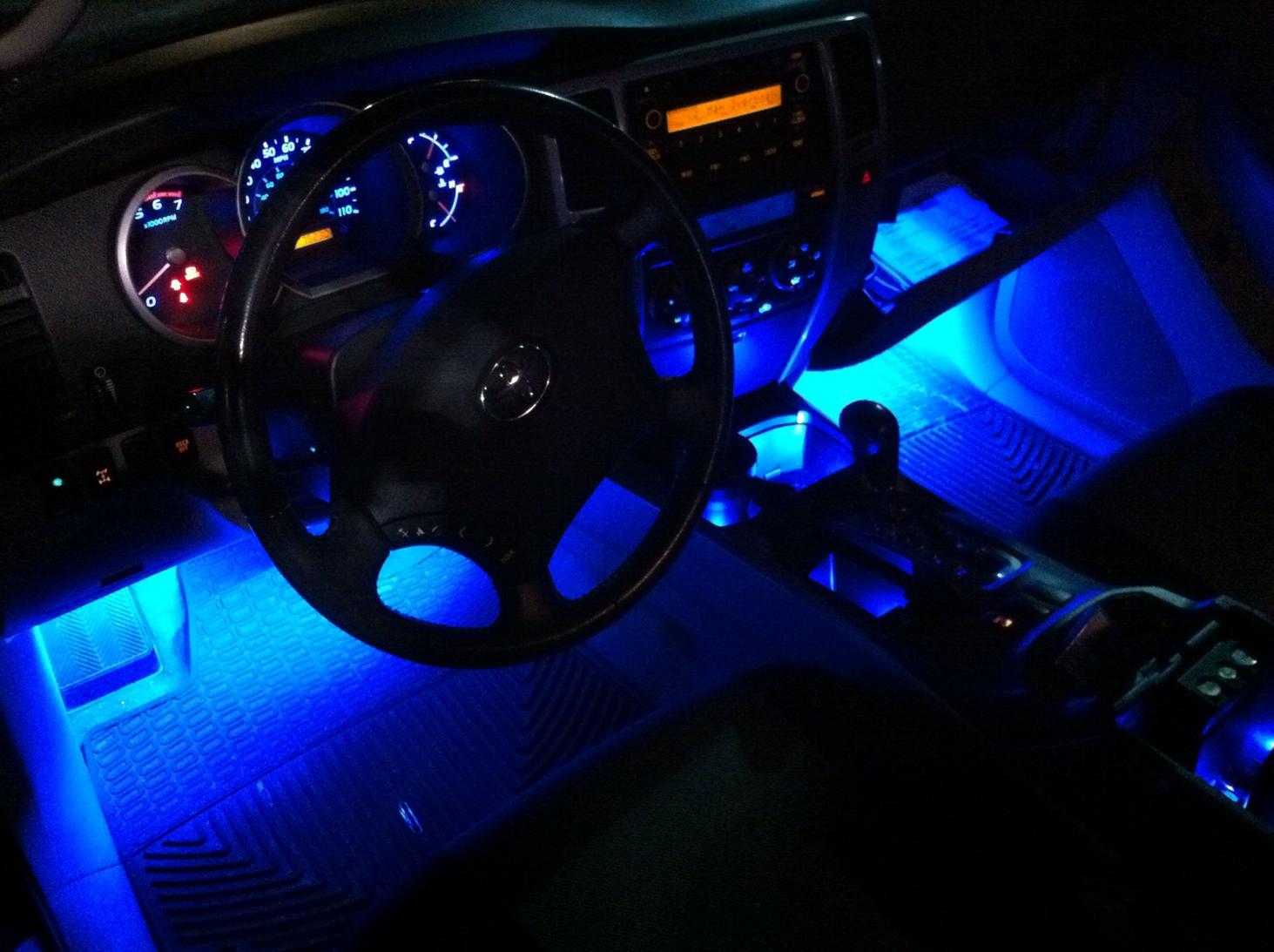

You can look into putting LED's in. Pick a color the lights are about $4 each or less. There is a DIY thread on this I have added about 30+ LED's and get lots of complements on the look. Use caution with white it can be a bit bright. I have even seen mixed colors and it looks pretty cool if done right. They install the same way the factory bulbs do.

Even if you don't change any colors I would look into replacing the lights with LED's they use less power and cost less.

Im curious your picture looks like you replaced the dash bulbs lighting up the tach and speed etc, is this so? I heard that you had to replace the whole dash in order to replace those bulbs, but if thats not the case i need to upgrade mine!
