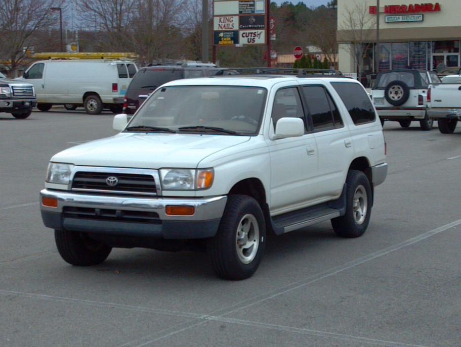

I've just bought a 98' 2wd SR5 with 150K and I'm wondering should I go ahead and add a separate trans cooler. The truck has been dealer maintained since and the original owners appear to have done just about anything the dealer recommended. It's had the timing belt and water pump replaced twice already and all of the other general maintenance items like plugs, wires, oil, air and fuel filters are all OEM and install by the dealer. I mean even when the factory radio died they had the dealer install a OEM Cassette/CD player. Actually, the main selling point for me was the BOOK of service receipts they had on it. The radiator doesn't appear to have been replaced although it's been serviced regularly and looks to be in great shape. As easy as it would be to install a good cooler I don't see why I shouldn't. I'd like to hear some opinions of experienced 4Runner owners though. Oh, here is a pic I took on the way home with it. It's about to get a serious detailing and I'll post some pics after. Thanks
