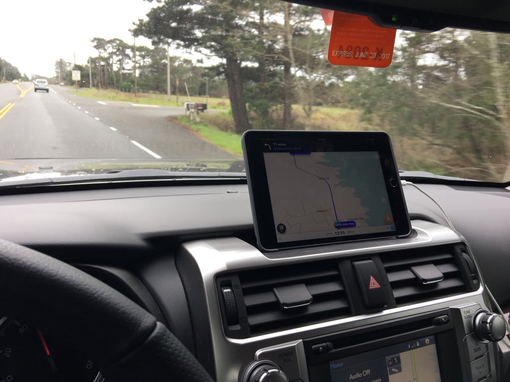

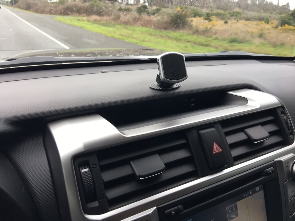

How did you mount your mini tablet?
Sent from my iPhone using Tapatalk Pro
I would of never thought double sided sticky would stick to that dash! Nicely done!

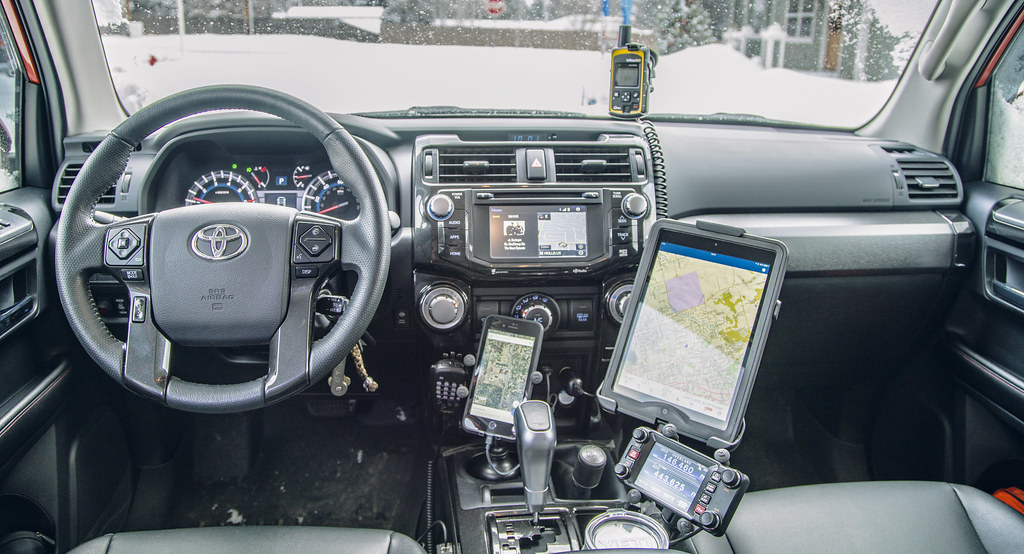

See post #3 of my build thread for more shots from different angles.
This mounting position works to secure a few different things, depending on the situation:
- My HAM HT,
- My phone (with the small x-mount)
- My Tablet (either with the large x-mount or the custom 7" tablet mount shown in the pics).
This way it is out of my line of sight to the road and the only thing it blocks is the temp knob, and I can reach around to get to that if need be.
Very solid, and minimal shake, and satellite acquisition is just as good as if mounted to the windshield.
The mounting ball is secured with 1/2" sheet metal screws that tapped into small drill holes I made in the plastic of the dash. There was nothing directly behind the plastic, so I was not afraid of damaging anything.
