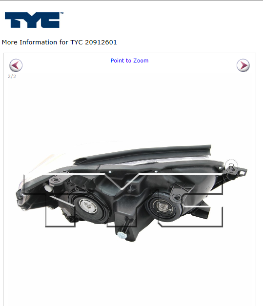

Adjustment screw not attached
I was able to adjust the headlight on the passenger side of my 2011 Trail Edition but the adjustment screw on the driver side headlight appears to be disconnected from the light since the light just flops around when I reach behind the light and push on it. I have turned the screw both directions using the philips screwdriver trick revealed in this thread (Thank you!).
Has anybody come across this problem and found a way to reconnect the adjustment screw to the headlight?
In the meantime my driver side headlight is pointing into the ground.
Sounds like you may need to remove the headlight assembly and see whats going on.
You should be able to figure it out then, you may need to order a assembly....IDK
Looked this up on rockauto, see the photo.
I see the adjuster in the photo...this should look exactly like yours......

Thank you, Saker. That is the one.
I was hoping for a short cut but I think you are right in that I may need to pull the whole assembly and even then it appears to be completely enclosed. I may look into upgrading the lights if I have to replace the assembly anyway.
