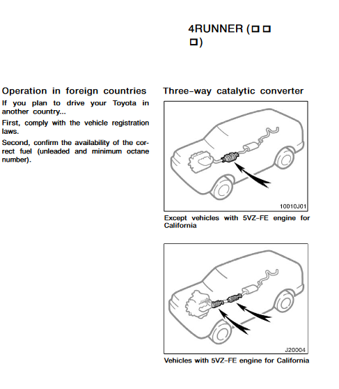

Turns out, its in the 4Runner user manual. It is in my 1999 4runner manual. Page 174. If you have 1 cat, its non-California. If you have 2 cats its California emissions. Mystery solved for 1999.
