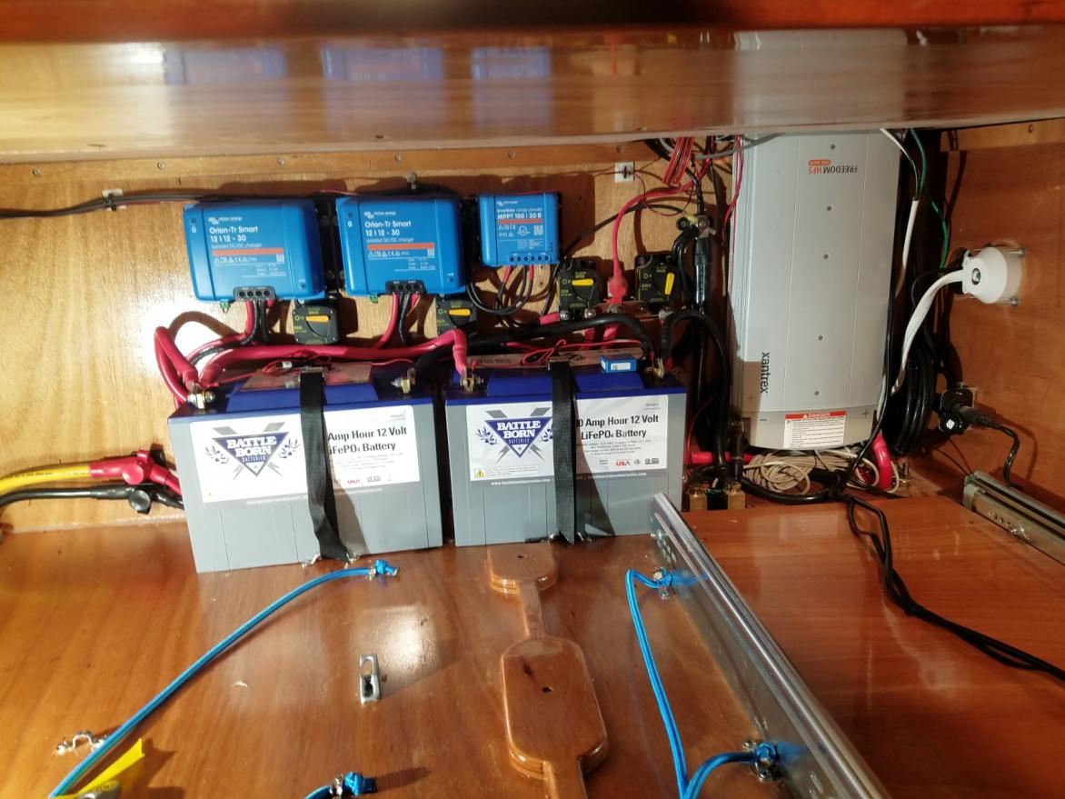

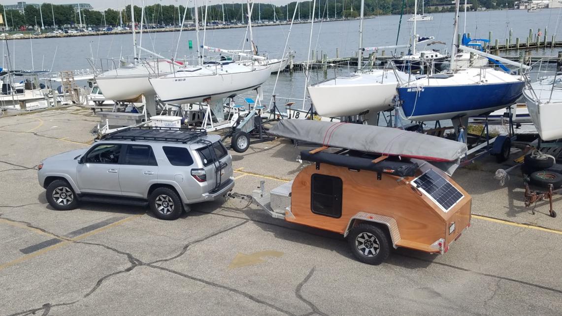

I am getting started on my project where I have a DC Power Alternator running through a CB and relay to an Anderson connector on the rear of the car.
The Alternator is installed but still have not found the perfect path to run the cables. My trailer has 2- 100 amp LiFe batteries and 2- 30 amp Victron Orion Smart controllers, and will be a 50 ft run, So the cable is quite large ( 2/O) and I still want to protect it .
Any Pictures?
the best path for your wiring is through the frame. inside will be best to protect it from the elements, outside too is okay and use a wireloom and zip tie it and make sure it's not loose anywhere. make sure it's not in the way when you need to do maintenance to the car.
I am looking at the thread and still do not see the answer to the question of what is the best path to run cables from the battery to the back of the car,
Any Pictures?
Thanks,
This is good direction, So far I saw a YouTube video of a F150 job yesterday. The cables are big and if done right could be fairly clean.
Before posting, I Put my T4R on the lift and took a 5 minute look and decided this would need some research and experience of others to do it the cleanest way possible. On my trailer I used stainless cable clamps and drill tapped machine screws into the frame for the power and tie-wrapped the ground to it, Keeping it inside the frame so it would never ground out .
