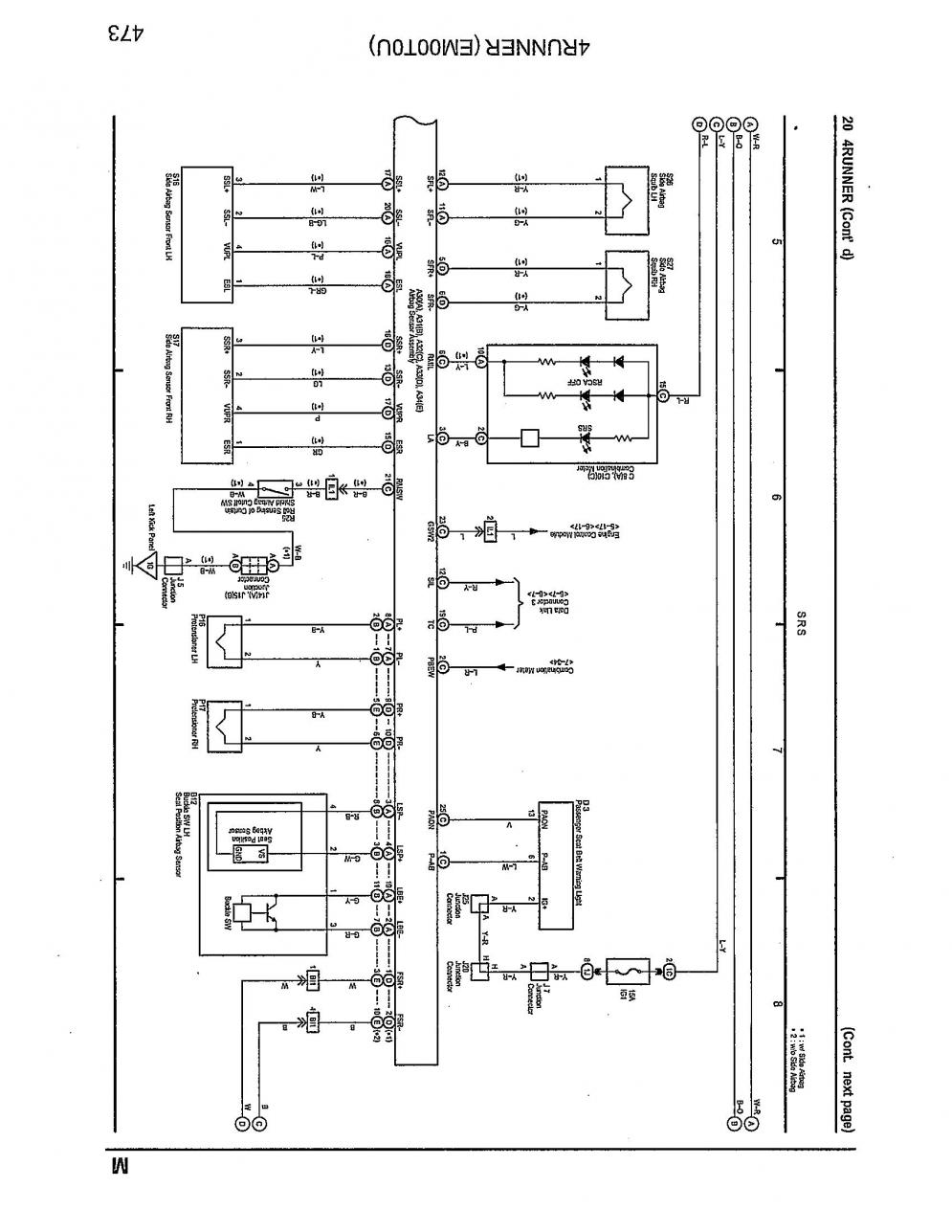

How do I test a seat belt buckle?
The passenger air bag light sometimes would stay "off" even when someone is sitting in the seat. By unbuckling and re-buckling the belt would, most of the time, turn to "on".
How do I test the switch in the seat buckle?

It looks like I can measure voltage or restistance at the buckle.
