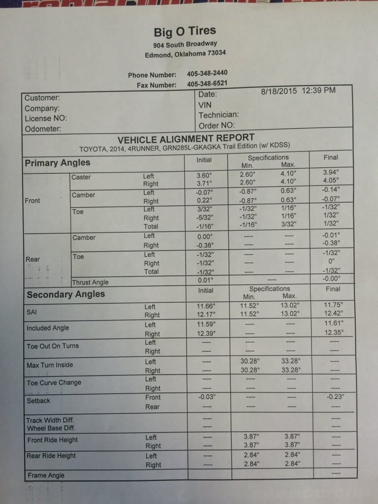

How do my alignment specs looks?
Stillbreathn
I'm running radflo 2.5 on all 4 with TC UCA. My front height is 1/2" lower than rear. Im running the skinny cooper st/maxx tires with trd pro wheels.
Are you asking in earnest? Everything is in spec, and that's always a good thing, as is having your caster on the high end of spec.
Totally, just making sure nothing can be improved upon. I'm having some cupping issues on the inner fronts. I was told it could be shocks or alignment so I had my shocks recharged to 200psi as well. I haven't had time to search the forum to see if anyone else is having issues with the tires themselves cupping.
The guy who recharged the radflos has extensive experience with suspension and he thinks it's the cooper tires.
