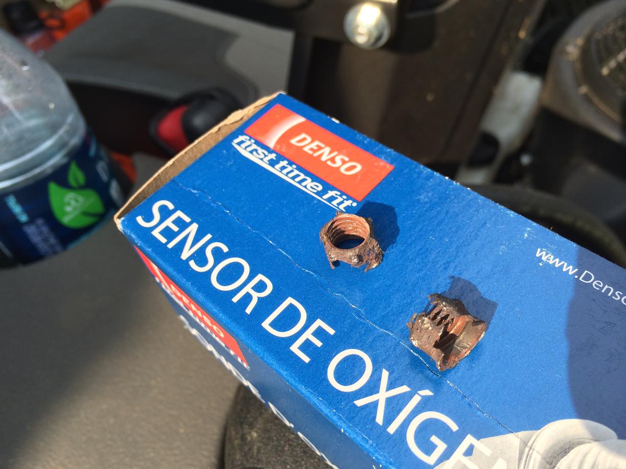

First, I hit them with lots of PB Blaster. I used progressively smaller sockets and banged them on with a hammer. (Cheap China set, not my S-K's.) Then I used a short pair of Vise-Grips--the big ones won't go in there. Alternating approaches got the nut fall off in pieces. Finally I cleaned up the stud with a wire brush.
Vice grips and PB Blaster got my rusty nuts off my O2 sensor a month ago.

I used CRC Freeze Off. Then vice grips on the lower one which was very nearly gone, just slow and steady trying to get get good grips and ease it off. I hammered an 11 mm socket on the upper one. It was very helpful and reassuring to have read this before-hand.
