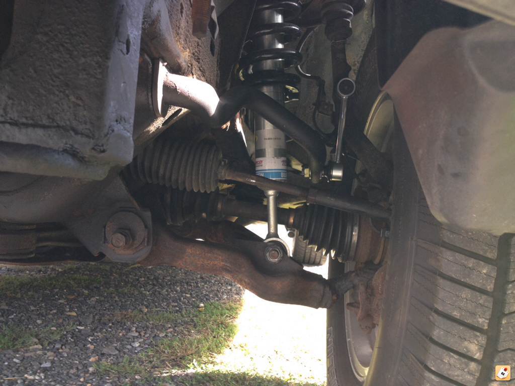

The same way you tell a mail truck from a femail truck, roll it over or lift its tail and have a look. If its got CVs its 4WD.
The op said he didn't know what a "CV axle" is, so telling him to look for one is kinda useless.
In that picture of the front suspension posted by [MENTION=128287]DAGNABIT[/MENTION]:
- The bottom rusty horizontal metal piece is the lower control arm (LCA).
- Just above the LCA, the thick round horizontal metal bar with two rubber boots (one either end) running to the center of the wheel is the axle. The rubber boots are the constant velocity joints. This is required for AWD, 4WD, or front-wheel-drive vehicles and is absent on rear-wheel drive vehicles (like the 2WD 4Runner).
The thinner horizontal metal bar above the axle with one rubber boot is the steering link. All vehicles have this in some or another, and it is not an axle. It does NOT run to the center of the wheel.

I often look for the front differential on different vehicles with 4WD. You can often see the drive shafts going both ways from the transfer case. Looking inside for the 4WD lever or dial is also an easy way too, but you can't always do that when you see a truck driving down the road. And remember, AWD is not the same animal as 4WD even though it may have the same physical parts.
