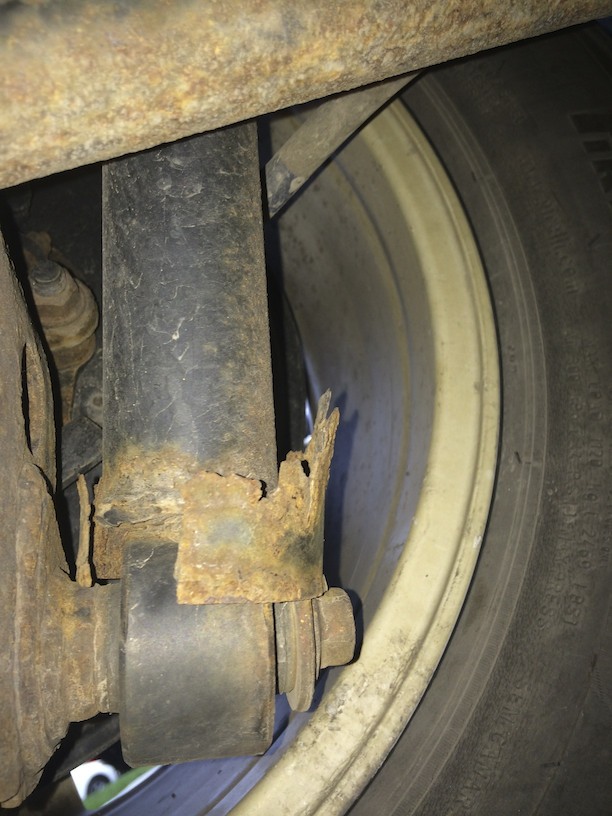

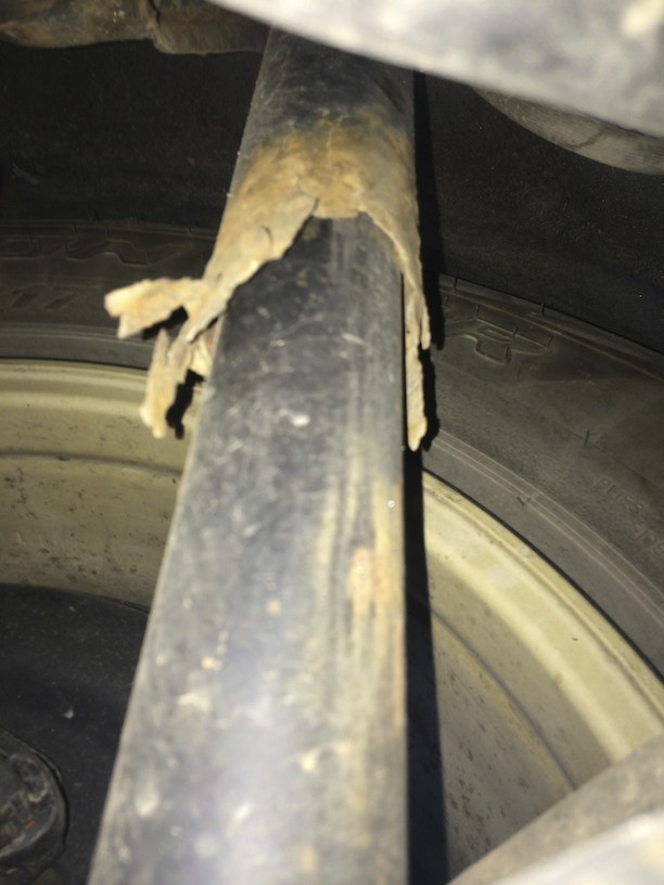

Im an am at 137,xxx miles on my 2005 sport and as far as I know xreas is still working, but is there anyway to test or assess the condition of xreas? I know that at some point it will need replacing, but not quite ready to do so yet. But while under the truck doing some routine maintenance I noticed part of the rear shock had sort of rusted off....anyone have some insight on this...obviously its not ideal but should I be seriously concerned? it looks like just a bit of piece of housing...
Needless to say my city loves salt

Your kidding right? I would get those off as fast as I could. What about the supporting hardware?
Just wishful thinking. I was pretty bummed when I saw that. I just had some "emergency" brake work done and paid more than I would have liked. The supporting hardware is solid. It has a light dusting of rust but not nearly as bad as the picture. The front two look fine all around. And the opposite rear is still in one piece but you can feel/tell that a similar thing is happening.
