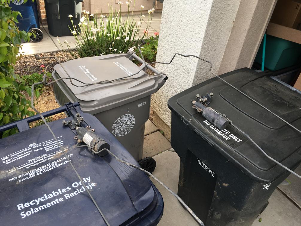

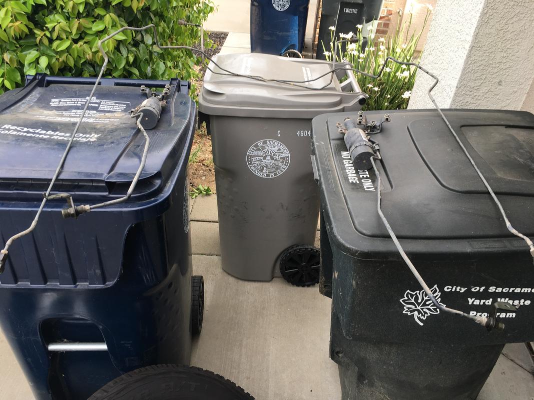

X-REAS removed, lines up 4 grabs

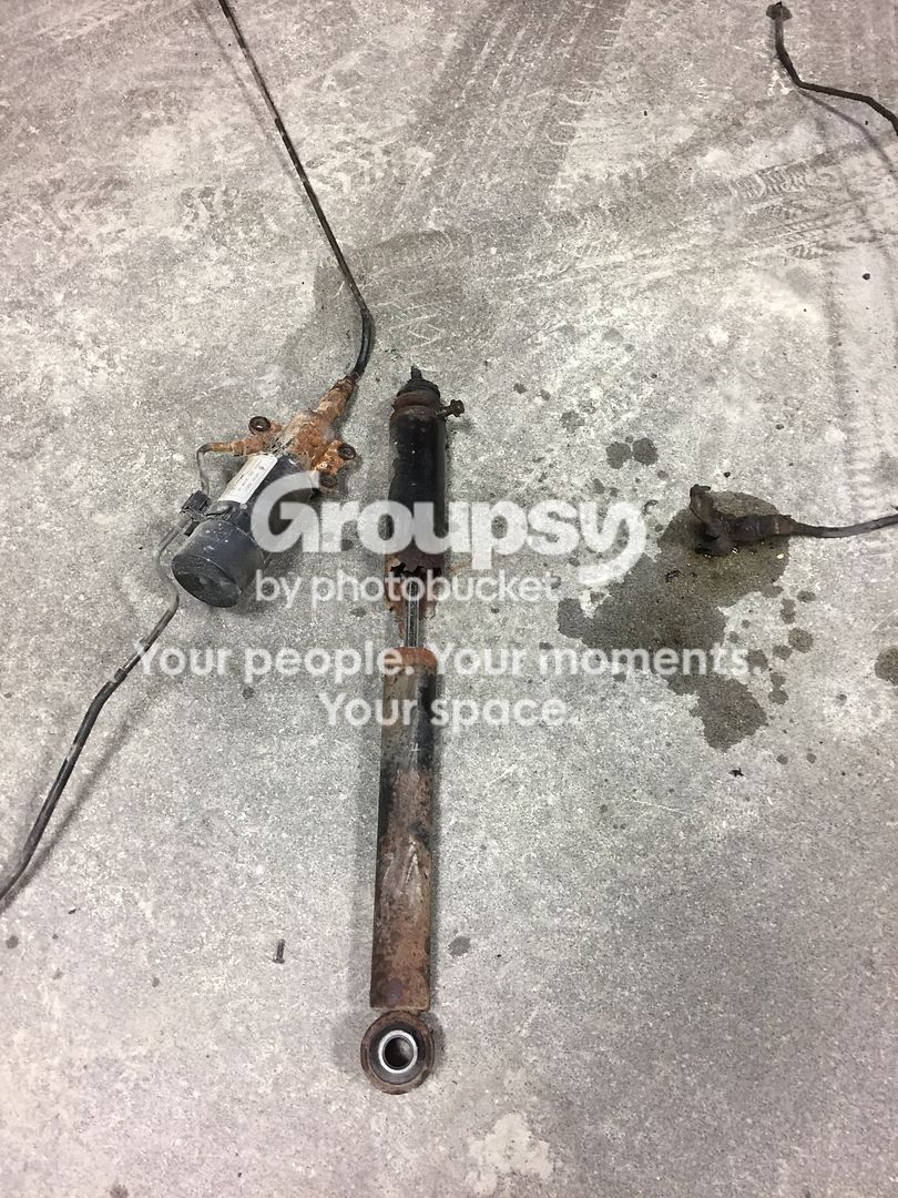

I've got an 06 Sport Just pulled out my X-REAS system at 227k miles.
I noticed the bad tire wear beginning on the inside from tires. It was still fine at 200k. When I replaced the tires with Cooper Discoverer A/T3's. (Love them! and no more noise than the Cooper Discoverer LSX Plus that just came off.)
Any way I thought I would chime in. Turns out all 4 shocks were leaking the front more so. I still have all the lines & bolts and such. Not bent up at all if someone wants them. I'll toss them in a few weeks if not.
Thanks for all the help from everyon here on the T4R forum!

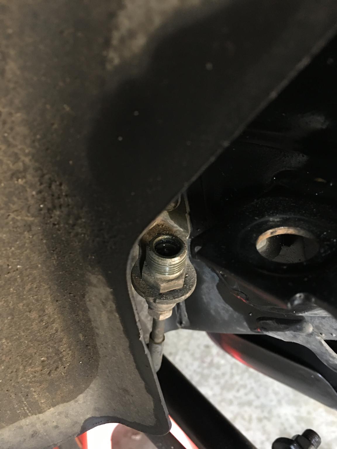

Where did you disconnect the fluid lines from? I've been sitting with 5100's in my garage for a few weeks dreading this install. I don't want to get hurt by the pressure or have hyd fluid all over my garage.
I just removed my XREAS and it was not all that difficult.
Get all 4 wheels off the ground. I started at the rear support bracket that sits behind the wheel, there's a junction point there , undo the 12mm bottom-most nut slowly and let it leak into drain pan. For the corresponding front wheel undo the union bolt at the support bracket (not at the shock). Cover bolt with rags while loosening slowly and let it drain gradually.
Then just follow the lines and undo everything along the way. I cut sections of the hard lines after to make removal easier.
No violent spraying, maybe there's a better way but this way worked well for me.
Removed at 295,000 KM, there were no leaks yet but the system was tired, shocks were pretty worn and springs had noticeable sag. Didn't corner well and didn't track well at highway speeds. Rear shock sleeves were rusted and falling apart similar to the pic posted earlier.
IMG_9994_zpsbtwduij3.jpg~original
Removing the shocks was a whole other story, seized nuts had to be torched to get them to budge, with assistance of some foul language LOL
My rear sway bar end link nuts were completely seized as well, to get my rear springs removed I undid the sway bar mounts on the rear axle.
Moral of the story, don't wait too long to remove XREAS components if you're in the salt belt.

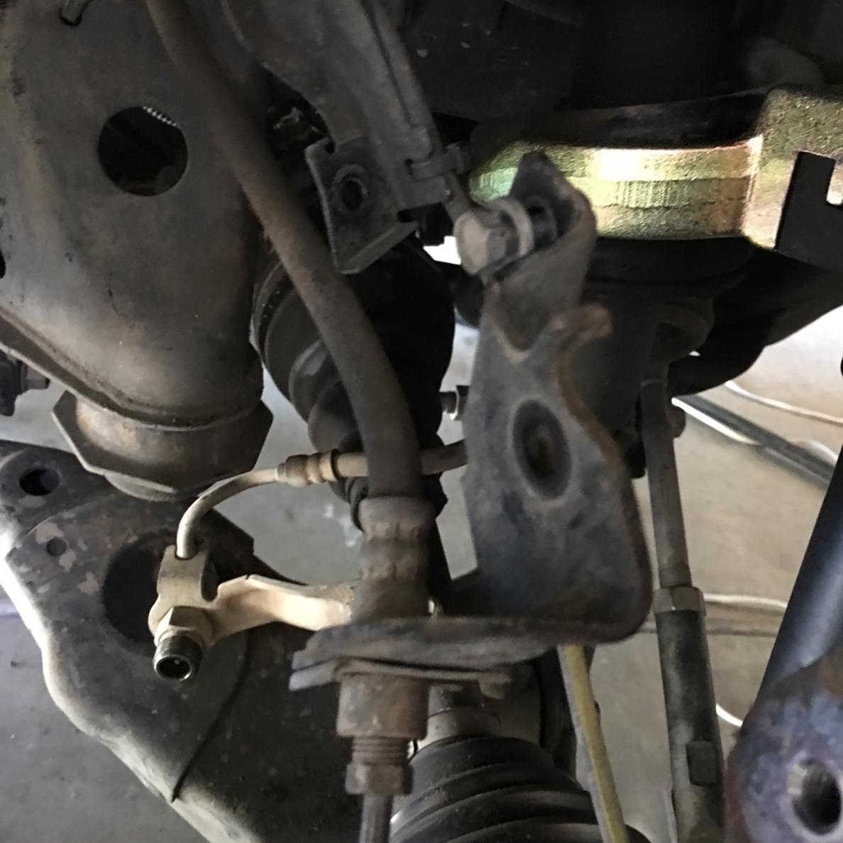

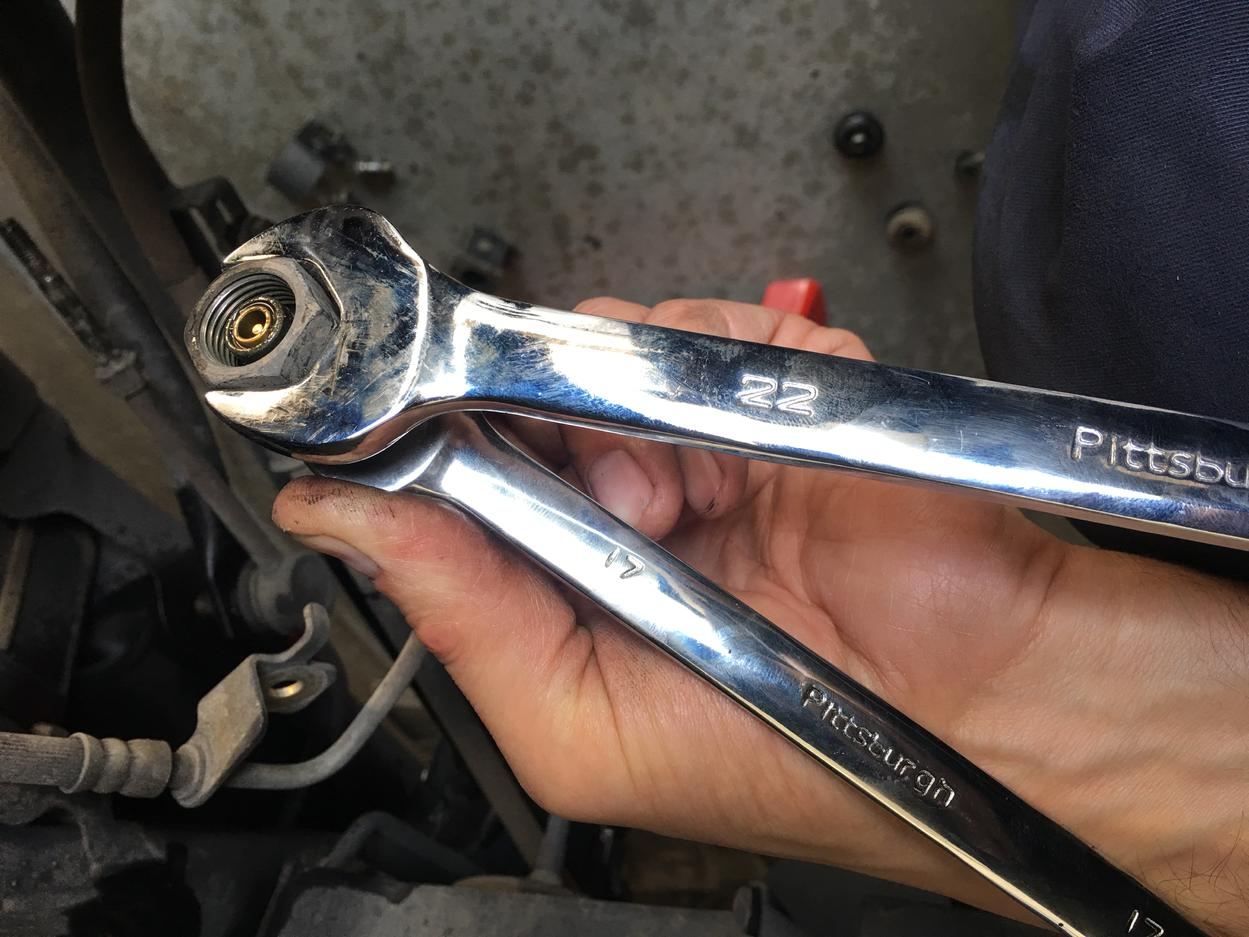

The rear is just inside the fender well at the lower forward facing corner of each rear fender well between the body and the frame. You'll need a 17MM and 21MM wrench for the lines and a 12mm to unbolt the brackets.
Then there is the hydraulic device on the outside of the frame rails each side looks sort of like a starter motor.
Front. I think... at the rear lower corner of the wheel well between the body and the frame rail. I think the front lines required a 21MM & 22MM wrenches but perhaps I have that wrong. find the back connection and you'll see what it looks like. then follow the front shock and you'll find the connection.
Barely a drop of fluid is lost when you crack these lines as each end of the connection has a Schrader type valve to hold the pressure.
you won't have to cut any lines or even bend them if you have your truck about 1ft. off the ground. Rotate the line under the truck and pull it out of the front wheel well towards the front bumper.
