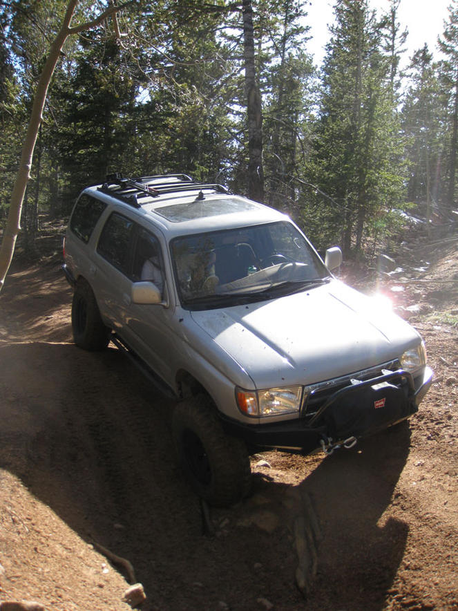

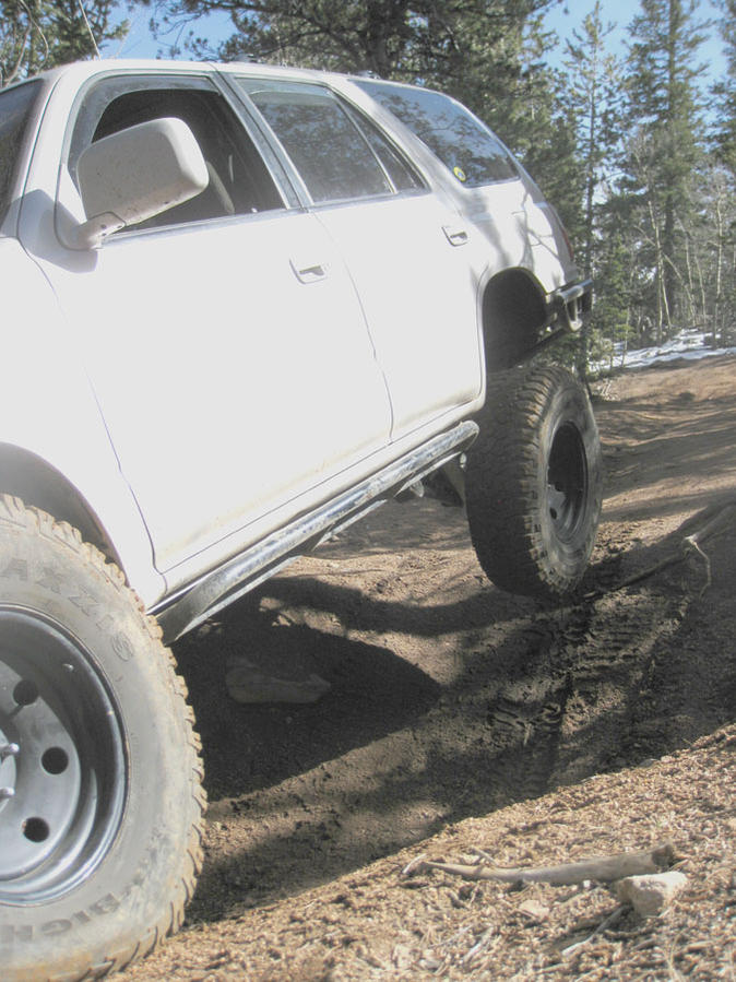

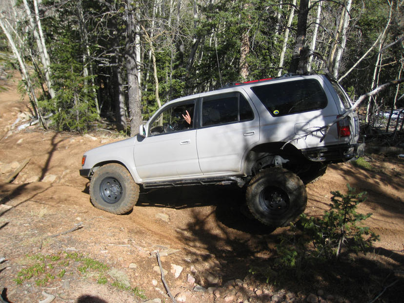

Well it is funny that I was the last person to post in here. Chalk me up for the first of 2012. Was at Eagle Rock trying all the hard lines. Should have tried to work it a little more... dang supercharger. lol
The rotten granite will getcha, but it and Suran Wrap are good challenging trails for a 4runner I would say. And thank goodness for my winch, had to do it about 6 times to get outta there. Also blew one of my tires on the side wall. so I should be getting at least one new tire! The silver lining in the clouds.:cheers:
