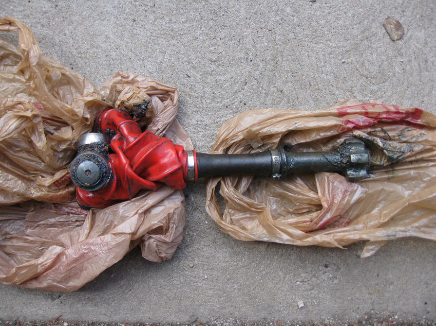

Does anybody know what this is? Just seemed to fall out.
Chock me up for my first.... yeah, I thought I was gonna be 'that' 40 yr old virgin...phew.
What sucks is that I had just replaced my inner boots the week before with Slee Offroad inner boots that are techcnicly made for tacomas, not 4runners... but they will sell them to you without a disclaimer of this, plus no instructions included. Not that you really need them, but it would have been nice to know that I had to use part of my old stock inner boot.
Any body have suggesting for what the best boots are to use?

Taco and 4runner cv's are the same. It looks like you broke a cv, I don't understand what you are really asking. Maybe someone else does.

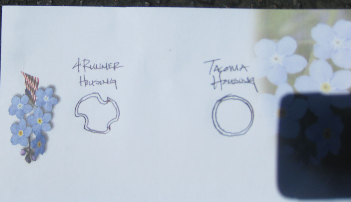

The CVs may be the same but the housing is different between the two.
Here is a crummy drawing show a cross-section of the difference between the two.

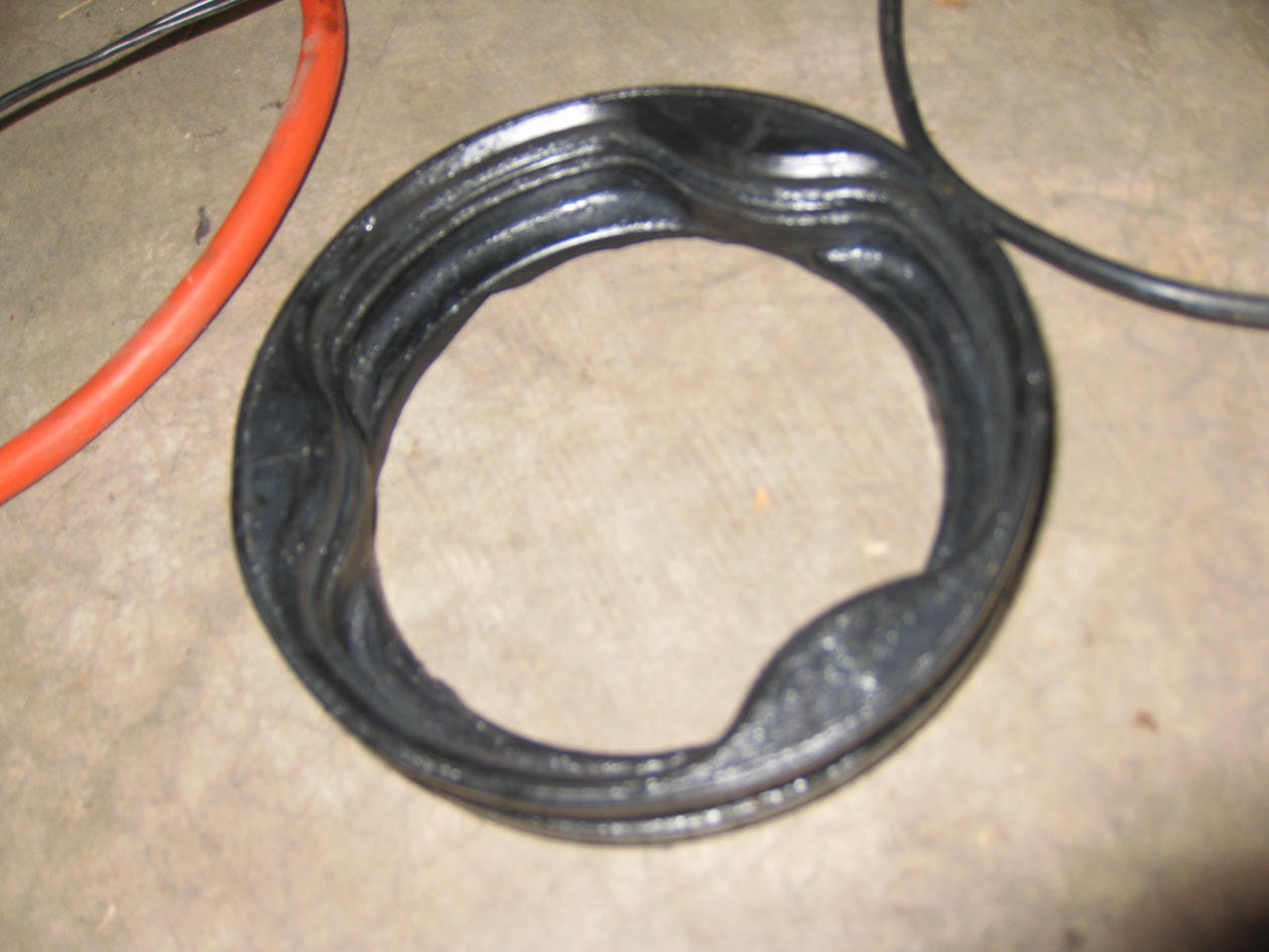

I also provided a pic that show the rubber 'flanges' on the inner CV boot of a 4runner that prevents 'CV juice' leakage, the inner boot that Slee offroad sells doesnt have these 'flanges', it is just a complete circle.
I called Slee and was rather upset about this fact, and they are not providing this info to the consumer. The guy I talked with really didnt seem to care about my frustrations... he said they cut out the top rubber part of the stock boot(as pictured below) when they install in their shop, and just carry their $50$ boot over it and then clamp.
This didnt make any sense to me since it would make the assembly, metal(CV housing) on old used rubber(image posted), on rubber($50$ Slee boot), then tied off with clamp ring.
Rubber on rubber just doesnt seem right, and trying to keep the Slee boot from wanting to slide off the old cut out is damn near impossible!

I have seen both, and have used both in my 4runner. Actually i have one of each style installed right now. when you get replacements sometimes you get one with the curvy inner and sometimes you get the round inner. Plus that rubber does hold it on there while out of the truck, but you should not be able to slide it apart while in the truck. Its kind of like the slip yolk on a driveshaft. you can pull it apart while its off the truck, but shouldnt come apart while on it. See this mi my issue with re-booting cv joints. You could have got a remanufactured cv joint for the cost of those boots
That rubber boot is nothing more than a dust/water cover IT IS NOT SUPPOSED TO HOLD IT TOGETHER. if you broke an outer you can sometimes have the shaft slip out of the inner.

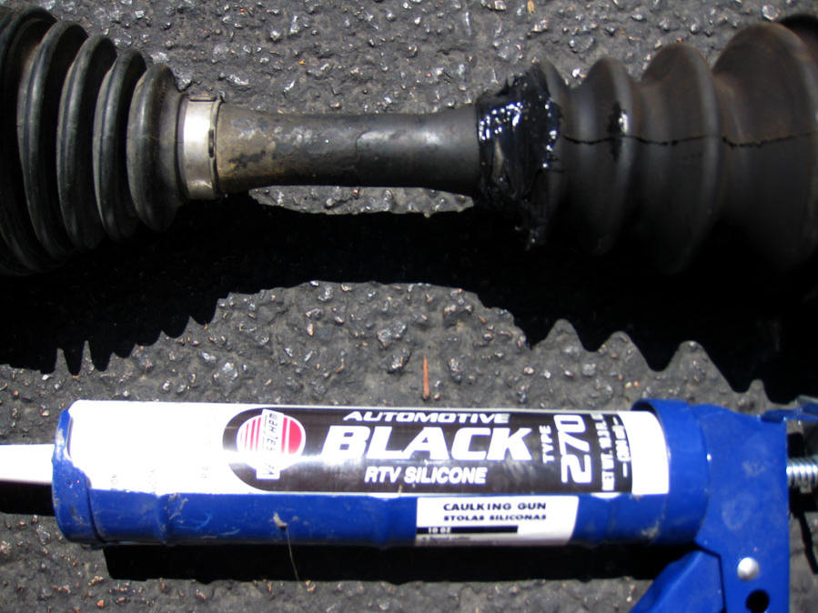

Yeah, I just picked up an OEM one from my secret yard. $50. Only thing is, is that the inner boot on this one is gonna tear in the same place my old OEM boot did from its age... but I have some ideas!!! (wink, wink).
I am just butt hurt that I just bought a $50 boot only to have it eaten a week later.:repuke:
This replacement axle was from a 96' runner.
I was just wondering if anybody has ever added KY gel to the inner boots on these older axles?
I didnt have any KY around so I used some A&D ointment and buttered the inner boot hoping to give the deteriorated and aged boot more life... anybody think it might help? It helps with diaper rashes and healing a fresh tattoo, why not a 1996 CV boot!:girl::banana::girl::banana::girl::banana::wow::wow::wow::wow:
