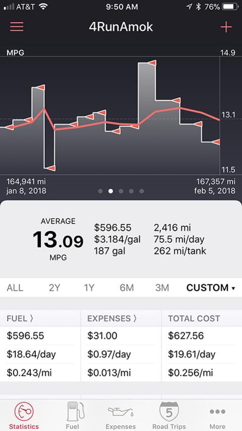

Put down the paper and pencil, there's an app for that and it's called Roadtrip. tracks everything you mentioned and more, and supports multiple cars.
