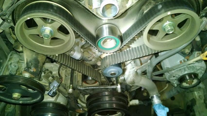

I'm at $696.01, which included tax and shipping. Toyota quoted me 1800 just for the TB/WP/T-stat. These were all Original Toyota Parts:
Timing Belt
Crankshaft Pulley Bolt
Idler Roller
Tensioner Roller
Water-Pump (w/gasket)
Thermostat
Thermostat Gasket
AC Compressor Belt
Alternator Belt
Power Steering Belt
Radiator Hose Upper
Radiator Hose Lower
Toyota Red Coolant
Dipstick Tube O-ring
Radiator
Crankshaft Oil Seal
Transmission Fluid
These were all Preventative Maintenance replacements, including the Radiator (which was fine). The car had 185k miles AND on the original TB, FWIW.
I did not do the VC since I knew I was going to put in an SC eventually.
EDIT: Took about 2 hours in total, one of the most straightforward projects I had ever done. I guess it's small consolation for the "gotchas" I've had to deal with on EVERYTHING else car related!!
