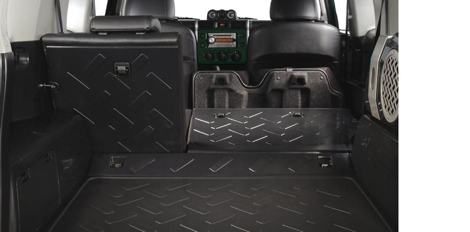

I would like to convert the flooring and trunk of my 4runner just like the FJ's.
Does anyone have any information on how to do it or get it made?
Please see picture attached.
Thank you

This would be cool to have in our 4Runners. We could probably remove our carpets and just get some Herculiner or something similar and that might do the trick. It just wouldn't be removable without a lot of blood, sweat and tears.
I am willing to experiment. I just need to know where to get the material.

I'd say any 1/8 rubber is going to suffice, easily trimmed, flexible.
I think the biggest fly in the ointment will be cleaning off the old glue, and contact cementing down the new.

Well, I want to start with the trunk since I have liners on the floor. So the trunk is basically what I want to convert to rubber. I guess I will try to pull some carpet this weekend and see how it goes.
The carpet is just sitting in there and not glued down.Kind of just tucks under the plastic . I don't see a problem putting rubber down back. There is a rib going across on the floor that you need to put a piece of plywood down first to make it level.

I don't know how big of a project you'd like to take on, but consider this. Rubber matting would be the easiest thing to find, but you could get some larger sheets of diamond plate-style matting (non-rubber) from a company like Wearwell Industrial matting.
I'm not saying this the best alternative, but here is an option ... Mats | Mat | Matting | Anti-fatigue Mats | Antifatigue Mats |Anti-fatigue Matting | Antifatigue Matting | Ergonomic Flooring | Runner Matting | Ergonomic Mats | Ergonomic Matting
It is made from a flexible PVC and will accept adhesives, but you will not be able to plasti-weld it. Other materials can be welded to custom fit corners, etc.
Also, consider removable Christmas tree pins/clips for the project. Screw-Type Tufloks
