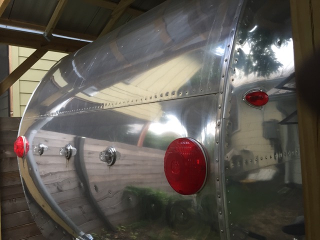

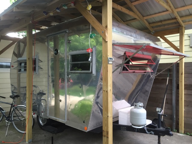

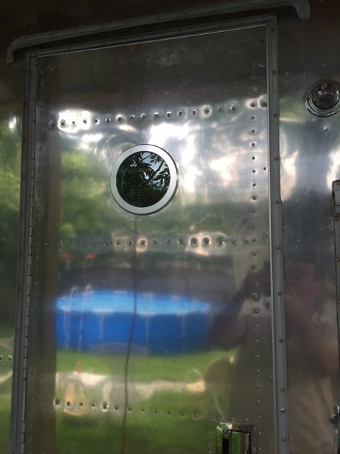

Check out my rig... been build it from SCRATCH... not a refurb. Buck rivets. Aircraft aluminum... all new except for some donor windows....
Nice work!

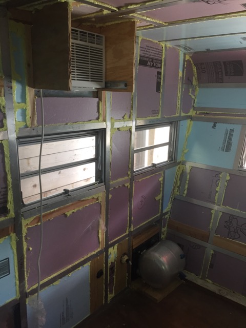

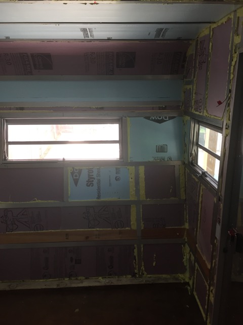

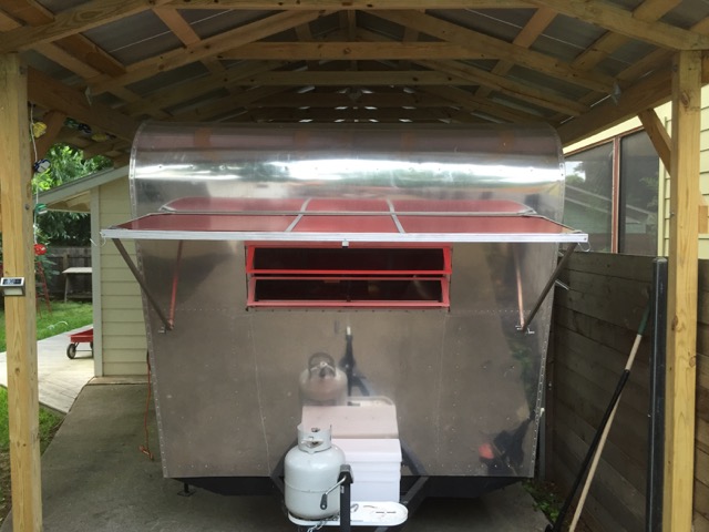

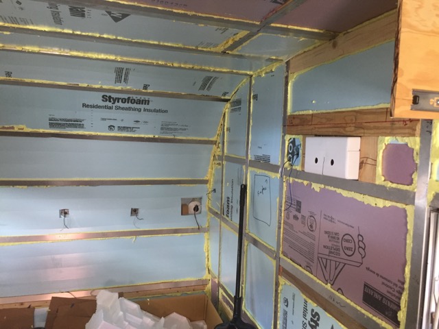

with 400w of solar, you wont need any charging from the truck.
unless you have some massive loads in the trailer. AC? or a furnace as mentioned above.
I run 200w, and able to run my 3 way fridge on 12v during the day, without dropping the batteries down. I switch to propane at night however. I do not have nearly the battery capacity that you do. with your described set up, the solar should produce much more than you will need.
How much does it weigh? Do you have pictures of the interior?
Thanks! Errrrr.... on year two right now. Just got through insulating it. So not much to look at just yet, Unless you are into styrofoam and great stuff... I'm guessing all in it will be Maaaaybe 1800lbs
at the most.

Well his pictures do show a household A/C unit. But outside of that, I just did a Westfalia with 3x100W panels in series, they produce as much as 60 Volts on a a warm sunny day. The key here is we are using a MPPT charge controller(capable of handling 400W, and 40A charging, you can't run the array in series with a PWM controller. The tests I did were just to bring the battery down and I easily got 14-16 amps out of the charge controller. I used an AGM 89amp hour battery(20HR rate), designed for solar use.
The owner runs the 12V fridge easily recharging with average daytime sun. He has minimal lighting, and an electric water pump too, but no other real loads. By the way MPPT is 15-20% more efficient than PWM. As of now he has no way of charging his aux battery other than solar. He does want me to install a charge relay, but he is going to have me do a Subaru conversion, so we'll address that when we do that.
ah yes, I see that. im thinking maybe that is just there during the build process? it looks as though the cord goes through the wall to the outside.

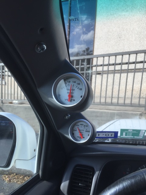

Lately I've been working on the wiring of the truck ... eg the towing setup. And I Just put in the B and M tranny cooler and some gauges. Sweet.

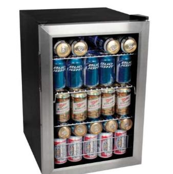

Well, the problem is.... I can't find a sexy DC mini Fridge. And my trailer is going to be to the tits :girl: on the inside when it's done. I mean... look at this glass and stainless loveyness...
EdgeStar 84 Can Extreme Cool Beverage Cooler - BWC90SS
I've already got a mod to make it colder than a bevvy cooler too.

Wow, that refrigerator is going to kill your battery...Fast!
At best it will draw 13.75 Amps. With no charging this will kill a 100 amp/hour battery in less than 3 hours.
The good news is 90% of the time you will be plugged in. The bad news, 10% of the time your battery will be dead. :whistle:
Wow, that refrigerator is going to kill your battery...Fast! :whistle:
Ahhhh crap! I figured. Well, since for this project I care about looks over function in some places... I'm going to go with plan A. Which was... just run the fridge on AC. When boondocking... which will really be like a week at the most... a yeti, some dry ice, and a Sh.t ton of scotch.
See... problem solved.
