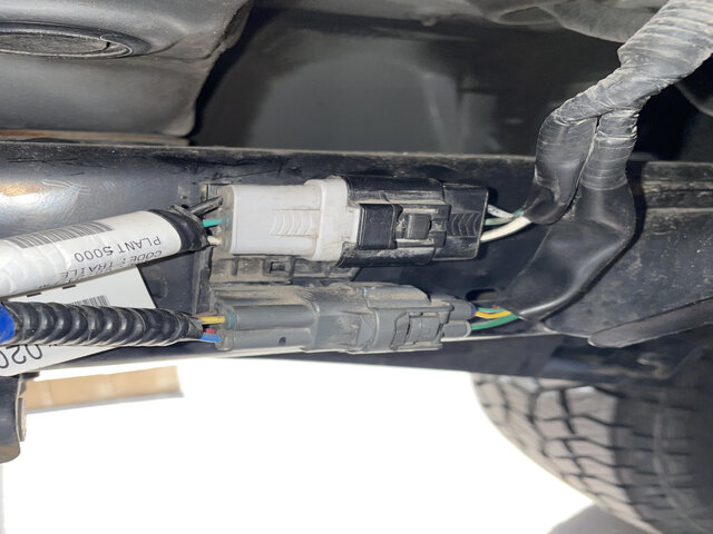

Need a bit of help. I've exhausted the search function which comes up with plenty of how to's in extending the factory harness.
My question is how to detach or unclip the 2 OEM connectors which go to the OEM 7 pin connector? Before I get mad and get start yanking I am going to take a break and ask the experts. Pic attached on the 2 connectors and connector mount. Thanks!!
-Depress the tab on the right hand side connectors for both.
-Might help to push the connector IN to help lessen the tension and then pull back.
-Repeat for the other
-If you're trying to undo the left side connectors from the mount, there should be a tab securing it into the plastic base which usually requires a small flathead or small point awl to release the tab securing them in.
Good luck!
Thanks! I found a how to on eTrailer. Basically one you have to pry up and the other is a tab. I have done a ton of mods over the years but disconnecting these two had me cursing.
